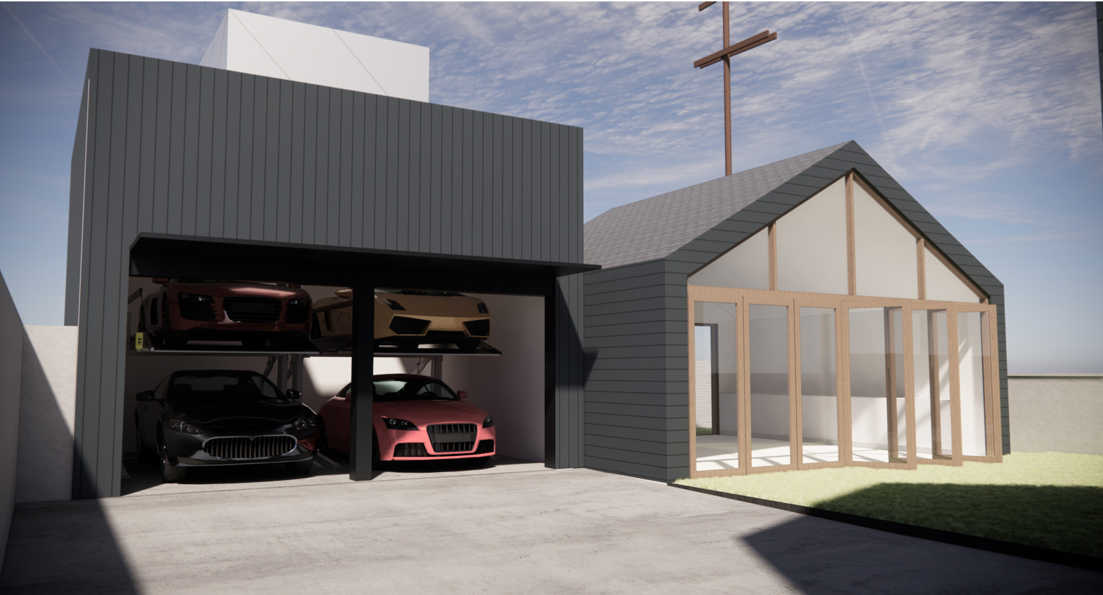

Thanks so much @rsporsche-- already super helpful. I'm attaching a very early rendering here, and I believe we're looking at the "dog house" pop up you're referencing. I've also requested it be build to accommodate stackers since I am limited to the size that can be built.
It is attached to an ADU, which will be in the back of the property. I will obviously get into materials with the architect, but he is not a "car guy", wanted to make sure I could defer to my community here. I know you guys are all thinking of the same things as me, which may be different than his non-automotive professional MO.

Well, there are several elements of that design that strike me, and not in a good way. First, the lift mechanisms appear to take up a lot of space toward the rear of the garage. If I am looking at this correctly, a pair of four post lifts would take up less floor space.
You do not appear to have enough room for even a small workbench. Even if you do only rudementary mechanical work, a bench is essential.
There appears to be no storage. Again, even if you only clean and maintain the appearance of your vehicles, you need space for a vacuum and buffer and cleaners and waxes and whatnot. And rarely do we have the garage entirely to our cars. You have no room for bicycles or yard tools or gardening stuff or whatever.
Then there is the issue of width. The narrow footprint doesn't seem to allow for a door to open into the garage, or if it did, it would be very close to the parked cars. And, if you wanted to wax a car in that space, there does not appear to be enough room between the vehicles to do so. This is not only an issue for your use of the garage, but resale will be better if the garage width is big enough to allow two of today's SUVs to be parked in the garage. I made sure I could park a pair of Ford F150s, and get in and out of them, in the garage I build in Virginia for just this reason. For this same reason, I would not put a post in the middle of a two car opening in the garage entry.
This seems to have been designed as a cube, putting much of the enclosed space up in the air. As to the original question, I would think rows of windows near the upper portion of each external wall would allow in more light than a skylight.
Overall, I think more length and width, at the expense of height, would provide a much more usable space.

Thanks so much for the replies and insight, all! I definitely will not be replacing a front end or doing anything too crazy, but certainly interested in being able to have a workbench, store detailing items and parts, etc. This rendering is by no means to my specs in terms of lifts, etc-- I planned on going 4 post Bendpack most likely, and I am also considering only doing 1 lift in the garage. No doubt I will be fighting for space regardless, as our total buildable square footage will be a limitation...

My guess is most architects have a good sense of space since that's hard for most people to visualize. Since he's not a "car guy" he may not understand the space required in a man cave. Not having enough space when working on cars is extremely annoying most of the time. This is assuming you'll be working on cars or other projects in the garage.
