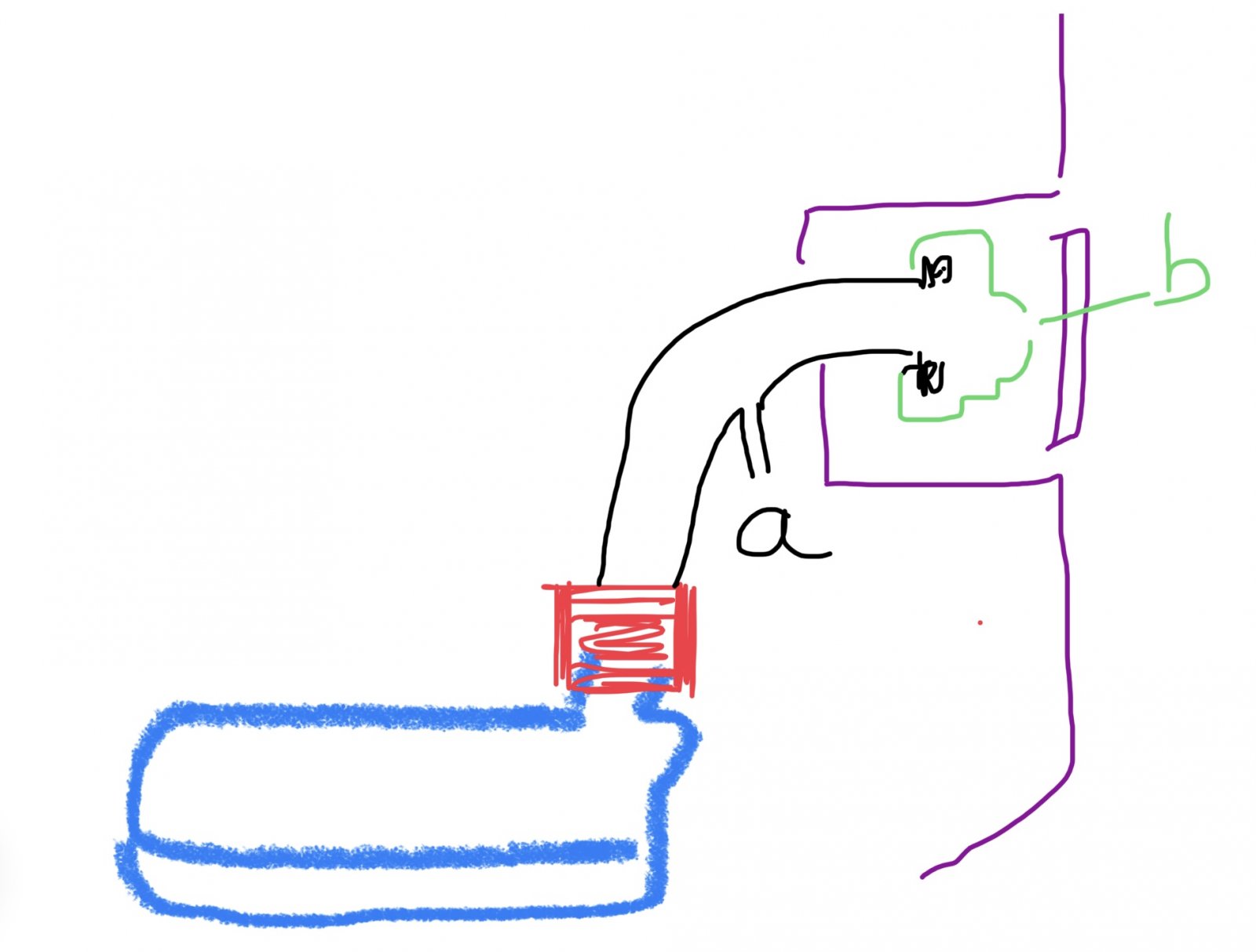

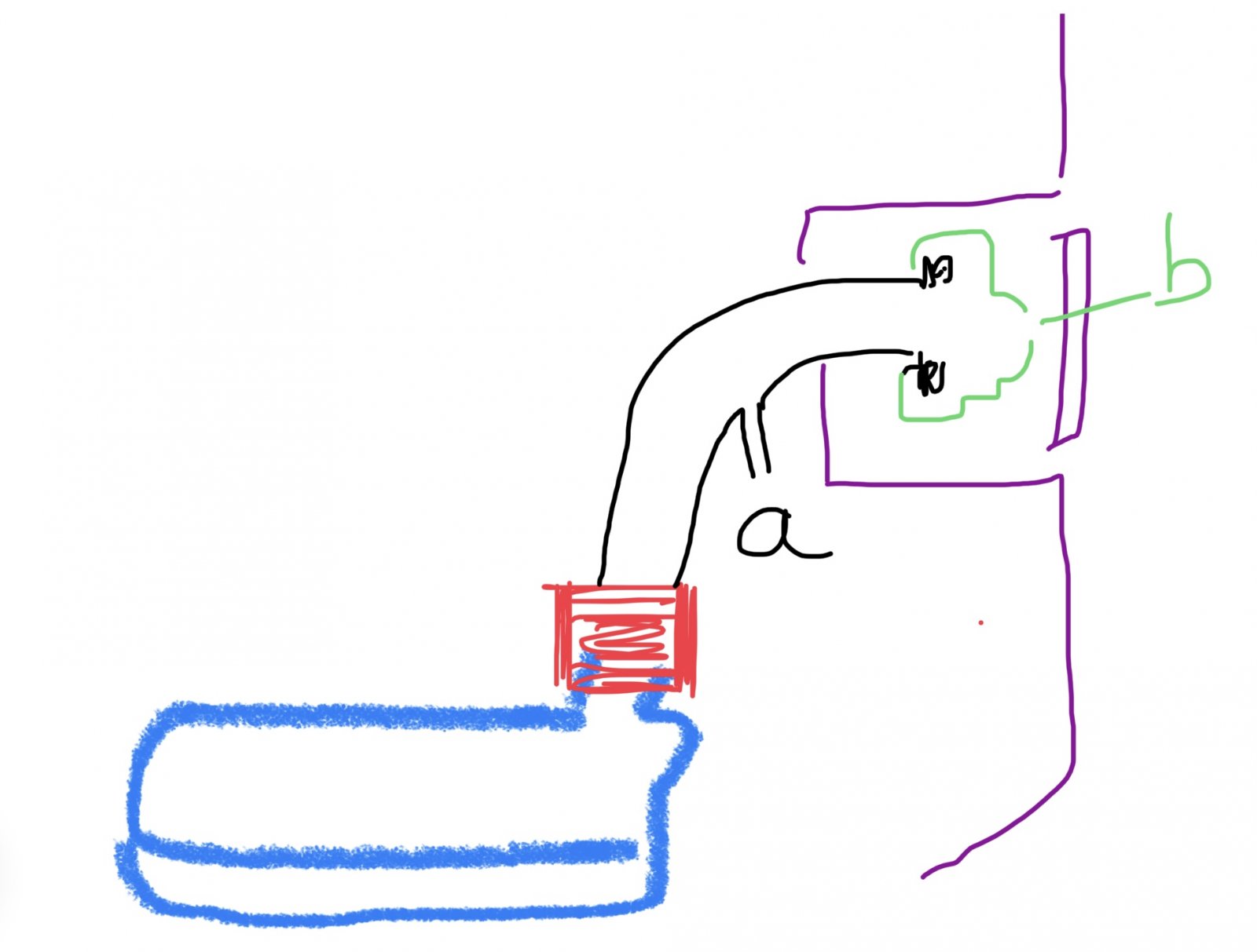

given the configuration, that has a venting hose “a” and venting hole “b”
doubt much that you can have fuel dribble out of vented cap
Earlier venting hose could do

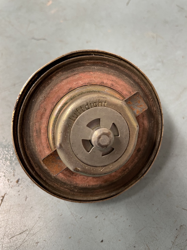

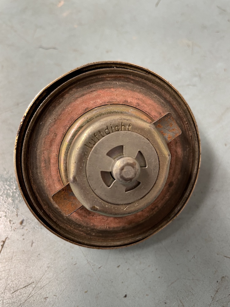

Luftdicht (airtight) is stamped on the inside of all original caps...

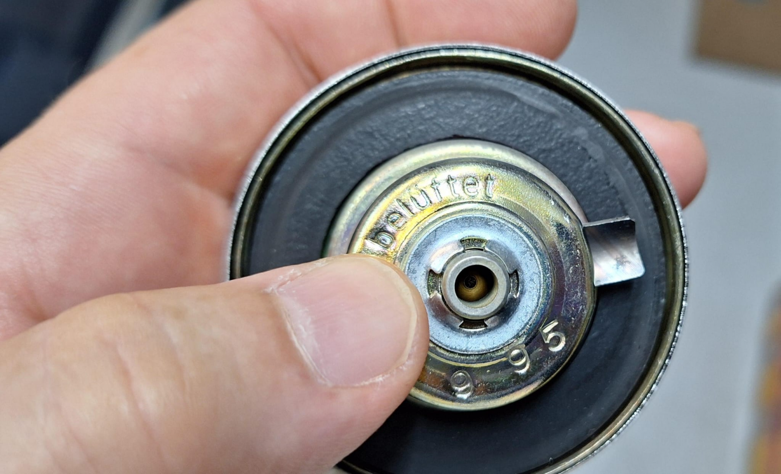

said that, ehem, ....all the E3s and E9s that i have seen in my life have the vented cap and say "mit lüftung"
...maybe they were original,...maybe not

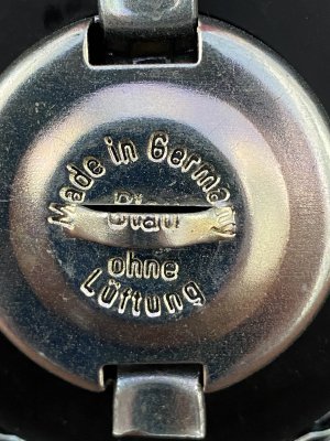

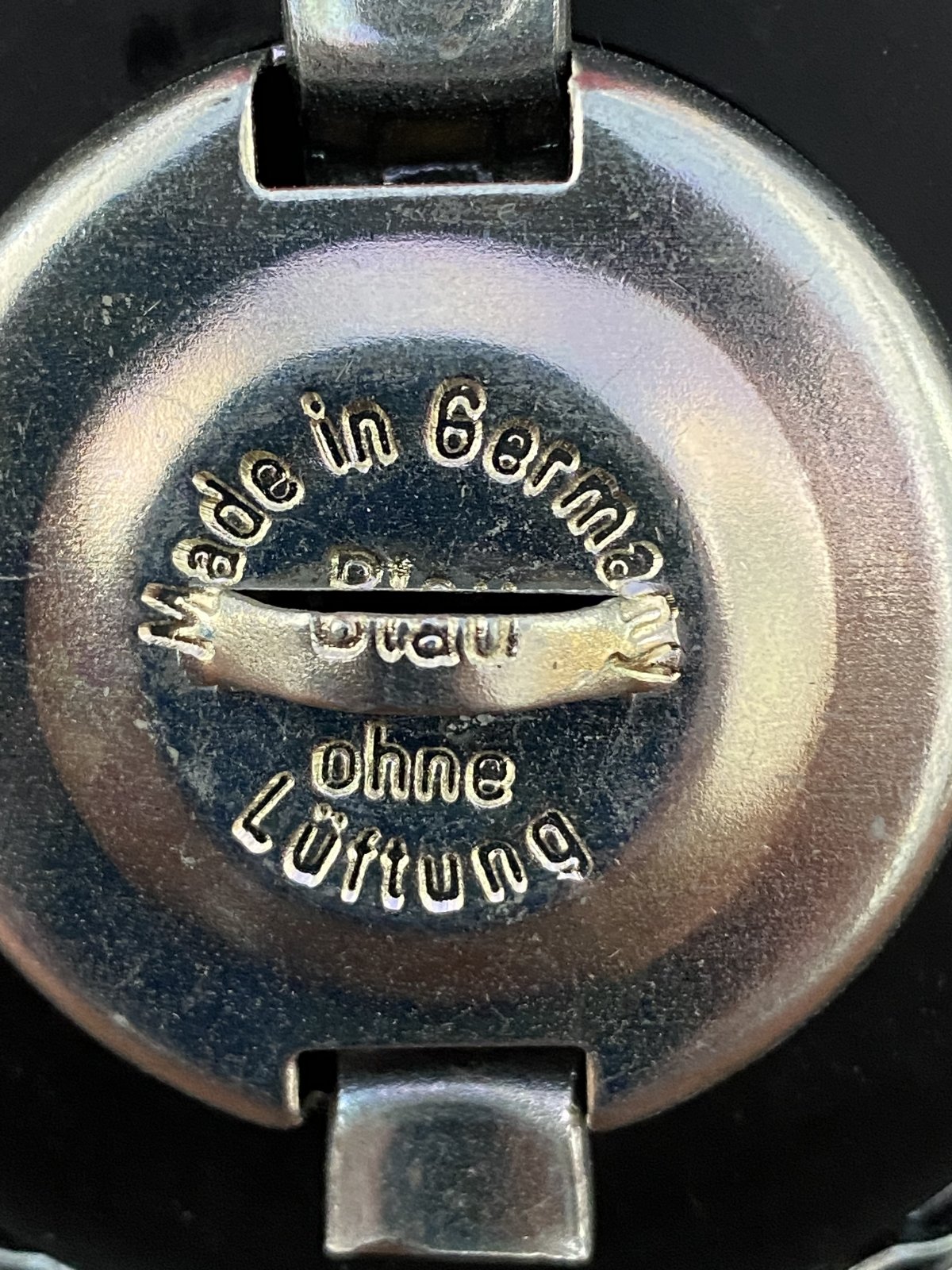

Hello,
alle european E9 must have a gas cap without venting (luftdicht, ohne Belüftung) because you would have gas fumes inside the trunk if the rubber booth behind the gas flap may not be airthight anymore (and you would use an not airtight gas cap). The venting of the E9 tank is done by a small tube running from the metal filler neck inside the car to a hole in the middle of the car/top of the trunk floor
European E3 must have a gas cap with venting (mit Belüftung) because the filler neck was not inside the trunk. The fuel tank was vented by the vented cap (mit Belüftung)

I'm sure my Euro E3 has a label next to the cap stating that a vented (yellow ?) cap must be fitted (from memory). I'll take a photo when I'm back home.
my e9, has a beluftet cap, no fuel fumes in the car, nothing, no, nicht

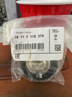

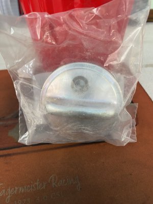

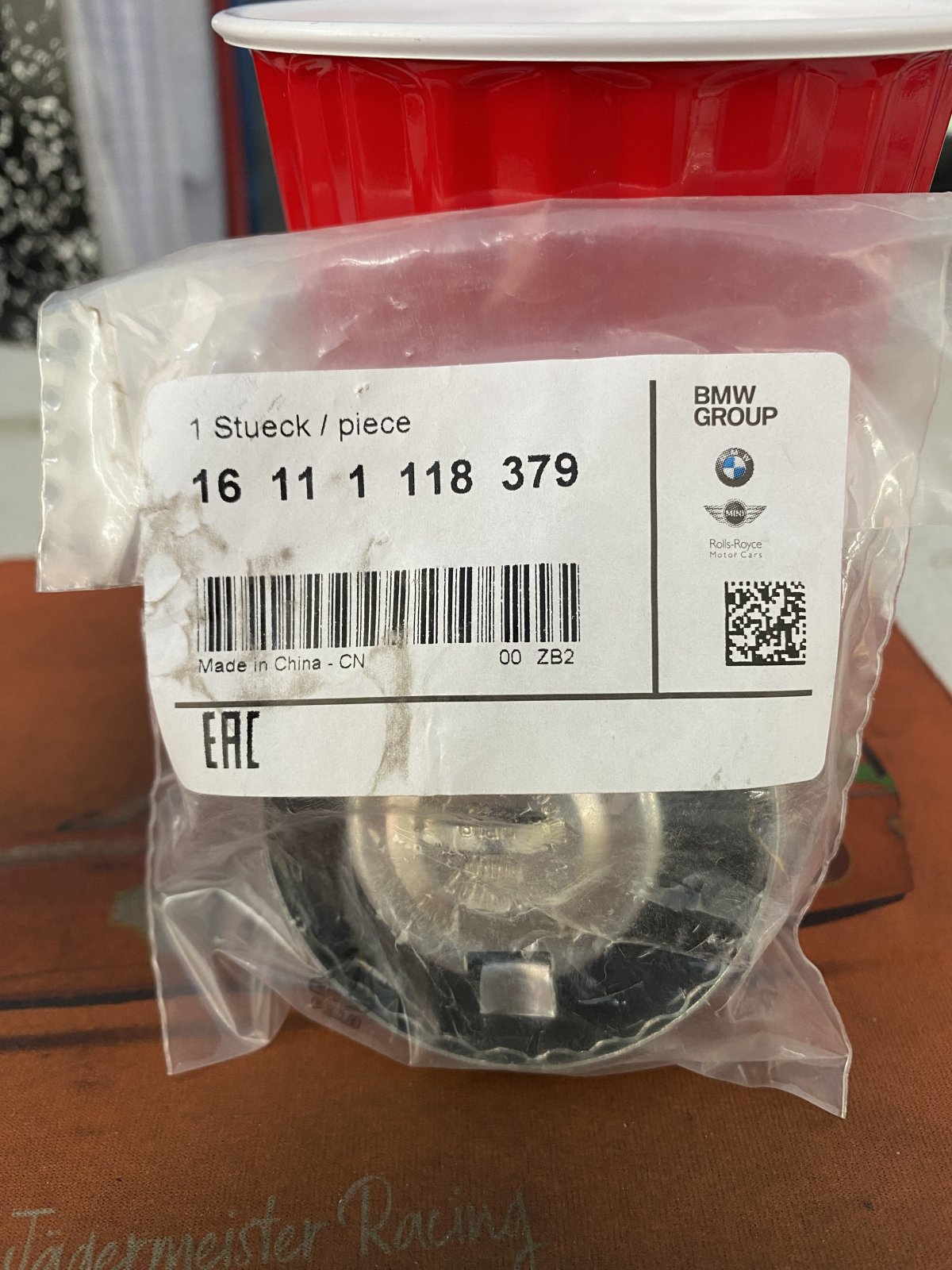

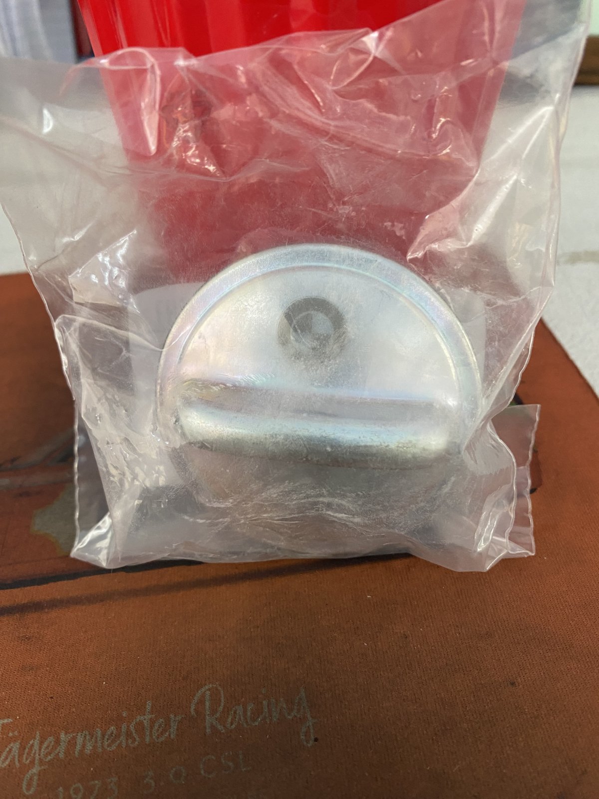

Walloth sells unvented OEM BMW for our e9.
But it’s not specifically for e9..
