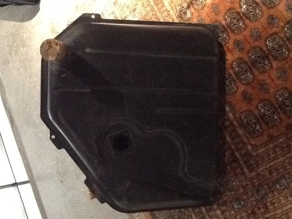

Sorry for reviving and old thread. I just found a NOS fuel tank belonging to a 2002, part number 16 11 1 111 567. In a way, I'm very lucky as my E9 is rusty and leaking from almost everywhere
Been reading, apparently this fits our E9?
Please do let me know if this is the case? Presumably that since it is a 51 liters tank, I will have to find the correct sender? With the correct sender, am I correct that the fuel gauge will display the correct reading?
Sorry lots of questions...
Luck has not been on my side for e9 parts, but found a number of 2002 and e3 parts
Attached picture of the tank
