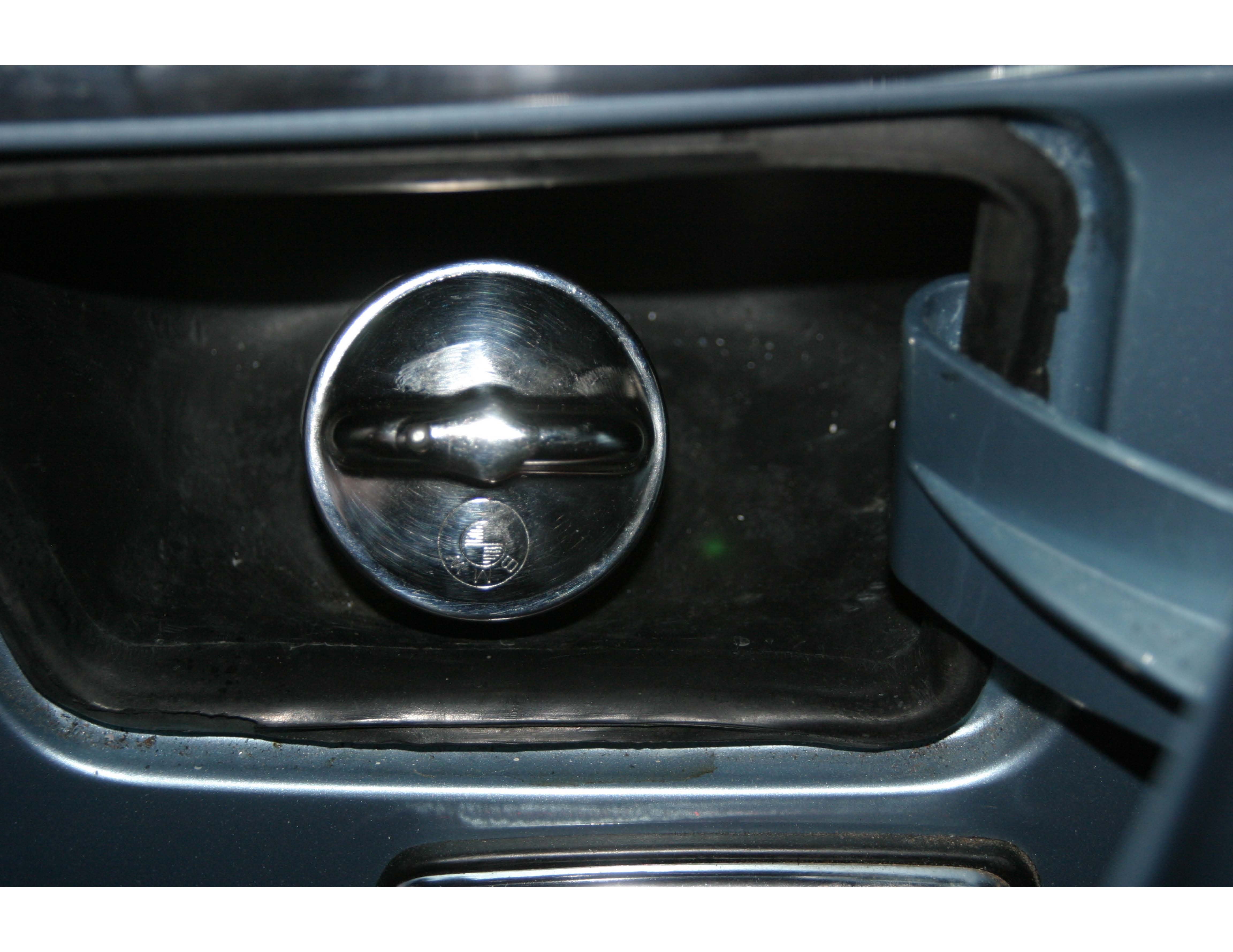

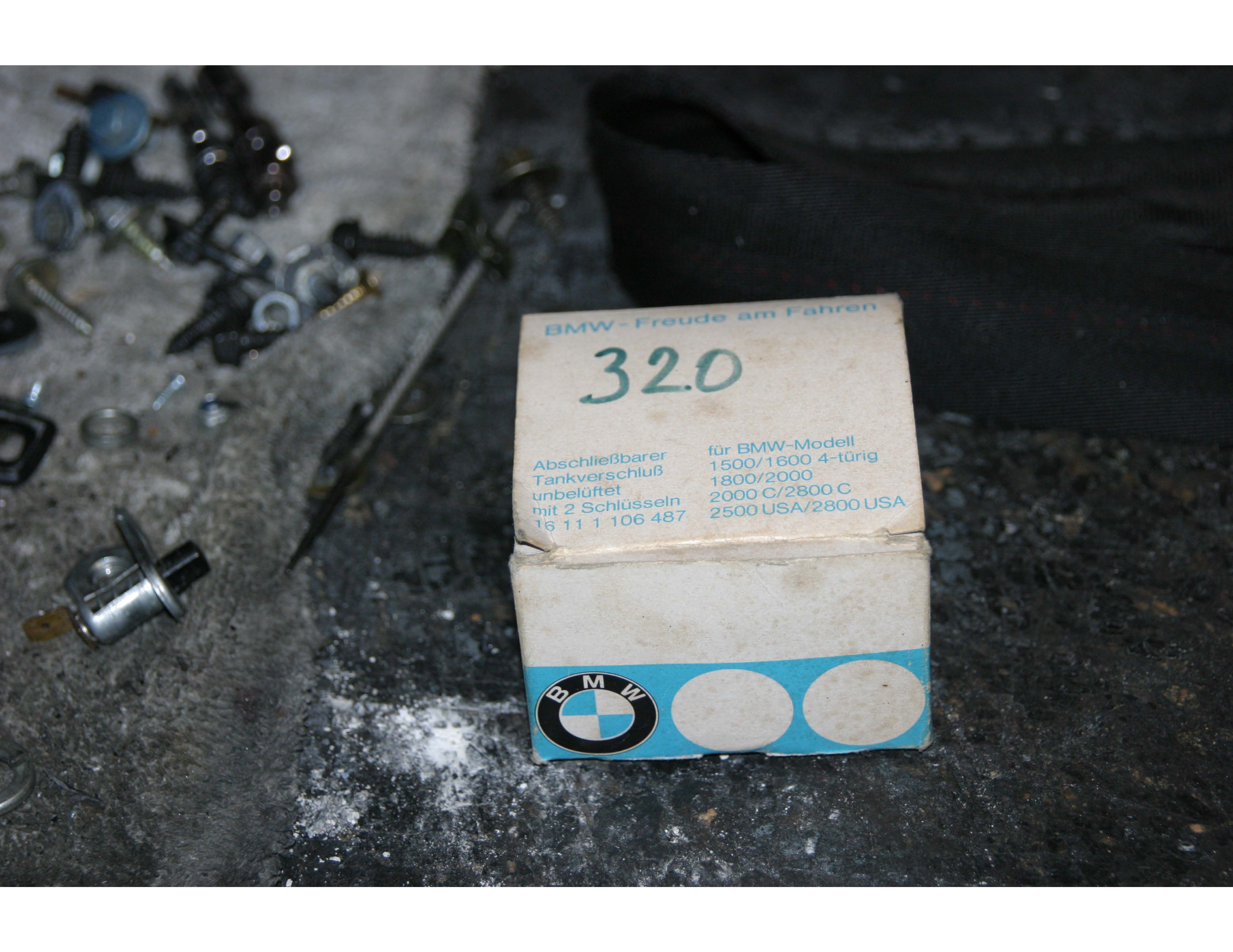

i was sooooo lucky to find a brand new in the box locking gas cap
im syked.
