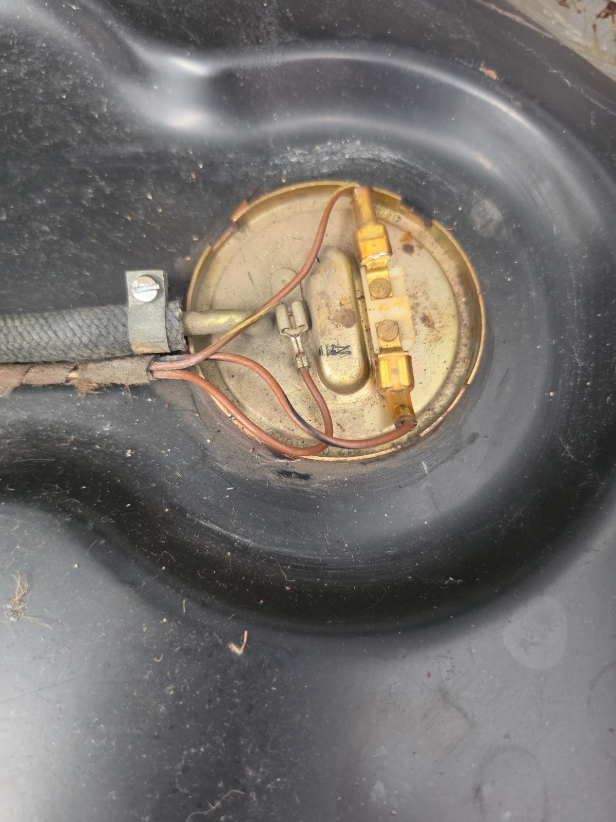

Can I assume that this twists out? Counter clockwise?

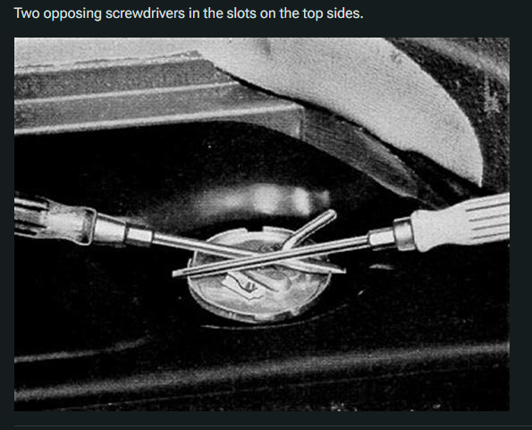

yes, try the 'crossed' screwdriver trick to get leverage on the sender unit - for both removal and assembly
if it doesn't work, putting the big screwdriver in the slot and hitting it with the BFH works (like Don said). you have 2 things holding it there - 1. corrosion + 2. flattened old rubber that has glued the 2 pieces together.
Just be careful if you hit a screwdriver with a BFH…sparks and fuel vapor don’t play well together, that’s why Don says use a brass punch! It works fine until it doesn’t.
