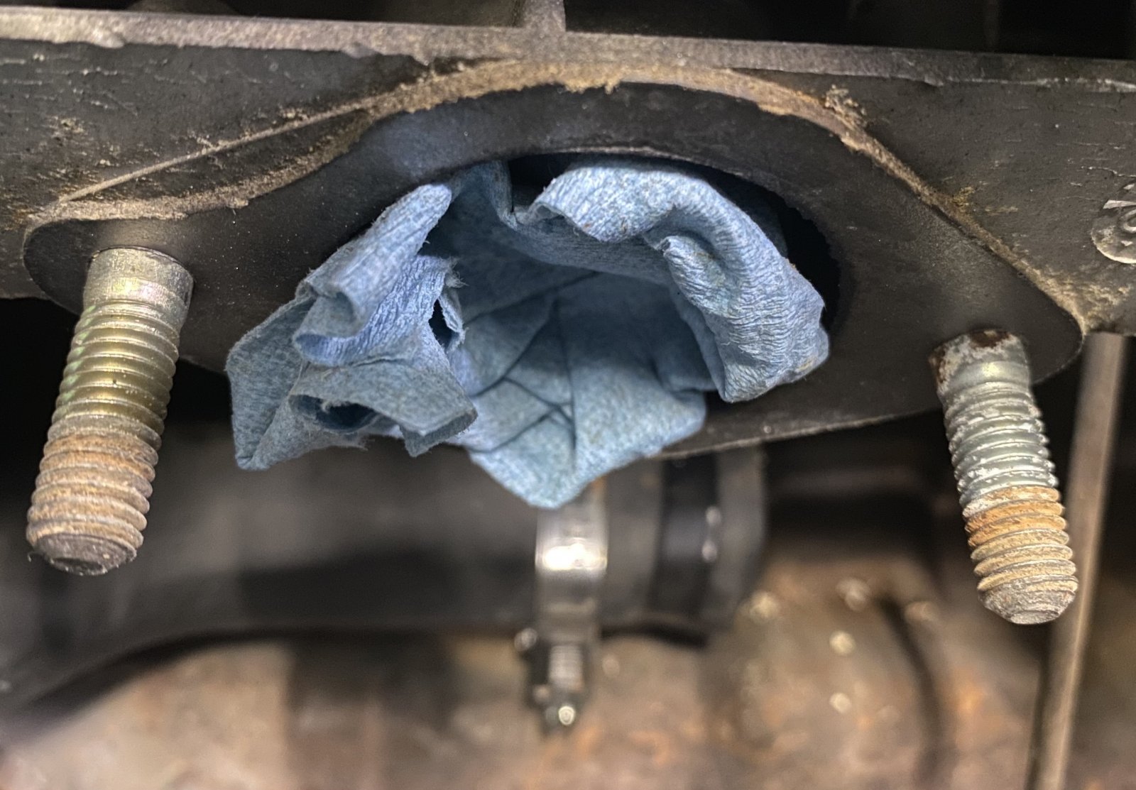

Upon removing my intake C-Pipes, about 1/3 of the old gaskets came off with the pipes. Those weren't too bad to deal with as I could physically hold them and soak-n-scrape (plastic scraper) the old gaskets off. However, I'm now having to deal with the gaskets stuck to the block and they are practically welded on.
I've read some recommendations outside of this forum, but does anyone have direct experience with removing gaskets off the block? Keep in mind that the engine is still in the car.

A fresh razor blade should make short work of it, apply minimal pressure and go at a shallow angle
I use an exacto knife with a flat blade on it. My preference is too use a tool I know will do the job, even it I have to be careful with it to avoid damage. In this case, the steel in the blade will actually cut into the aluminum of the head if you are impatient. As nosmonkey says, a shallow angle is preferable.
One other note, your picture shows a small bit of corrision around one of the studs. This will expand the stud making the gasket hold tighter around that area. This is a good place to start because sometimes you can get the release Chris mentioned when you get under these tight areas.
