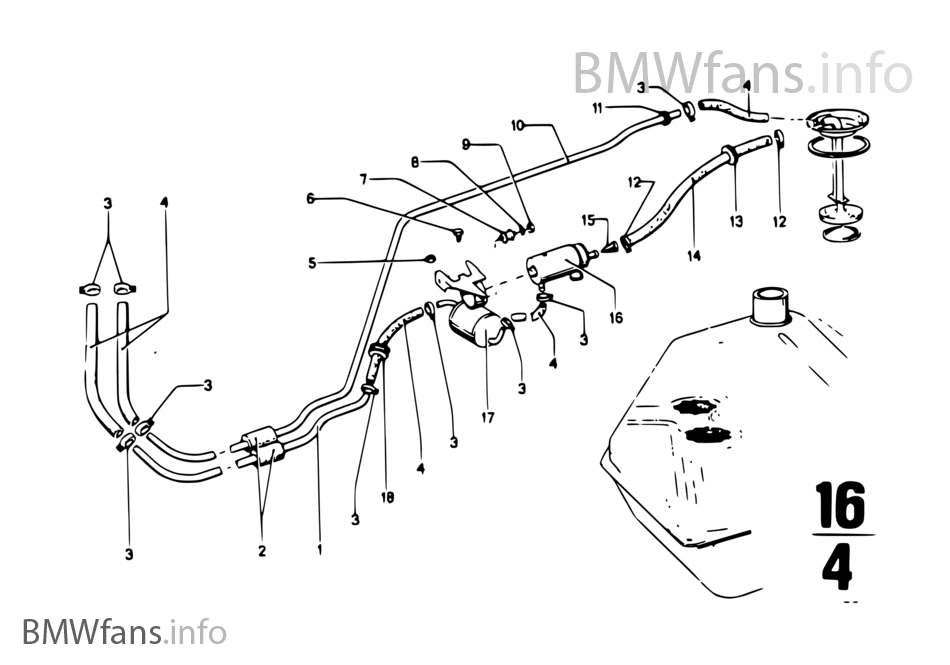

Crankcase vapors go from the valve cover directly to the air filter housing and are piped directly to the rear carb.
Gas tank vapors are routed to a plastic can over the right inner fender, then to the charcoal can under the battery and from there to the air filter housing, without valving as done on later cars. The sealing ring on the fuel tank sender, the connection between the braided line that goes forward, the line itself, the can over the fender, the charcoal can, are all guilty until proven otherwise.
A tiny bit of liquid gas can make a big smell. All fuel lines under the hood are guilty until proven otherwise, as are the tubular seals between the engine compartment and gutter forward of the windshield. There are penetrations between the two which might not be adequately sealed after all this time.
If you're running rich (and even if you're not) exhaust which finds its way into the trunk will get into the passenger cabin. Trunk seal is suspect.

It goes without saying that if the smell is significant I would examine the entire length of fuel line/hose running from the tank, to the pump and then to the engine. Pull up the trunk boards that cover the spare and the tank for a closer look. Fuel line runs from the top of the tank through the body to the underside of the chassis.
There are at least two grommets (16121107262) that isolate the hose from the body, protecting the hose, and to a lesser degree, sealing the trunk interior from the exterior. If the grommets are compromised or not in place, the occupants may unnecessarily find themselves exposed to errant exhaust and fuel vapors. Although a pinhole exhaust leak is easy to overlook when it is outside the cabin, it should not be ignored inside the cabin. Pinhole fuel leaks, or weeping fuel, should not be overlooked under an circumstances, for obvious reasons. That said, as unlikely as it may seem, a full-over full csi fuel tank can naturally vent toward and below the rear bumper; however, if the above grommets are not in place, the peculiarities of air flow may still result in the scent of "oe d benzine."
It is worth mentioning that the fuel tank filler port and gas cap are segregated from the trunk via a rubberized membrane that contains "blind plugs." If either of these things is compromised, missing or poorly fitted, it is likely that the driver and occupants will be genuinely labeled "petrolheads." :| http://www.e9coupe.com/forum/showthread.php?t=16375
http://www.realoem.com/bmw/showparts.do?model=3436&mospid=47811&btnr=41_1213&hg=41&fg=25
