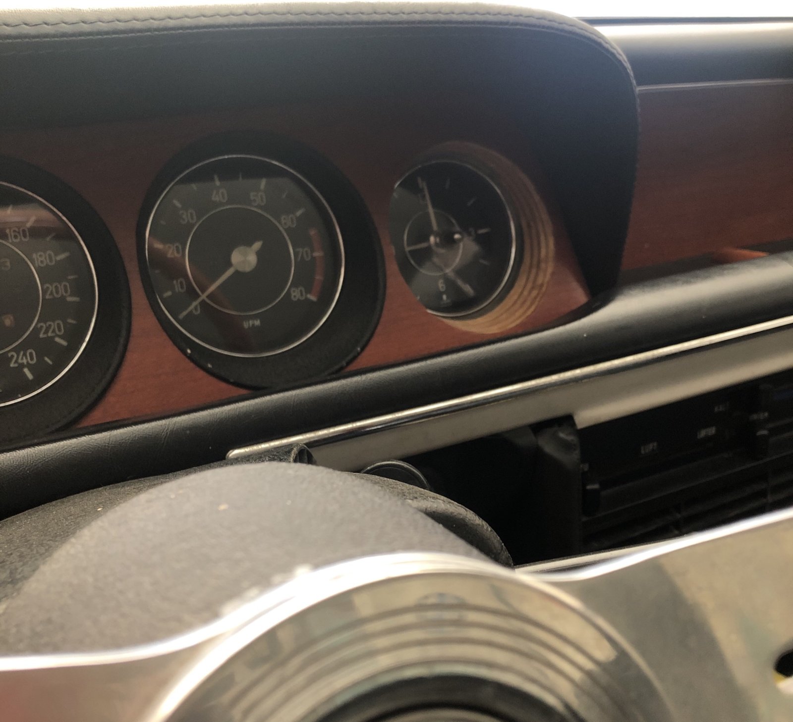

Not really sure what it is called but I’m in need of one.

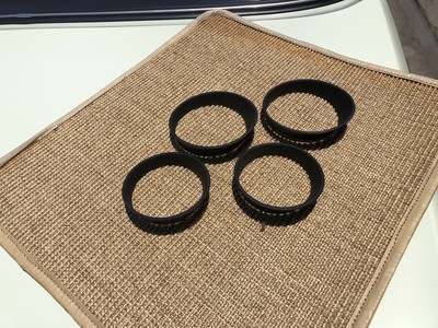

They are fairly common around the markets, there are obviously two sizes here so be sure to ask for the smaller one through different sites.
They were originally soldered in place which makes for a tricky install when you get one. If you're wanting to install as factory the cluster needs to come out.
the downside is, once you've bought one, to install it properly, you need to remove the entire gauge cluster. the trim rings are soldered to the metal panel on the back side of the wood panel.
