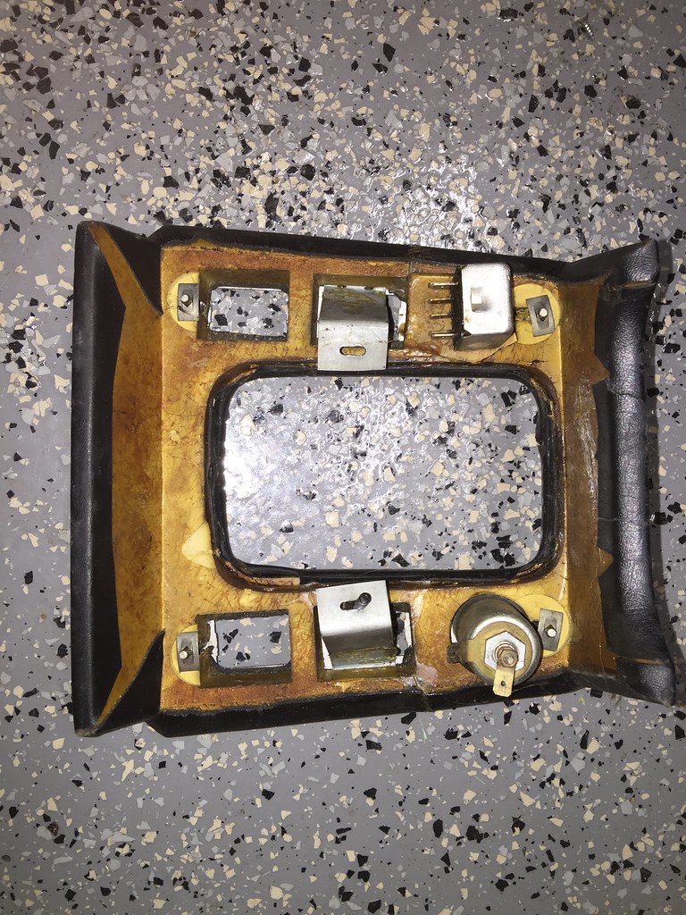

Can someone clear up my confusion... regarding the console which houses/surrounds the gearlever...is there a difference in the A/C car to the non A/c car... I know the side consoles are different (that hold the A/C faceplate) but the actual square shaped console which houses the switches for the windows... they appear the same in pictures , but are they exactly the same ?
Chris,

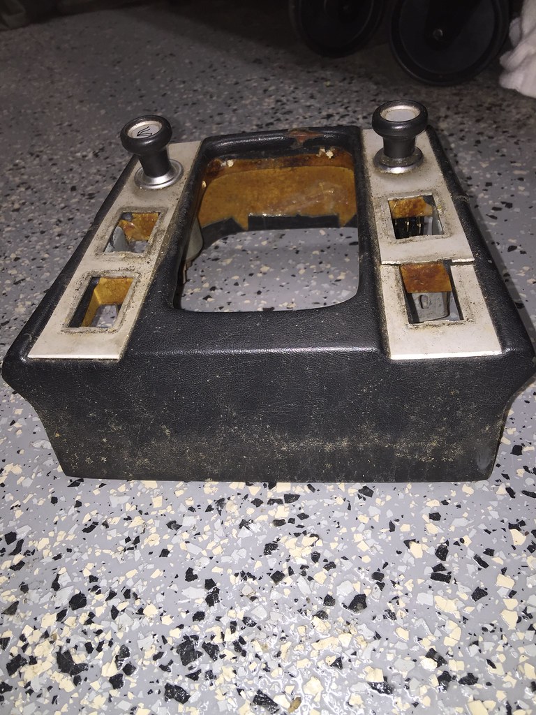

This was in my AC car. Is this an AC or non AC version? I can tell you that it didn't seem to fit particuarly well. It is also made of foam, which makes me wonder if it was a replacement. It certainly isn't new...
Mark, this is a non-AC version. the AC version has a short front leg. mine are made out of wood, but they could have made it from composite in later cars.
Found a pic of an AC version, courtesy of floridabmx. I can see now that the front lip is significantly shorter.
The longer "tongue" can be cut to fit, but it is a delicate job peeling back the vinyl without upsetting the old glue joints or pulling apart the plywood used to make the console.
