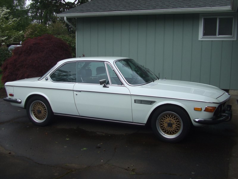

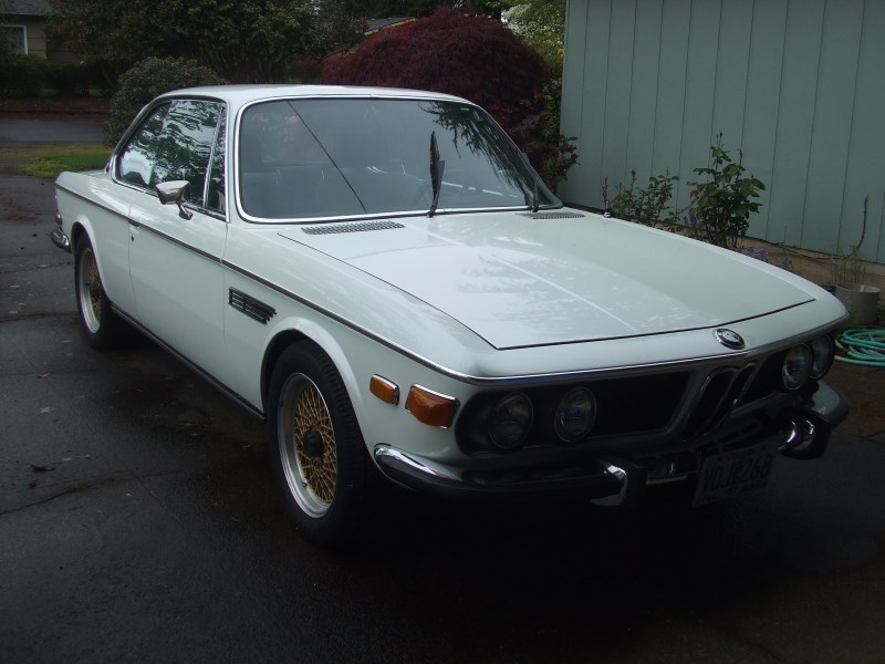

Newbie looking for some info on the basics. 1970 2800cs stock
1. What octane gas do these like? (not the 106 mix I put in the hotrods im sure).
2. 4speed manual tranny oil, I read people are mixing oils for these? Hmmm... Advice?
3. Handling with the stock tire size, is it decent? I have 225/50/16 now and it handles well.
4. Electric fan with or without removing clutch fan. anyone doing this?
5. Finding and installing AC on an original NO AC car.. Are the parts a nightmare (why do I even ask), and will it destroy stock value on these?
6. And can anyone explain this two position or stage radio in this? Blaupunkt style volume seems to have a low setting, and then off in the middle, and then a high setting that is just odd, am I missing something?
Thanks for any help
Rob

1. Depends on wether it´s an Eur spec or US spec motor. Euro spec: 99 Octane, US Spec, 91
2. Use Redline MTL and nothing else. Best stuff there is for this kind of box
3. 195/70R14 is fine, handles very well. Too much tire and grip ruins the balance of the chassis. Whatcha tryin to do - win races?
4. Fohgeddabout it unless you have auto box, A/C and live in Florida. Fix the colling system instead. Make sure everything in it is really up to snatch and you´ll be fine.
5. -
6. Broken. Not by design. Worn tracks.
BTW: If your car has no more than 2 doors (as it seems as per the pictures): You´ve got an E9, not an E3 (higher number, higher price, less doors - logical ain´t it?) - so you´ve posted in the wrong section...
