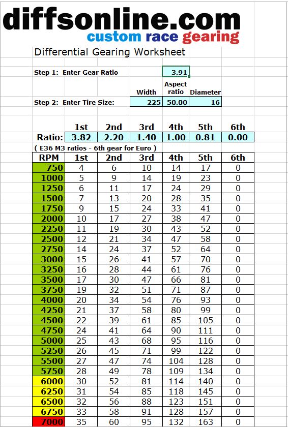

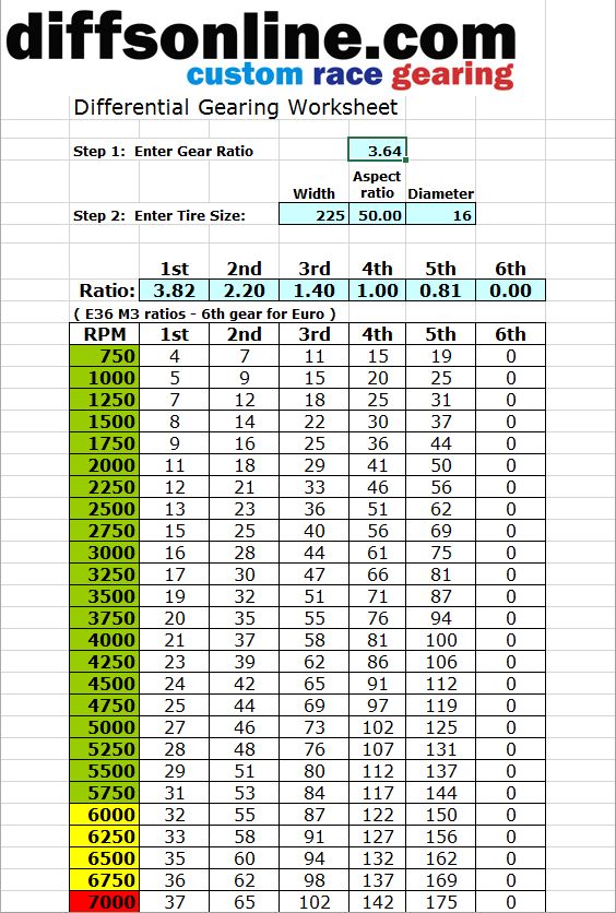

does anybody know the ratios of the 265 tranny? diffsonline has a gearing calculator spreadsheet and it would be really cool to be able to see what the rpms of an engine would be at certain speeds / gear
thanks Chris. here is why i asked ... i was curious what the different speeds would be with different ring gears
