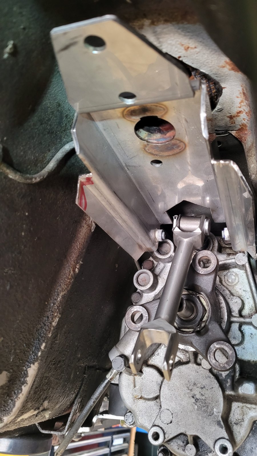

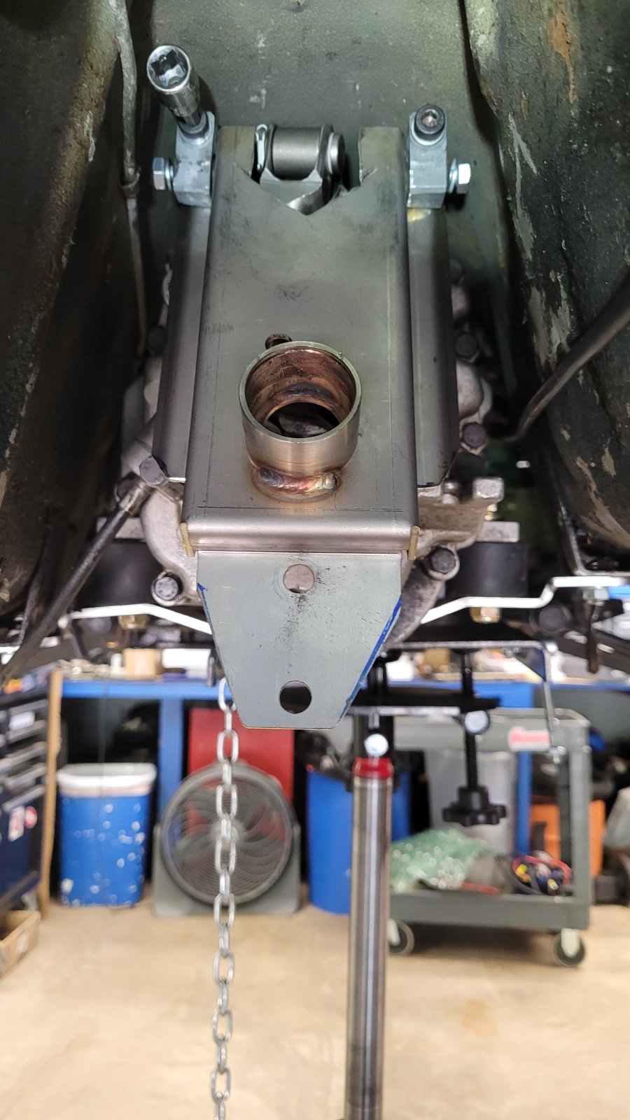

Good idea. We have gone through several iterations of prototyping with our designers/users/manufacturers over the last year or so (which is rather quick progress for a very small company @Thomas76) and I don't have a final version to show yet, but here are a couple of pics of the part we are working on. I made several adjustments after installing the prototype on my own '74 CS just last month and these will show up in the final product.
I apologize for the extended development time, but, as anyone knows who has bought any of our products, we make world class, vintage BMW specific products, not cheap generic parts.

I don't have any feedback that the orientation of the G265 would cause any problem shifting into reverse except that the shift lever can hit the surrounding console and make it harder to get into gear. I can say that the clevis fork on the rod that connects to the transmission input shaft has very tight tolerances to the inside top of the shift tower. I've done test fittings with the OEM shift rod and DSSRs, and both have clearance issues in reverse and fifth. Some folks have the problem, some don't. So, we solved that problem by creating an opening in that area to eliminate any possibility of interference.
