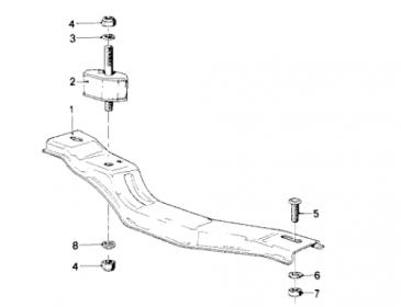

23 71 1 175 314 cross member attached

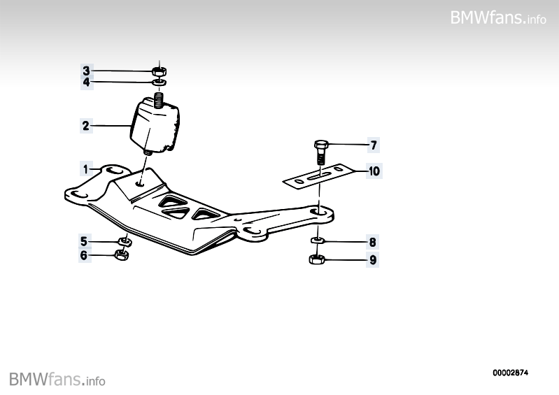

This part number 23 71 1 175 731 comes up looking like this:
Whereas part 23 71 1 175 314 (from Carl Nelson's how to) looks like this:
So which one is correct/preferred for a Getrag 265 conversion from 4-speed?

Finally? Those pics of the steel supports are messed up. Both pics are the same of different parts with different part numbers.
Same issue with the cast pics- they are wrong.
