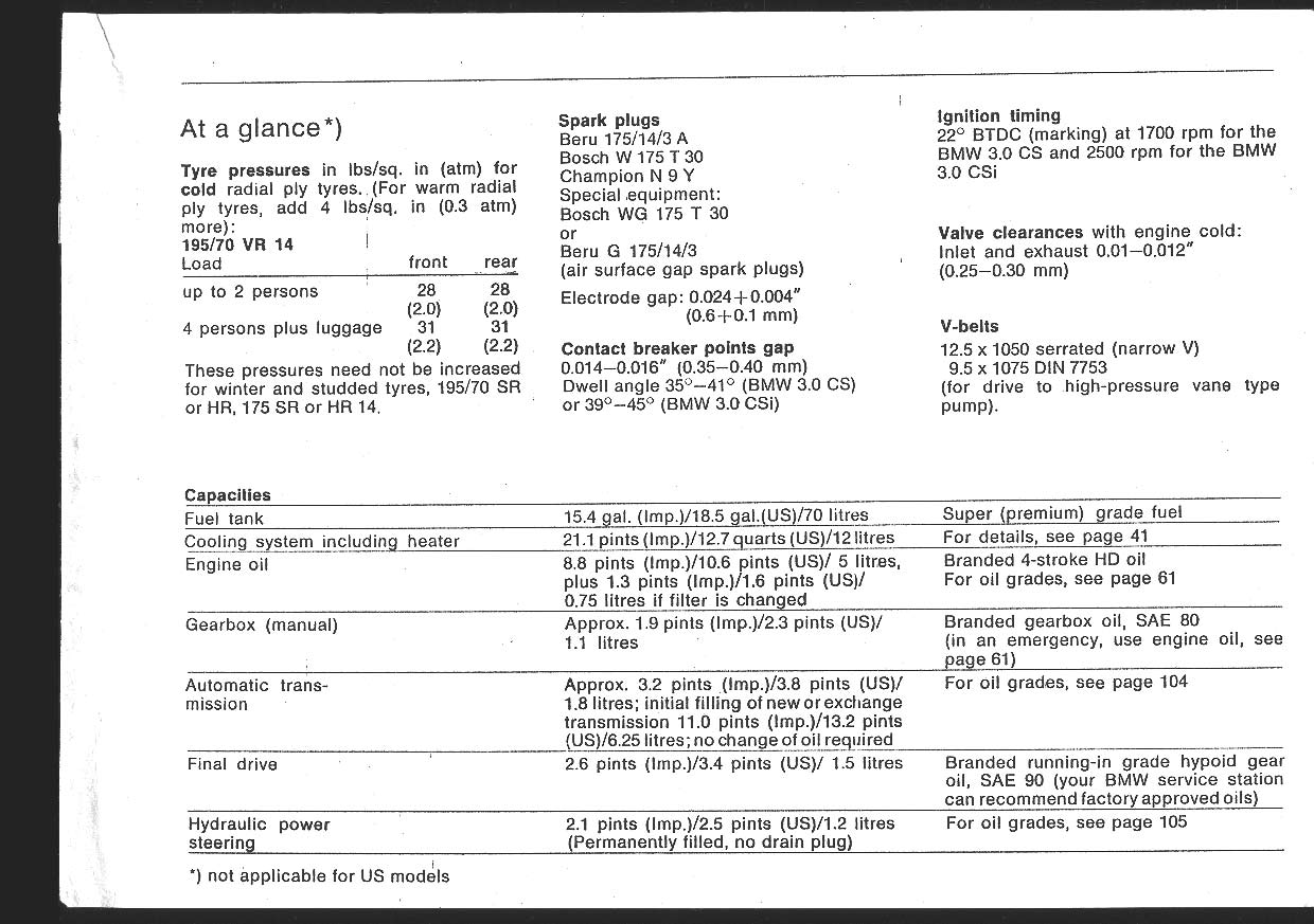

i dont understand what is a dogleg, but for the standard gearbox in the e9, bmw says that you should use oil gearbox 80

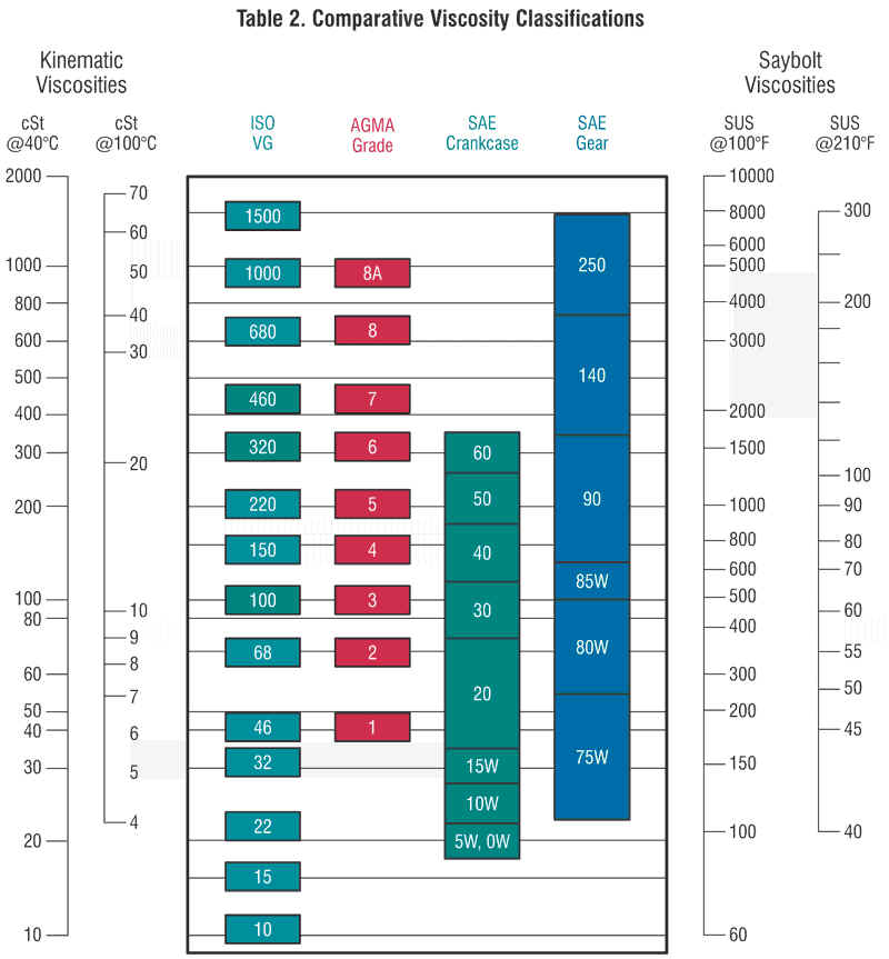

Your skepticism may be misapplied though if you are merely concerned with the "weight" or viscosity index of gear oil versus other oils, namely motor oil. "80 Weight" viscosity gear lube is the equivalent of "30 weight" motor oil. This is why BMW's owner's manual even suggests using 30 wt. motor oil as a substitute "in an emergency." Frankly, if you are very concerned, I would go with the best name brand synthetic you can find. Whether that is Amsoil or Redline or countless other brands, depends upon who you ask and how much you are willing to spend. (I tend to use whatever brand name products are available and change fluids a bit more often than recommended. It tends to delay the inevitable) :wink:
