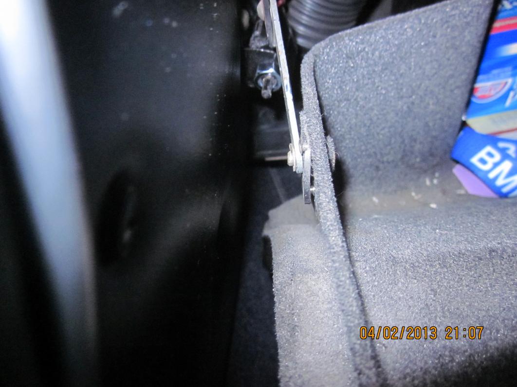

Can someone tell me if there is a bracket that holds the switch for the glove box light.
I sure can't see one in the parts diagram.
It would be to the left side and would hold the switch in a position so when the glove box closes the side of the box would contact the switch and turn off the light.
I removed my glove box back last summer and have been doing some repair work to it. I have the switch just hanging there but no place to mount or hold it.
Thanks,
Gary
Yes, see photo.
Yes, see photo.
Thanks so much Andrew.
Do you have a photo from further back so I can see where it is located.
I didn't think of it attaching to the box. I thought it would attach under the dash somewhere.
I can easily make a bracket like that.

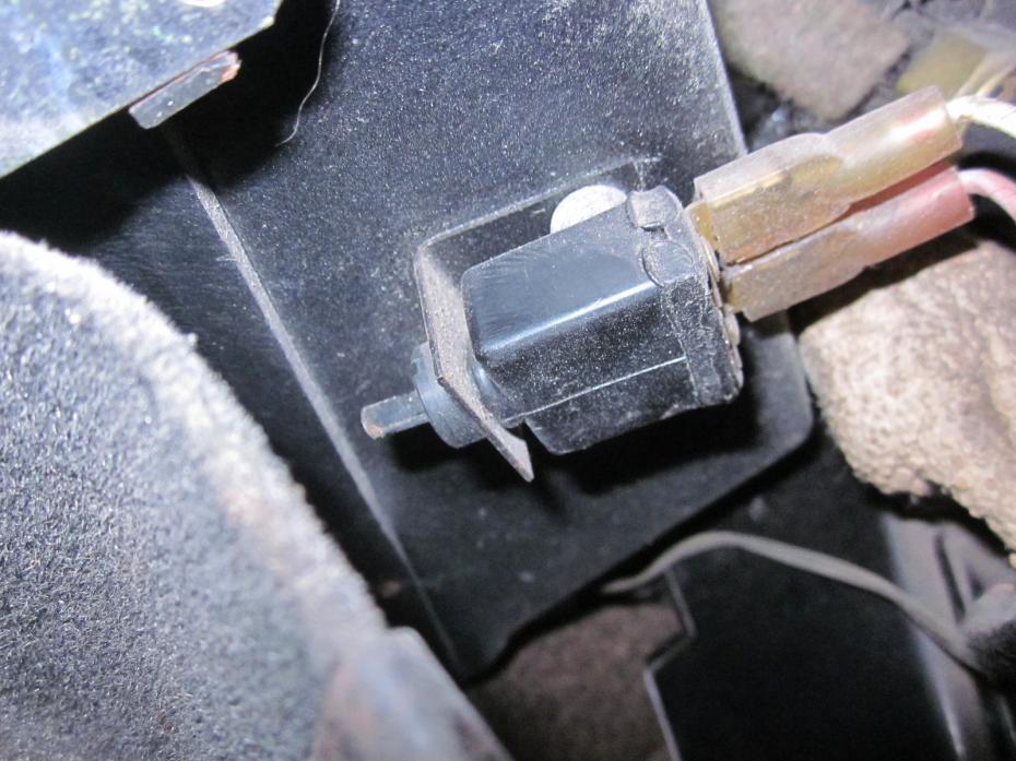

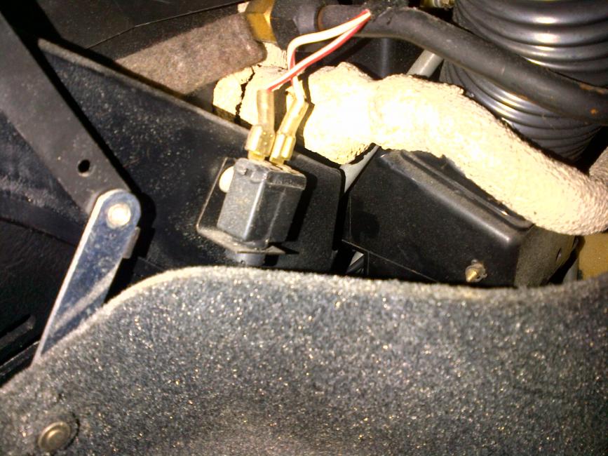

Position the switch so it hits the outer edge of the glove box when it's closed.
Hope this pic helps, not easy to photograph.

Thanks guys I got it now.
I see it is mounted to the console area.
I went and looked at the glovebox tonight and found no holes for the bracket. Heck, I even found the bracket.
From the first photo it looked like it was mounted on the box itself.
Now I can put the glove box back for the first time in 7 months.
