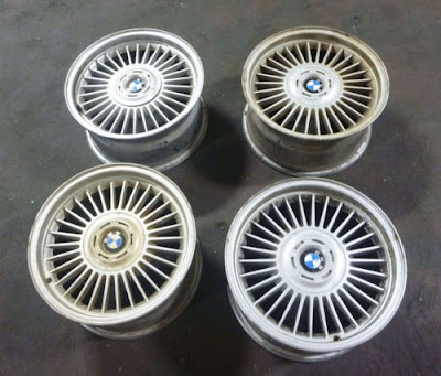

Like This (photo credit Dequincy):

Could someone post a picture of a "Alpina" wheel next to a BMW OEM wheel and point out the differences?
BMW Wheel: Spokes go straight to the rim
Alpina Wheel : Spokes taper into the rim in a slight arc.
There are stamping differences too, too small to see in Stan's photo.

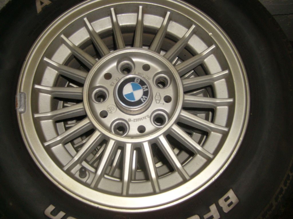

Those are not Alpia wheels they are the BMW wheels probably 1974.
See the difference?
As noted, the 7x14" Alpinas have much deeper lips than the 6x14" BMW 20 spokes. Believe the extra inch fully goes into the outer lips.

BMW Alpina style wheels
BMW also sold some Alpina style wheels in 14x7 size. The same (size) as the genuine Alpinas.
