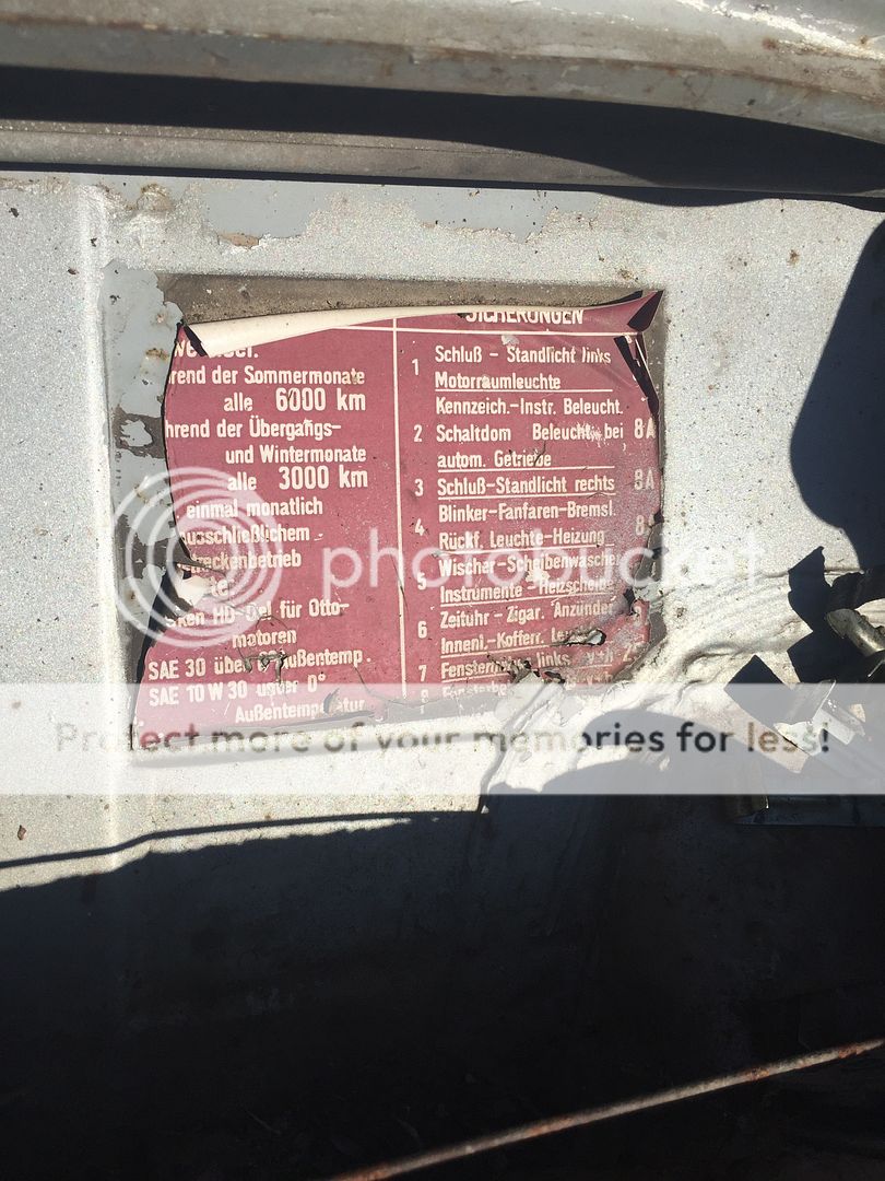

check fuses only #6 had power - cleaned terminals - got the 7-8 to work ( owners manual in the glove box says they are for the power windows )

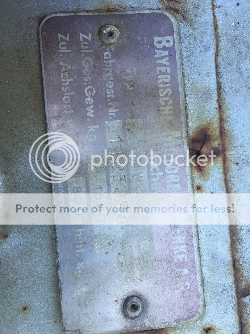

I took a picture of the build plate:
It says 2000 C on the plate.
Nebraska title says 2000cs
back of the car says 2000CS
as mentioned earlier single carb -so maybe it is a C ? Does it really matter?

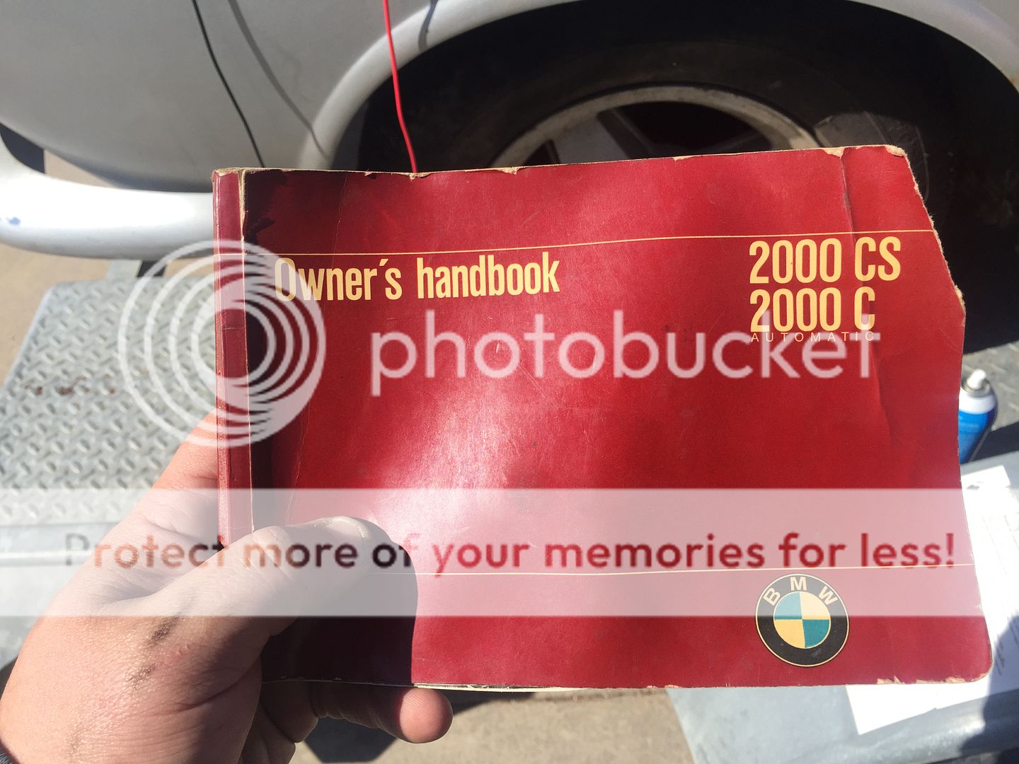

I am definitely not an authority on these cars. But the photo of the owners manual indicates that the manual transmission cars were "CS" while the automatics were "C". What sort of a gearbox does your car have?
Is this a EURO car ? the bumpers / headlights are euro - the owner manual is in english?
Before the mid/late-1960's car manufacturers didn't build US models that were different from the European models. All cars were pretty much alike (except the British/Australians/Japanese needed right hand drive models). So your 1967 2000CS has world headlights and bumpers - not Euro. Translating the owners manual into English was about the most a small automaker like BMW could afford to do.
thanks - that makes sense.
Didn't realize the dual purpose title on the cover of the owner manual.

US imports through Hoffman Motors had quad headlights, the smooth glass euro version was not approved here by the DOT. The VIN indicates a CS, there were both automatic and manual C models. The most rare is the manual C, followed by the auto C and finally the CS. The twin carb CS is more desired as it had 120 HP vs 100 for the C.
