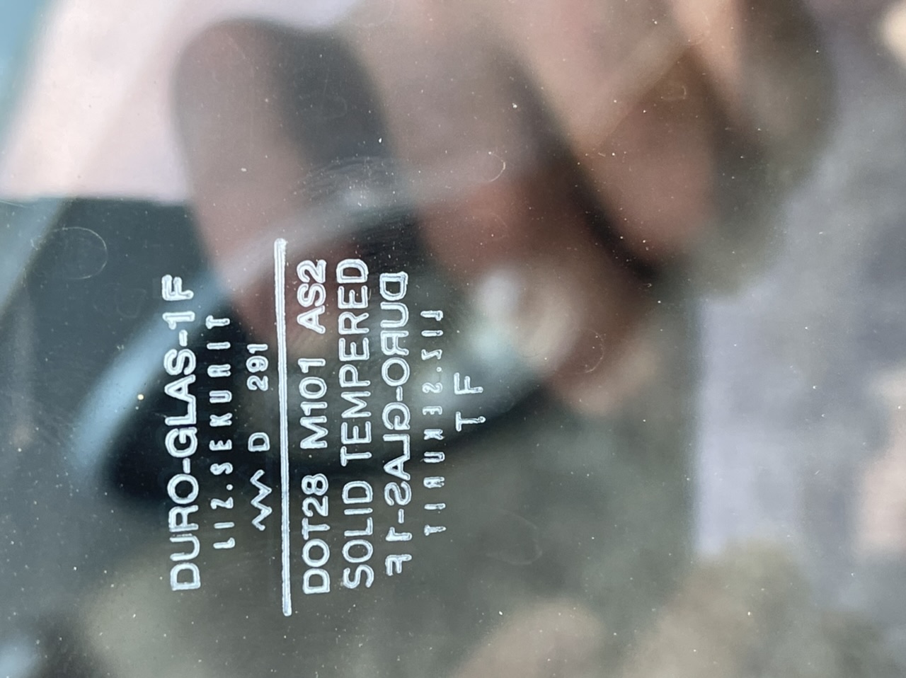

@sfdon - I was trying to figure out the same on one of my 2002’s. It‘s neither M85 or M100, it’s M101. The PO tinted the windows so can’t hold up a piece of paper.
M85, m100, m101 are Manufacturer tint codes
as1,as2 and as3 clear or tint codes
Image result for m101 as2 window glass
The AS1 means that it is the clearest form of glass to use in cars. AS2 or 3 would mean that it is tinted. Only AS1 glass can be used as windshields.”

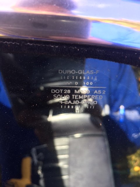

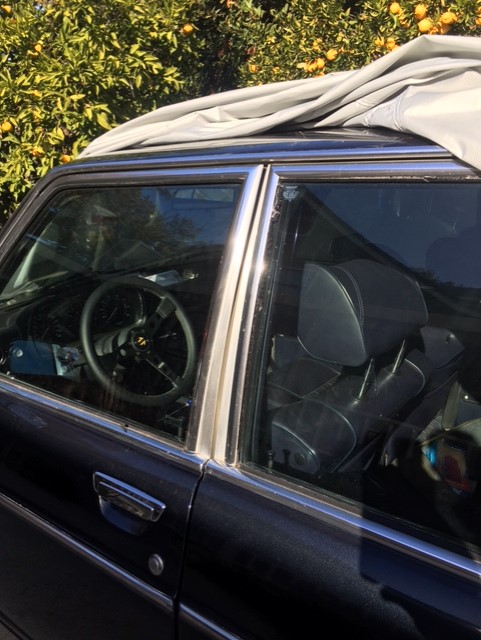

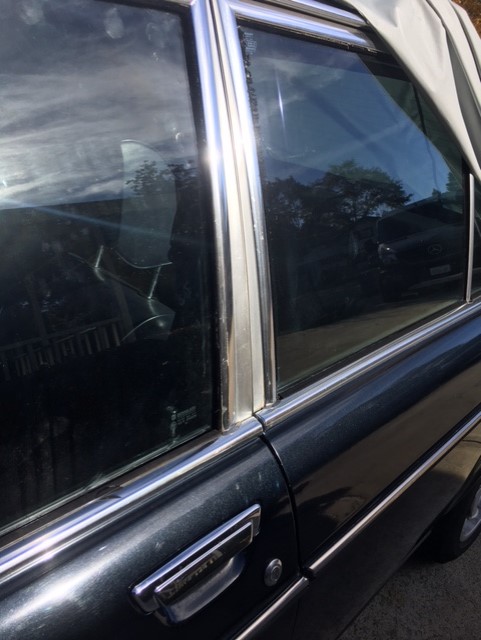

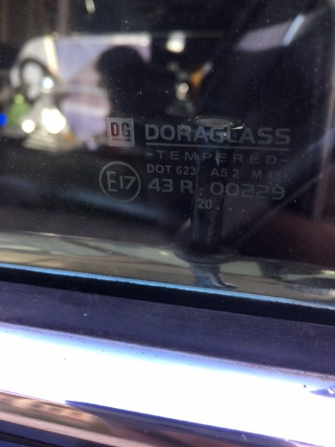

To follow up, and to (maybe) answer @AustinOski 's questions:
I ordered the tinted version from Wallothnesch. $85 + $50 shipping. So not bad. Shipping seems to be $50 no matter what you order and parts have been getting to me in California in less than two weeks.
The markings on my original glass seem to be similar to yours. The replacement window had slightly different markings, but the tint seems to be a good match.
