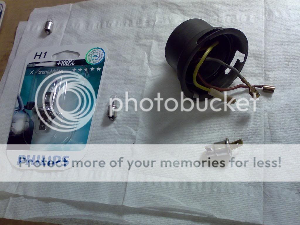

My car is an Italian import and I'm assuming the H1 bulb in the high beam position is a Euro model because it doesn't look at all like the ones listed here
Note the black section, I think this is the burned out part? Compare the above to stuff I've found on the 'net
http://www.jeep4x4center.com/hella-...campaign=cse&gclid=CJWioOvvx7QCFQioPAodPkIATw
They look entirely different but are both listed as Hella H1 bulbs.
Am I going to have to order them from Europe to get the correct bulb?
I also seem to have the "parking lights" type low beams. When I have the low beams on and shut off the ignition, there is still a low light from inside the fixture. I'm assuming I'll have to order replacements again from Europe as I don't believe we have anything similar here.
my h1 bulbs are like the ones that are showed in your link, not like the one that you show in your pic
those h1 can be bought in any shop across the street i.e. PHILLIPS 100% more hi blue light, for around 20 euro each
these are xenon effect, a very good whiteblue light
here you can see how they look like
btw, you know that i will have no problem in preparing a box with those difficult to find goodies and send them to you, i will only need a little time to do so
Thanks deQ! I pulled out the right side high beams and it looked exactly like the one you show. I just got two more H1's for about $19.
I wonder what the first one I posted is? As it's listed as an H1. Really old possibly?

Bwana,
The bulb whose picture you posted is an H1, just like all the other ones pictured in the thread and in the links. The difference you are seeing is just a different design as far as the support of the glass enclosure goes, a metal piece vs. an extended glass section. What matters is the distance between the flat, keyed, base of the bulb and the filament, such that when it's placed in the lamp assembly, the light source (filament) ends up in the correct location.
As far as cleaning the inside of the lamp, the reflector and glass, I've had great success with fizzy denture cleaner, forget the brand but any should work, and hot water. The key is to give it a few final rinses with de-ionized or distilled water so that no residue remains on the reflector. I then place them in an oven at around 200 degrees to quickly dry them.
The smaller bulbs you describe as remaining on after you shut off the ignition, but keep the light switch on, are the city lights, equivalent to the US "parking lights", although with a different purpose in Europe/ROW. They are just 4W bulbs which you can pick up at an auto parts store. Not "special" at all.

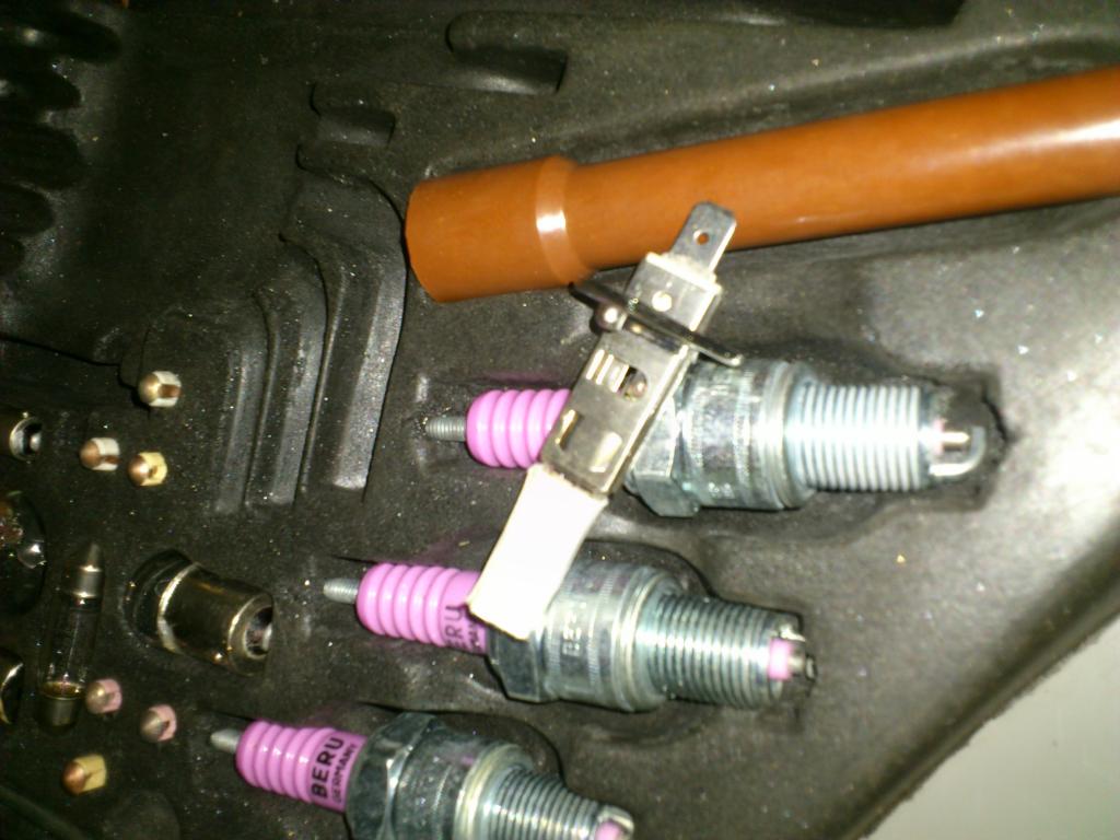

You know when the spare part box is 100% complete :-)
The original cover for the H1 bulb.
Pink plugs?
Do you have a big flower hanging from the mirror?
Same here. Do I sense an opportunity for Stan the repro parts man...?:smile:
Do I sense an opportunity for Stan the repro piece man...:smile:
