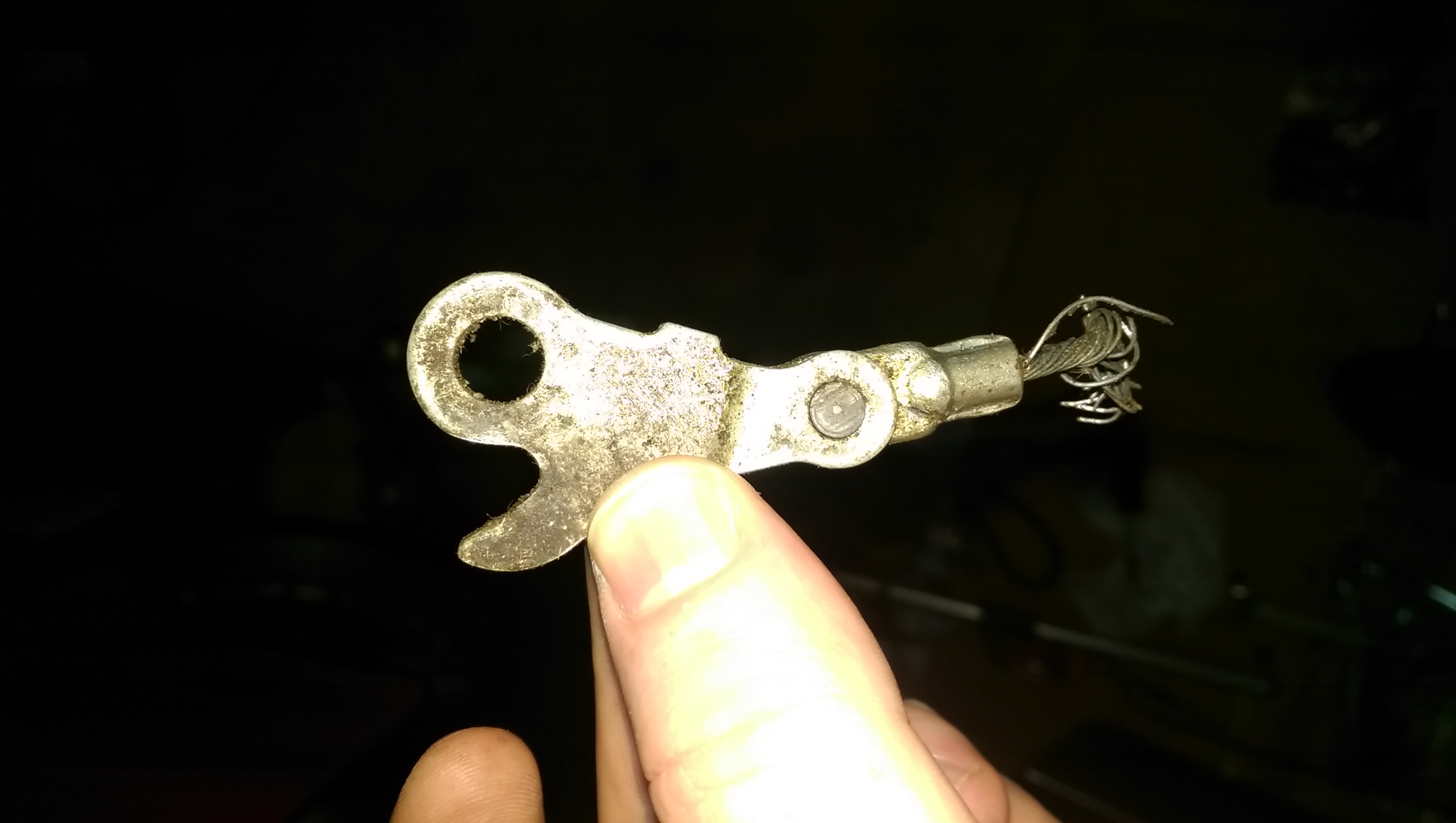

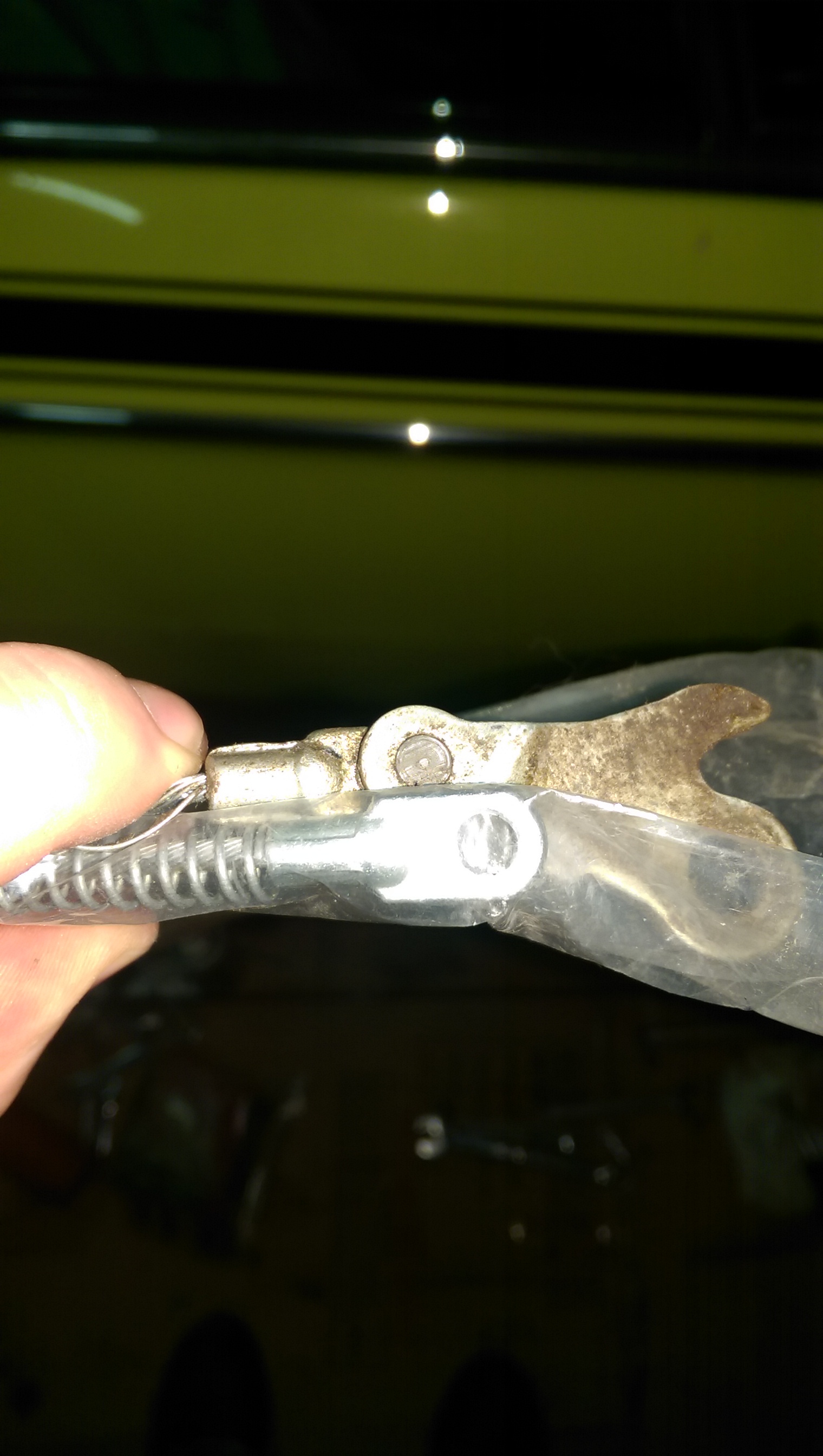

Handbrake cable attachment?
30csl
1,345
15
London/Herts
Do I need a different handbrake cable or do I drill out the pivot and replace? Thanks all!

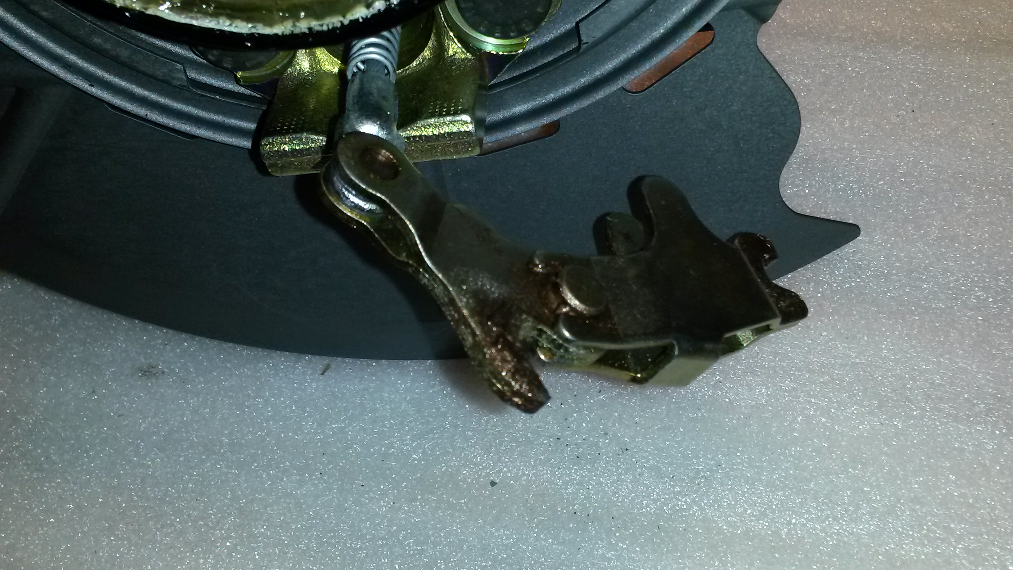

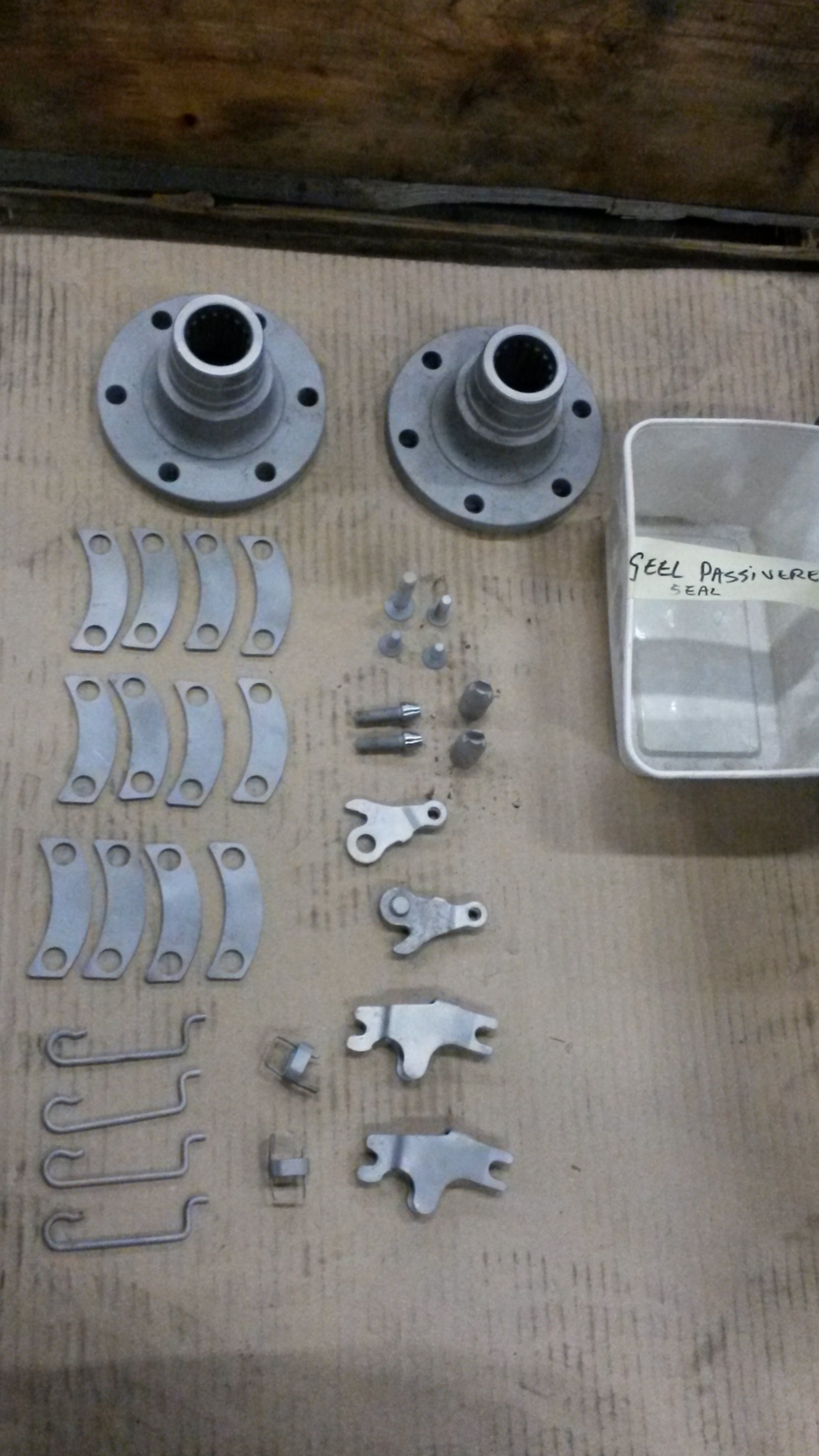

Attached you see some pics, showing they can be seperated like Alan mentioned. (on my '73 3.0 CS European spec)
First pic shows in the middle the two parts that fold inside each other to create the lower pivot point of the rear brake shoes.
Second pics shows the parts partly assembled after plating.
third pic is the almost completed rear drum assembly (springs are not installed yet)

Erik, thank you so much for those pictures, they really helped me. Much appreciated, Rohan
Hi Erik, do you have a ffew more pics of the handbrake assembly in the hub? I have a bag of bits and this would be easier than removing the disk the other side - the third pic above is very helpful but what is going on behind the shoes would be great!
Thanks,
Rohan
