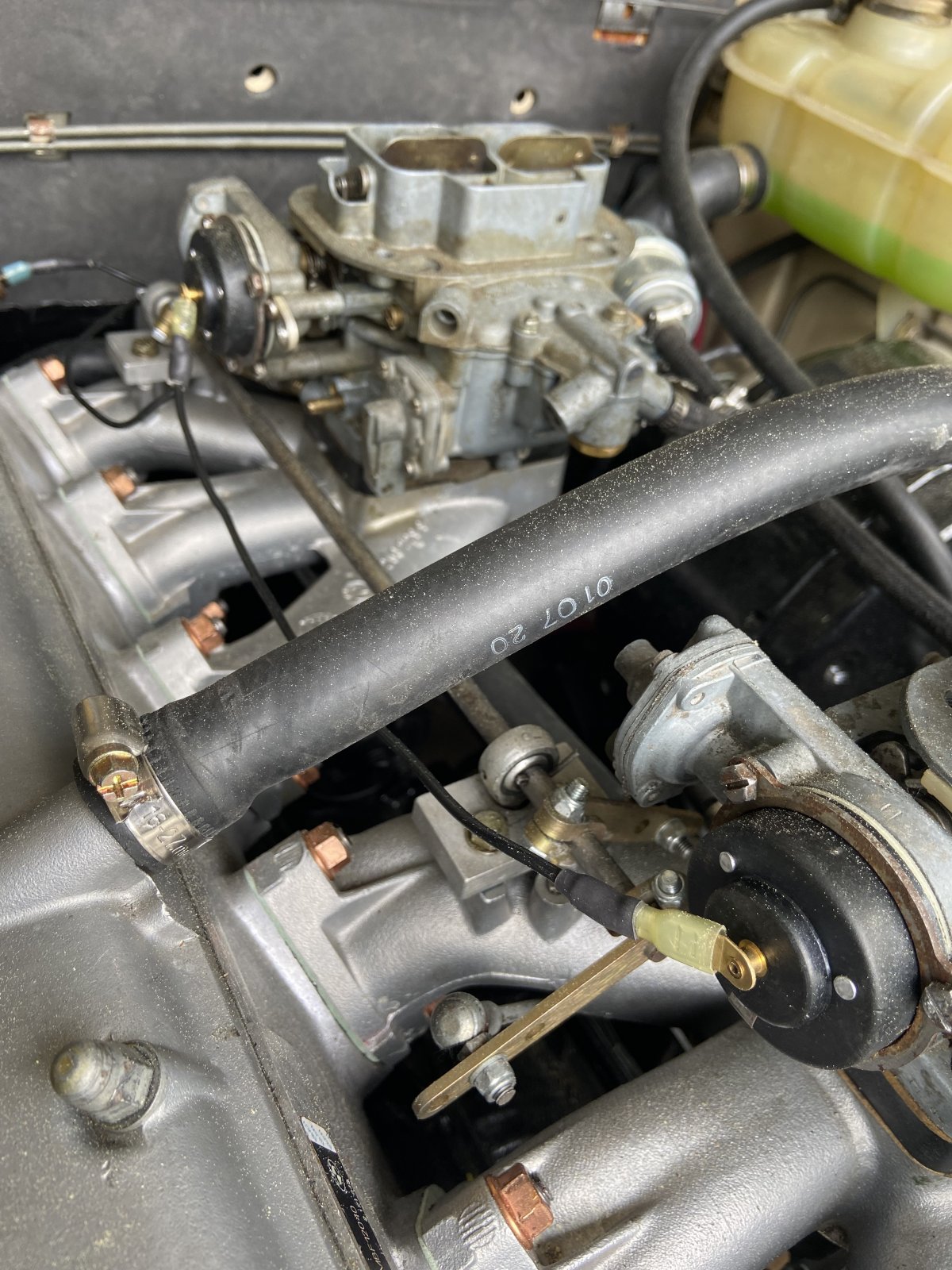

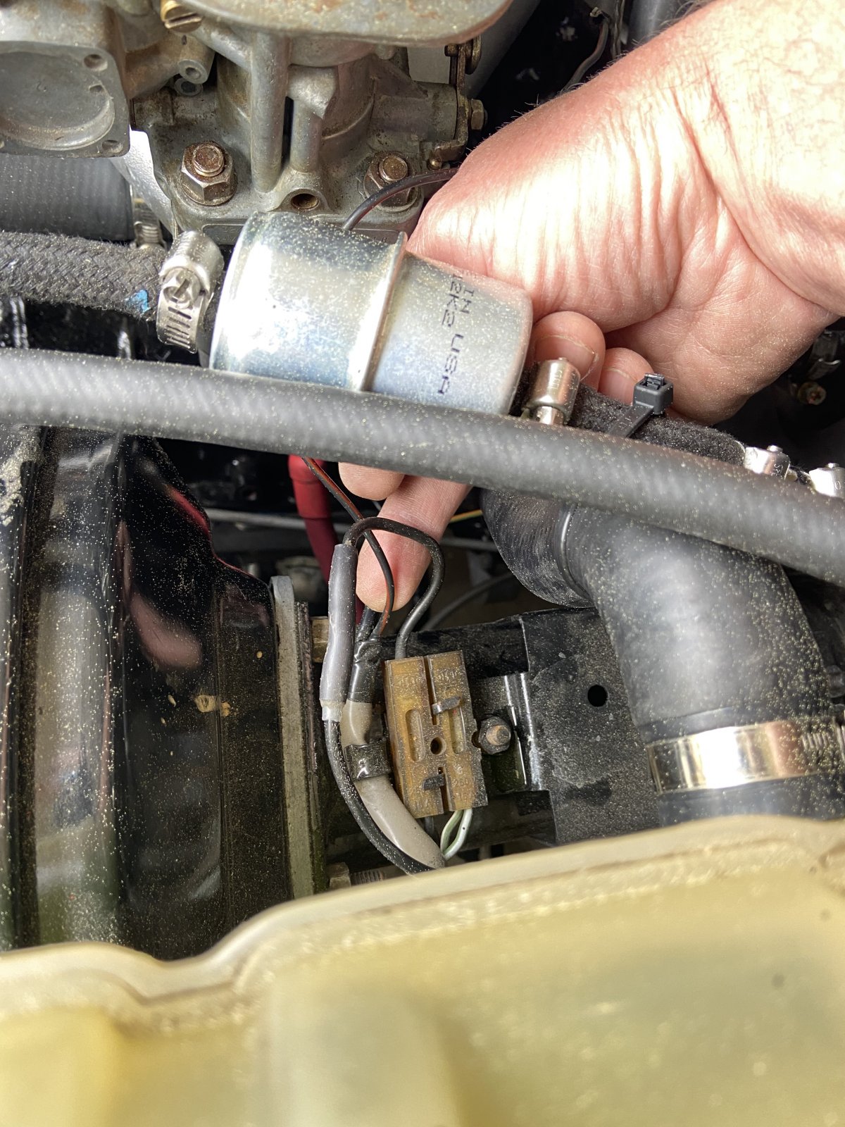

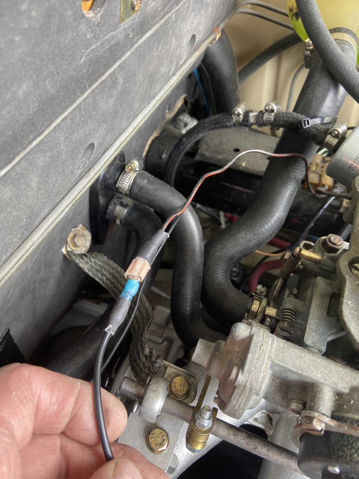

When I removed the Zenith carbs from the bavaria and installed the Weber 32/36s, I also removed the Zeniths wiring harness for fuel and choke. However, for a rainy day, I kept the switched power source that is on top of the brake booster (brown/red wire). Today I used it for the electric chokes I switched to from water chokes because the B35 does not have a coolant fitting like the B30 does. I like the way the electric choke and no small coolant hoses clean up the area around the carbs.
Just thought I'd mention this for others who may need a handy switched power source that is already in the engine compartment.
