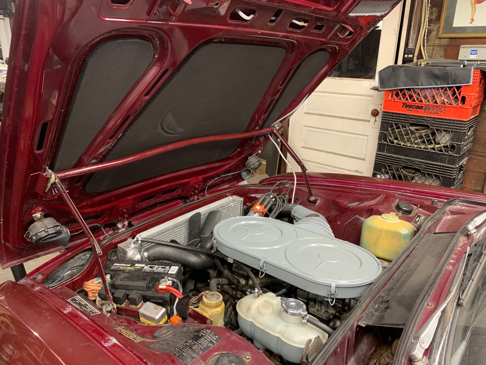

I exhaustively searched for all variations of this topic with no success... so here goes:
Freshly installed new 38s on a 3.0.
***Choke and jetting is finally where I want it, but warm starts (after sitting 15 min or so) require full throttle.
Thinking the obvious "fuel boiling / seeping into the manifolds" issue, but there's gotta be some solution that will keep me from rinsing my cylinders w raw fuel every time.
car has stock new mechanical fuel pump. Hot starts are great, cold starts are instant..but warm starts are embarrassing.
have 1/4" phenolic spacer under each carb. Weather here has never been above 75 degrees.
Anyone experienced this and have a reliable fix? Float levels seem good. Timing is dialed in, etc...
Many Thanks in advance! Photo for air cleaner style reference.
