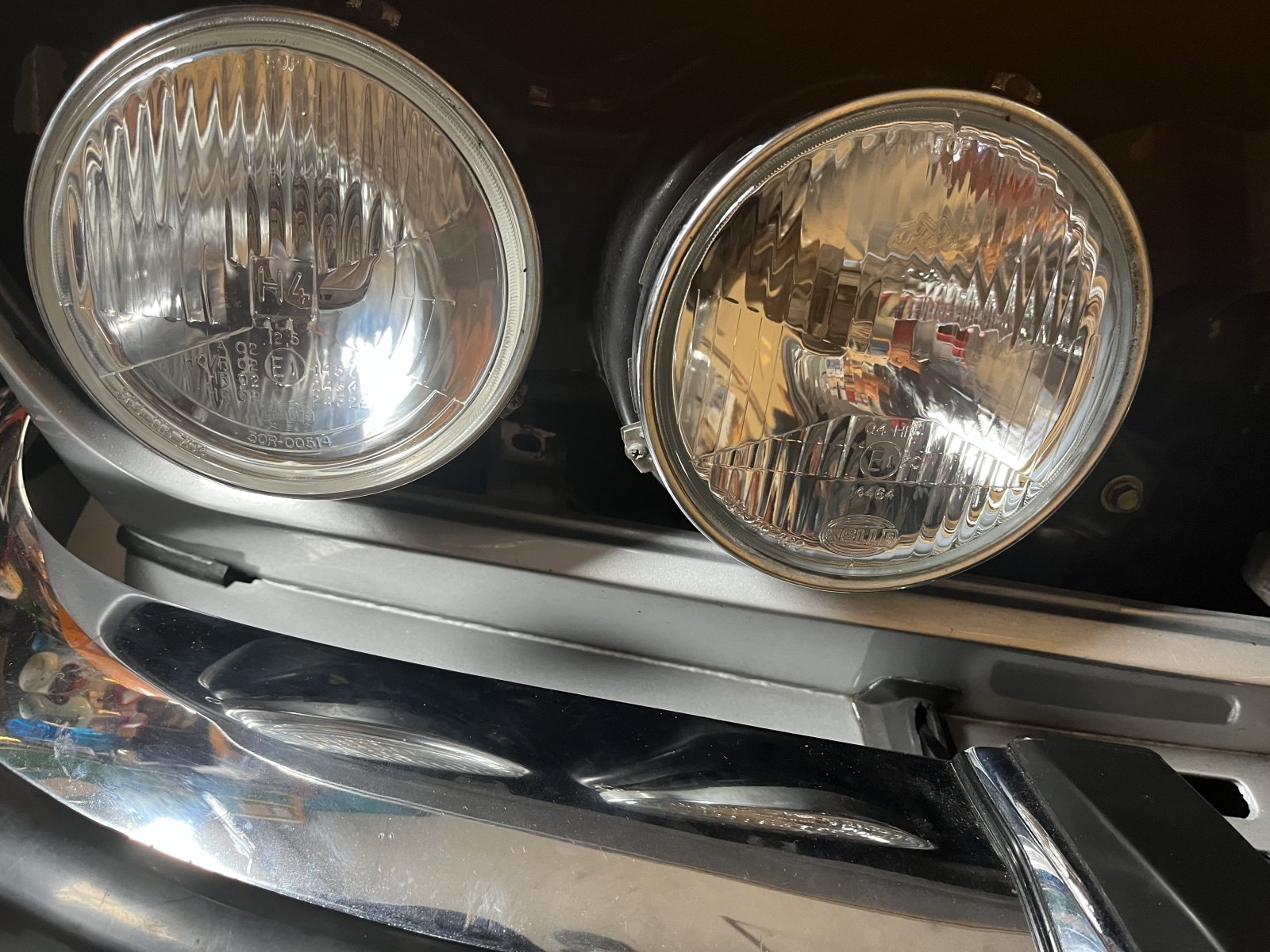

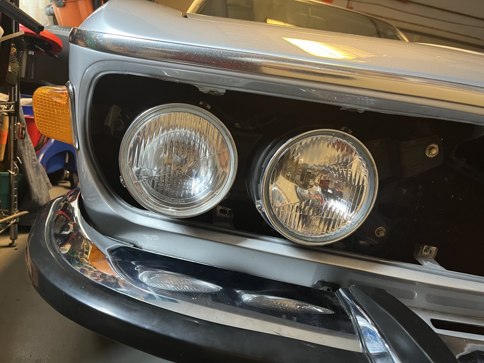

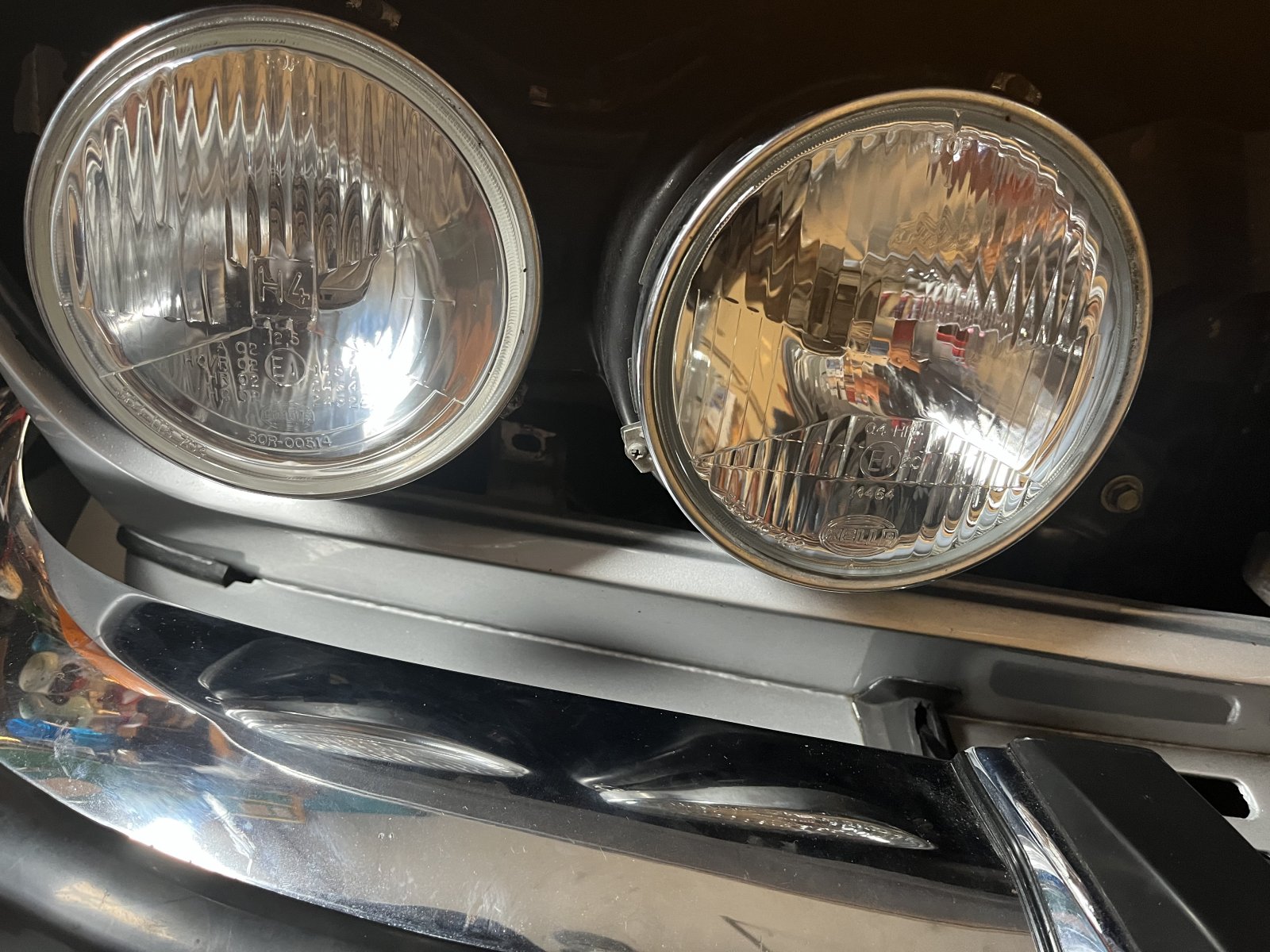

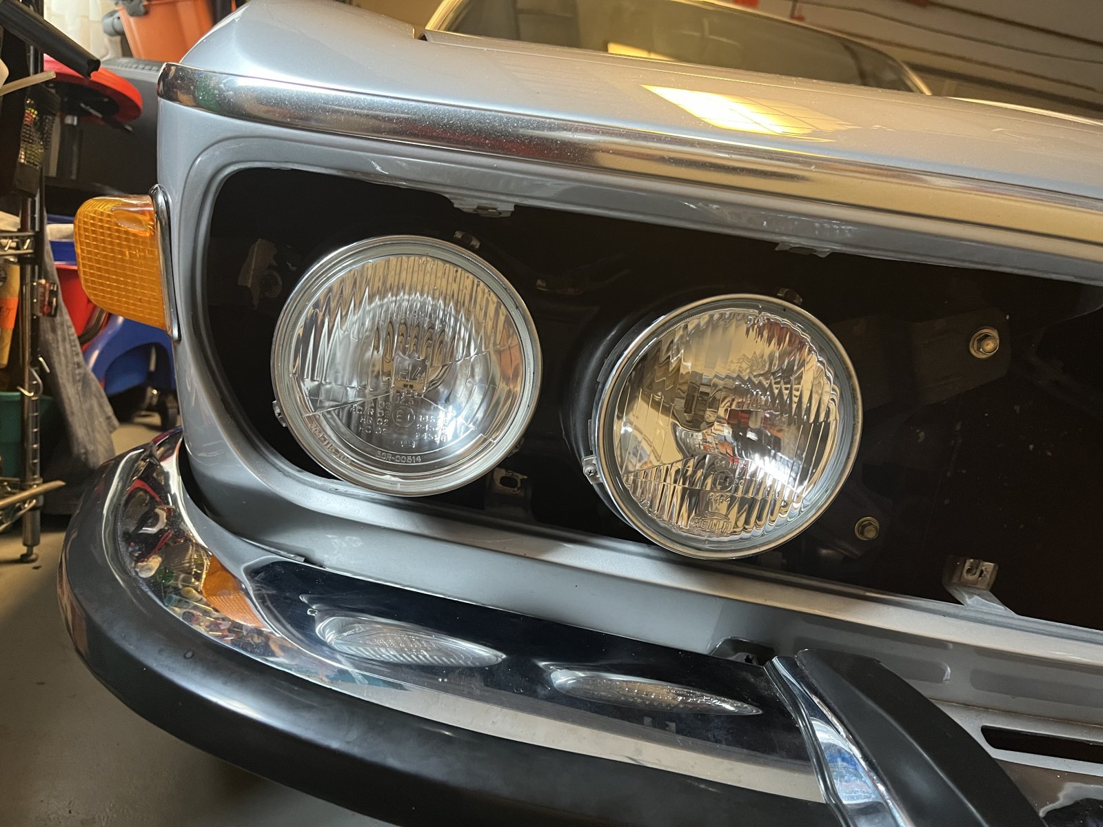

I did a search but could not find this information, although I am sure I missed it. I wanted to replace both the high beam and low beam bulbs after I clean the lenses. Can someone recommend or send me the link for the correct bulbs?

Ummmmmmmm- USA headlights are sealed beam lamps. Are you saying you have lamps with replaceable bulbs like in Europe?
I was told bulbs come out?

Don’t go wild with the bulbs since some of the super high end ones don’t last any longer than the regular and have a weird blue tint to the bulb itself and you see that when the lights are off.
Agree.
There were tests done in a past with different bulbs.
Sure, standard will not be as bright as some marked with "Ultra", "Power", "Super"... but will last longer and - what is more important - save the mirroring surface of the lamps (valid mostly for low beams) as the "brighter" ones have higher UV emission typically (which was proven during testing).
Also - on the other side - the test showed that the geometry of the filaments is not according to the standards making the headlight much less efficient as a system.
It is generally recommended to buy known manufacturers in your region.
