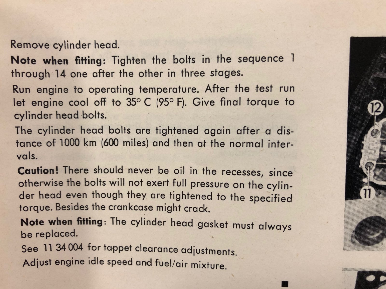

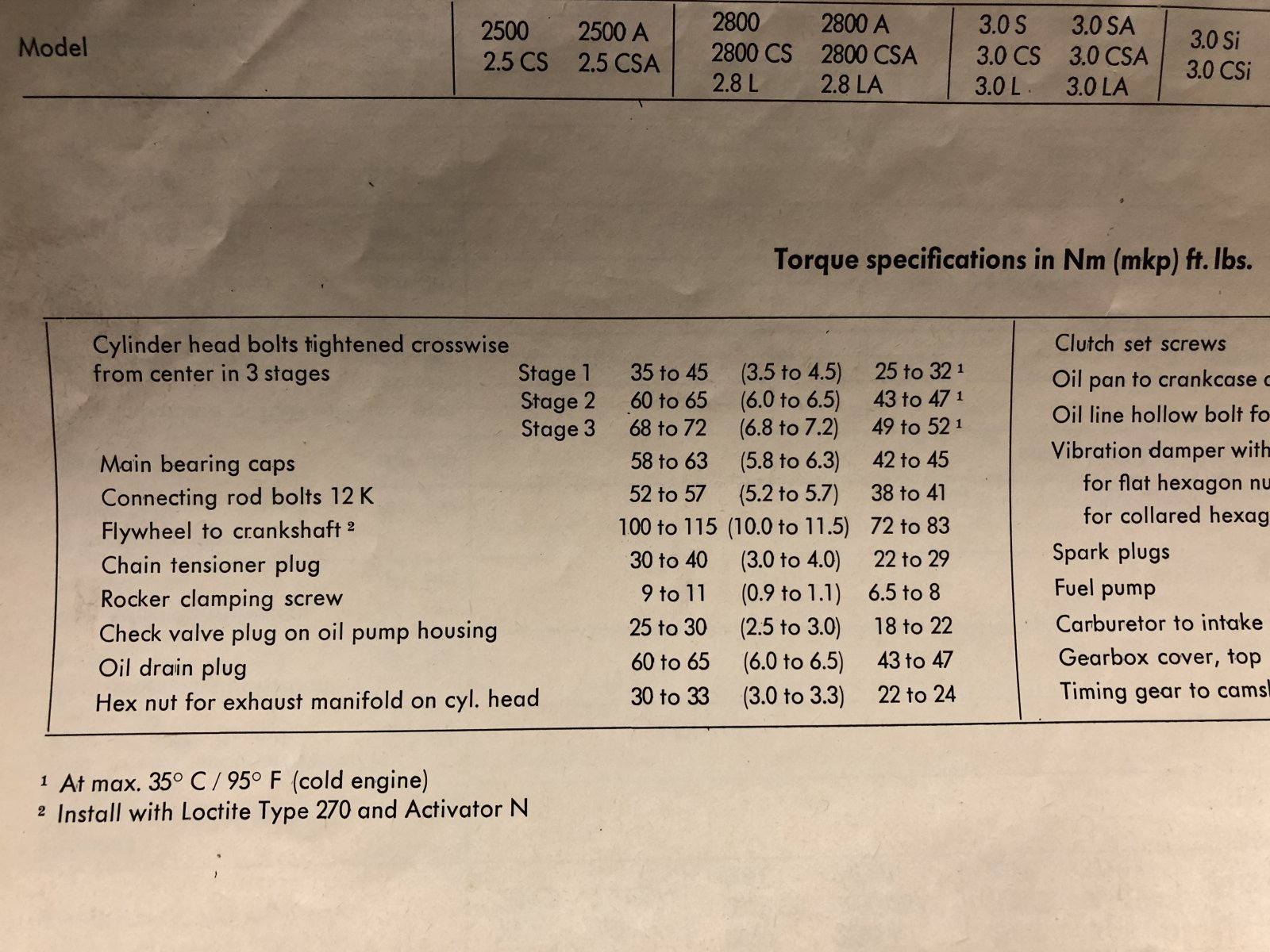

Trying to make sense of this , Per BMW manual , 3x tightenig stages which is fine, however, in right hand column the torque setting is lower for cold engine ( see #1 footnote ) ...surely the engine is always cold when going through the torquing sequence? Thanks, Simon

Had the situation where the blue books said one thing and the head gasket kit from W&N said something different. From memory ons advised NM and the other was 30 degrees.
Took the view that we'd go with what W&N advised as gasket materials and bolts may have differed in the 50 odd years since first produced.
Either way you need to re-torque bolts after letting engine get to running temp, from memory for 15 minutes.
Can double check later this week if you like?
I believe it’s the heat cycle that modifies the metal in the fire ring to crush further. modern headgaskets come with about 7 thousands difference between the ring and the composite material. Without a heat cycle and 3rd torque you will piss coolant out from between your head and block.
