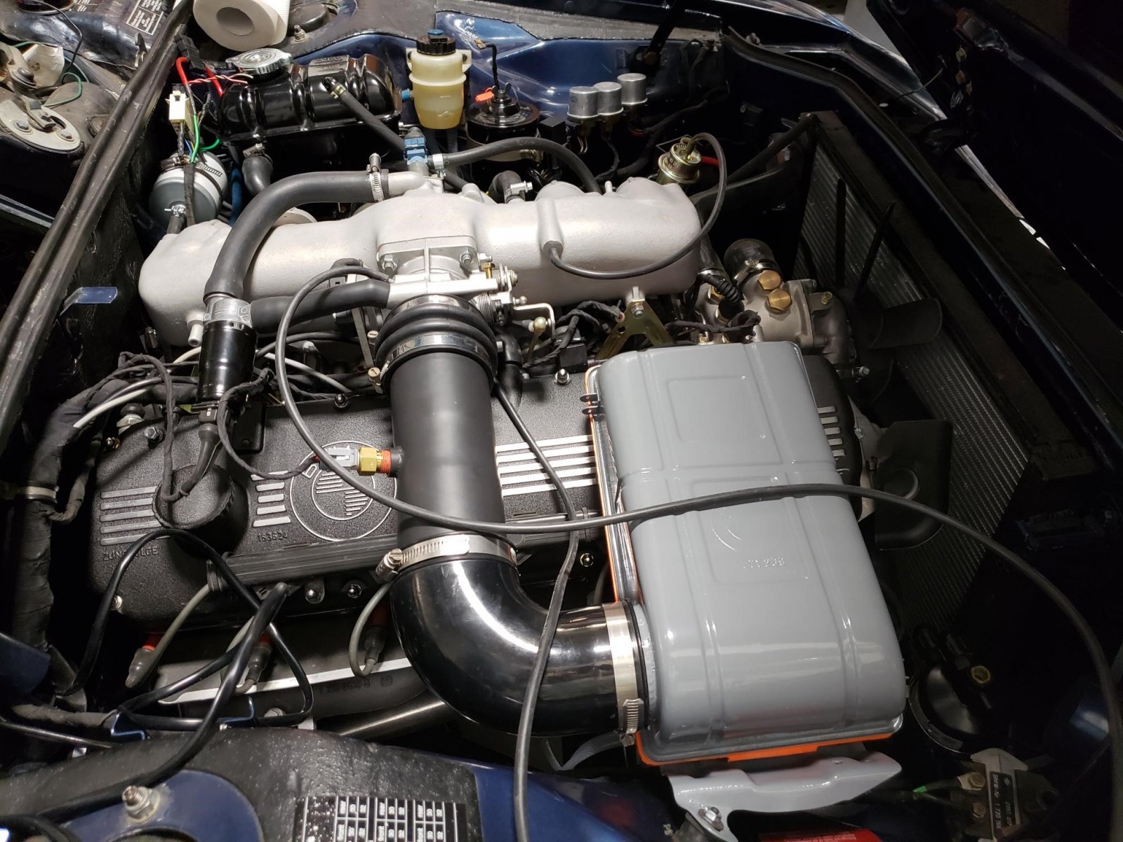

A good friend offered me a set of Stahl (sp?) headers for free. He said they were the "good" ones. Does the collective mind here think I should attempt to install these? I have a new W&N SS exhaust and the stock manifolds from the Euro 635 CSI engine that is the "building Block" of the car- 10:1 compression, Megasquirt, mild cam.

Personally, I would put them on my car, but mine is bone stock at the moment. I assume they would breathe a little better than the stock 635 manifolds, and should probably marry with the SS exhaust. That's probably the only issue, and I don't know if any mods were made while fitting, or the condition of what he is offering. One of our more learned members WILL know more than me...but I'll bet a test fit is the only way to be sure. Your engine looks great, by the way.

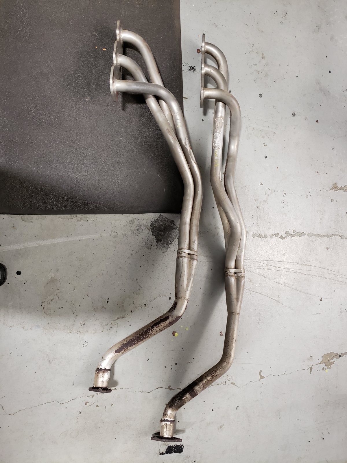

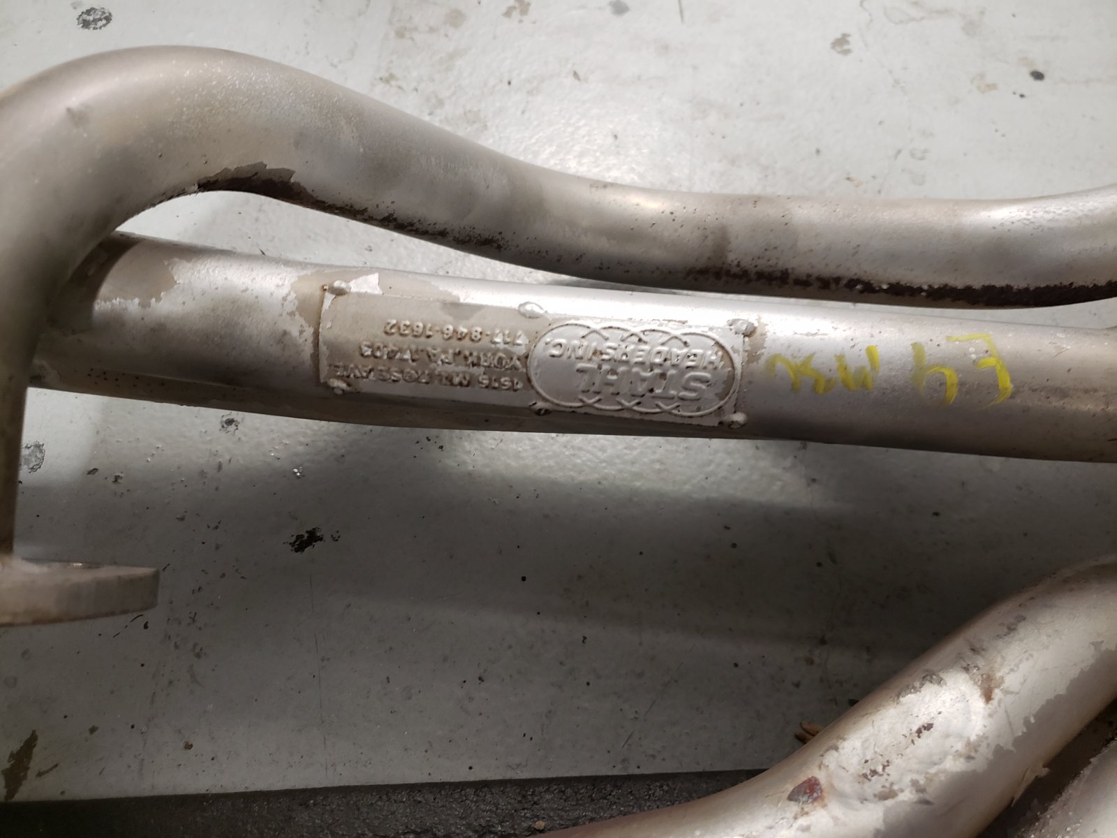

Long tubes? Depending on the diameter, they can be just right, too small or too big. IIRC, there are 3 sizes , 1 3/8, 1 1/2, 1.5+....?!!??
I had my set ceramic coated (by Jet-Hot ,10+ years ago) and have been very pleased.
They can be a 'dance' to install, one from the top, the other up from below. A friend would make install much easier and the jack stand location might be irritating...but if the car is on a lift..... ;)
i am going to put my new stahl header on my euro b34 10:1 compression engine. korman always used the standard 1 3/8" header with their stage 2 engines ... which produced 240 hp +/-. while i think the 635 stock manifolds are better than the coupe manifolds / downpipes ... i think the stahl is better.
when i had the same engine (‘81 m90) rebuilt running on motronic 1.3, korman sold me 1 3/8 stahls to help it breathe better. i’ve been very pleased.

I thought I would post a couple pics so maybe that might help with the advice. Thanks
