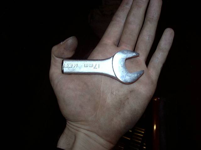

Your lament is not uncommon. Some of us have issues removing even the stock manifolds, not only because of limited access but because the fasteners have a tendency to rust and become rounded over. Mechanics tend to be limited by: the size and dexterity of their digits, available leverage, available tools and ingenuity. Without seeing your particular operation, have you considered stubby wrenches, manifold wrenches, 1/4 drive sockets and crow's feet, to name but a few tools that seem to work in tight spaces?

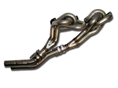

Real Headers, yeah man. Better to reach the center nuts from under than over. Hard, one flat at a time, but doable. A very thin wrench helps.

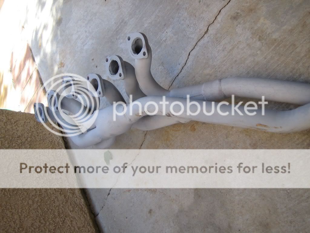

Pipes
