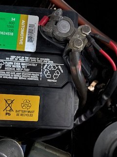

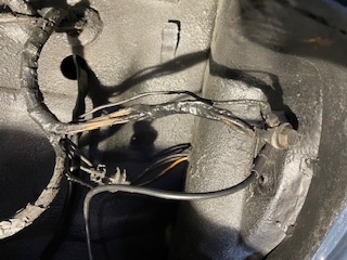

There is a hole behind the left light bucket as seen here. On the other side it is along the battery. I ran the 2 power lines to the battery through this hole, around the side of the battery (between battery and can relays) and to the positive cable (two red wires as shown).

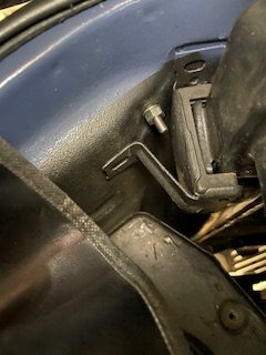

I mounted the relays as shown here through a small hole which is near the radiator support bracket and was already there, I assume it is factory . The setup I used, comes with relays joined by a mounting bracket that has a single hole that fits an M6 bolt.

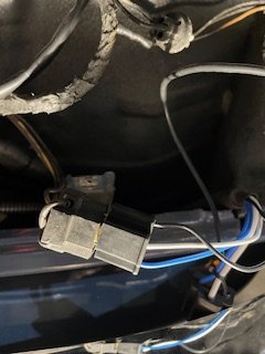

The male connector from the harness plugs into to the pulled female three-pronged connector from the left H4 headlight. One of the three-pronged female connectors from the harness plugs back into the H4 headlight, ground wire to the usual location where the sidemarker light is ground to.

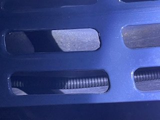

I ran the wiring for the passenger light below the radiator and through this front cowl that has an opening on both sides of the car, then behind the right light bucket. This line has only a three-pronged female connector that plugs in to the H4 light and a ground wire that goes to the right sidemarker ground. The old female connector from the H4 light gets taped off and just sits behind the light bucket. Done.
