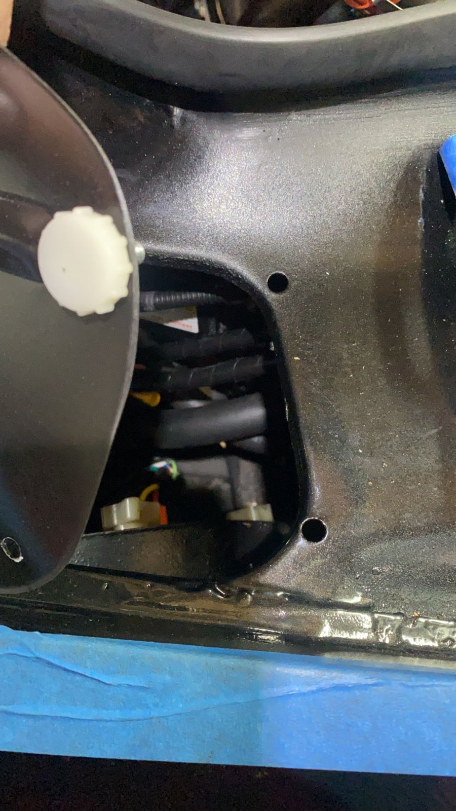

can someone tell me how the headlights cover are fixed to the body?
I have the white screws but no nuts on the body
thanks
THERE IS SUPPOSED TO BE INSET NUTS UNDER THE FRONT NOSE PIECE IF THEY ARE NOT THE JUST DRILL OUT THE
PATTERN AND NUTS BELOW YOU COULD SET THE NUTS WITH LIQUID STEEL
AND THEY WILL BE THERE FOREVER.
AS THE LIQUID STEEL IS VERY FLUID PUT THE NUT IN PLACE AND HOLD IT WITH VISE GRIPS
IT WILL HARDEN ENOUGH IN ABOUT 20 MINUTES.-
