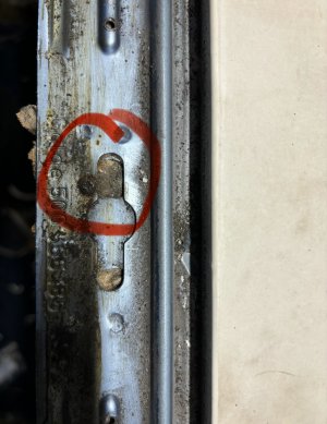

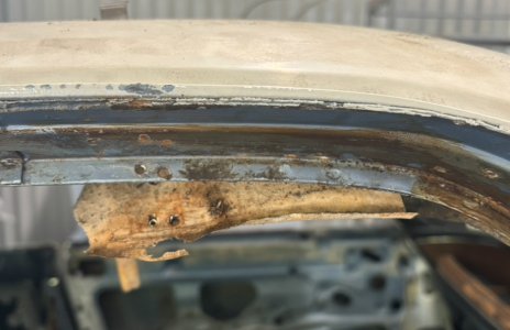

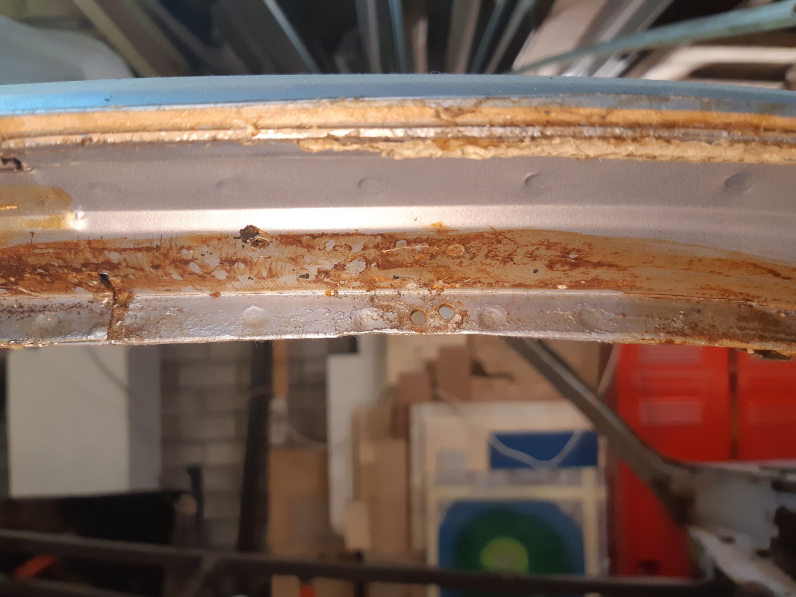

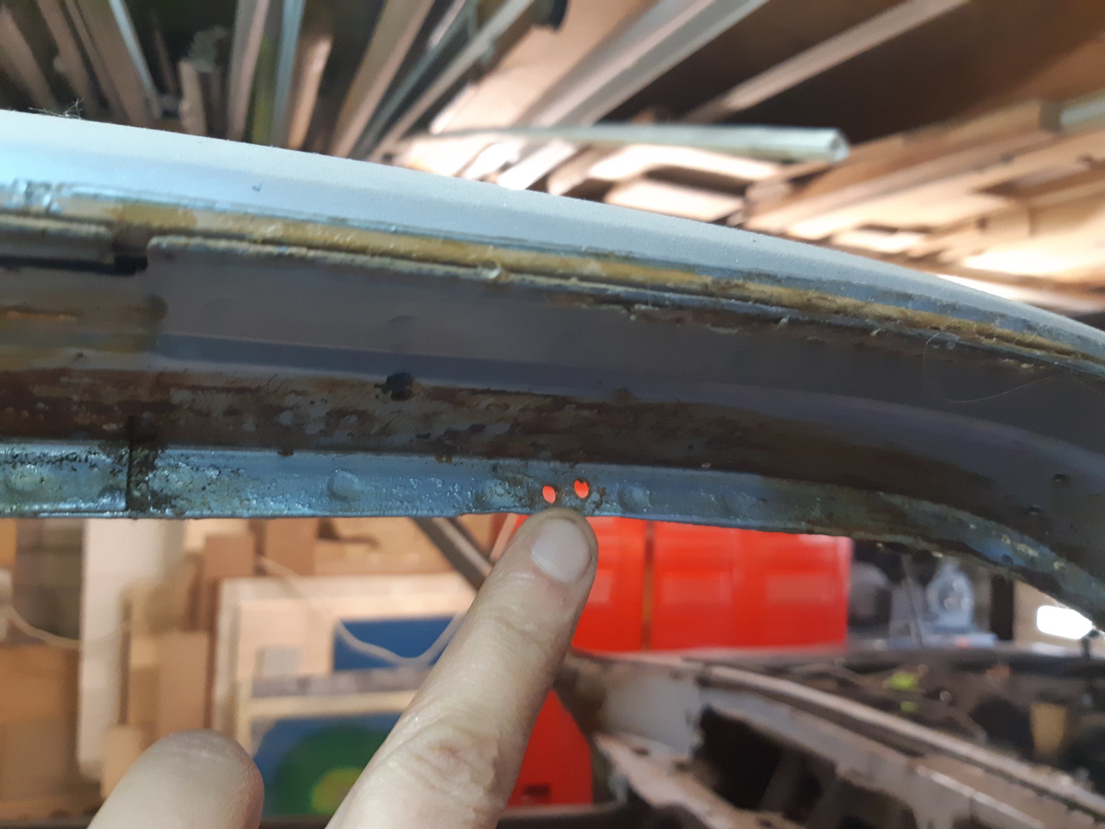

The headliner, that is the front moulded part for a non sunroof car, has 4 hidden brass pins (rivets) that are located under the door rubber, at the roof line. These are the tricky ones to find as they are tiny and have flat heads. You will have to drill them out and replace them with something with a really flat head to not interfere with the door rubber.

The headliner, that is the front moulded part, has 4 hidden brass pins (rivits) that are located under the door rubber, at the roof line. These are the tricky ones to find. You will have to drill the out and replace them with something with a really flat head to not interfere with the rubber.
Grateful, thank you Erik

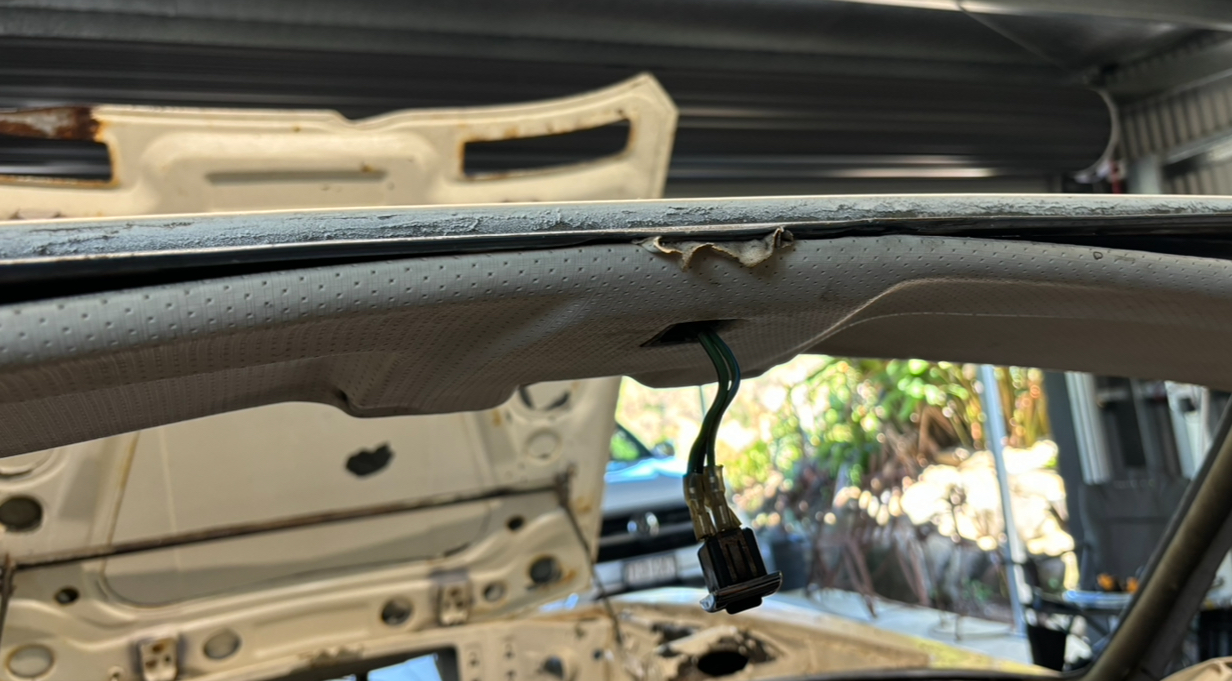

Anyone know how the front centre headliner section is held in place? It's an electric sunroof version.

@scottau ; are there no flat head rivets underneath the rubber at the top of the door openings?
As you have a sunroof it may be different though, my car doesn't have a sunroof.

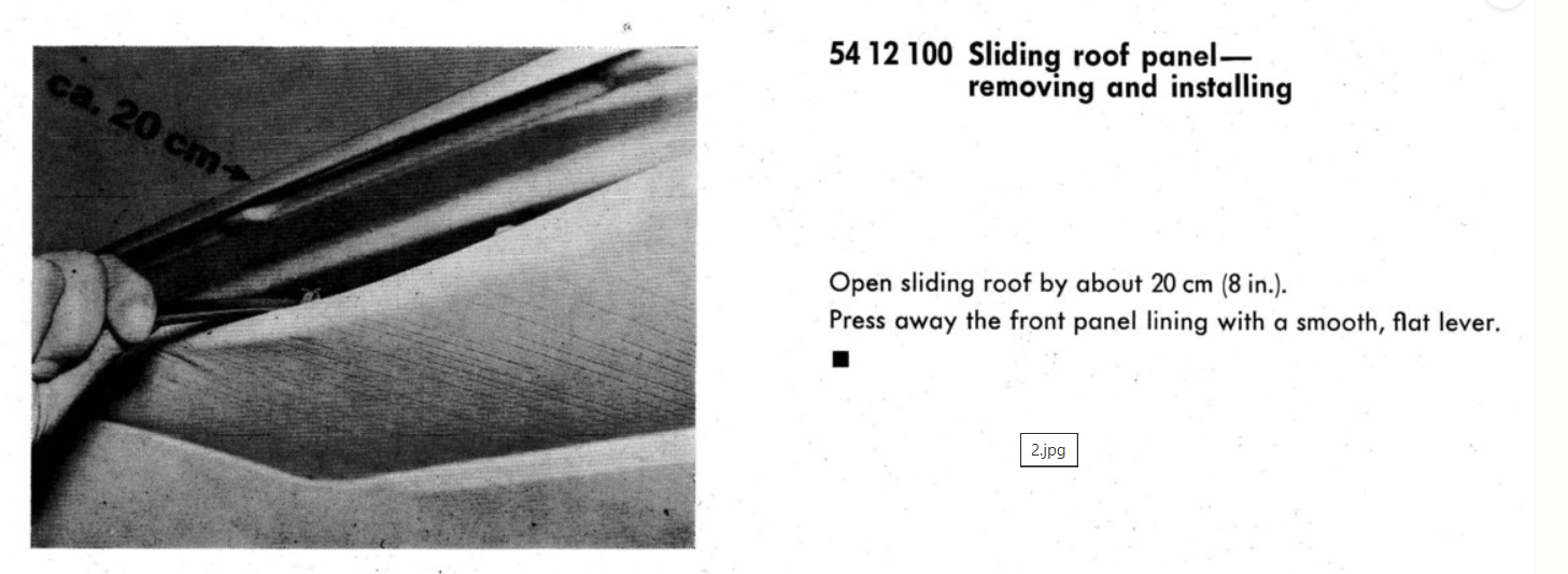

Googling our site i found this reference from the BMW manual: would this be how your panel is attached; with clips that just pry off? I think the pic shows a screwdirver poking in between the roof reinforcement and the front vinyl covered roof part above the sunvisors.
Link (thanks to @aearch ): https://e9coupe.com/forum/threads/wtb-sunroof-mechanism-bits.27717/post-218019

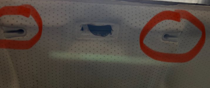

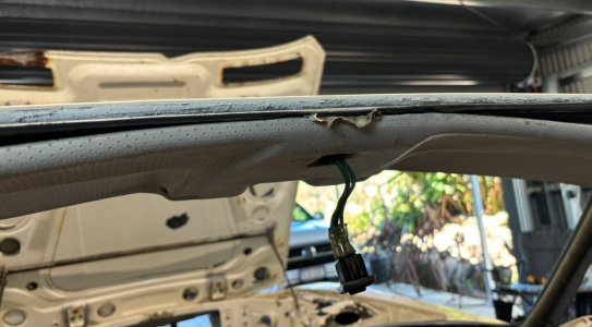

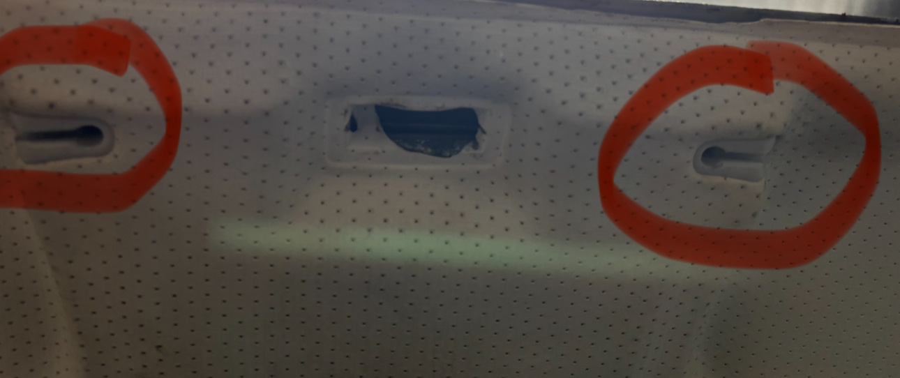

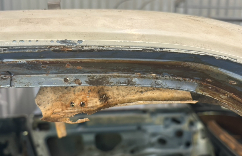

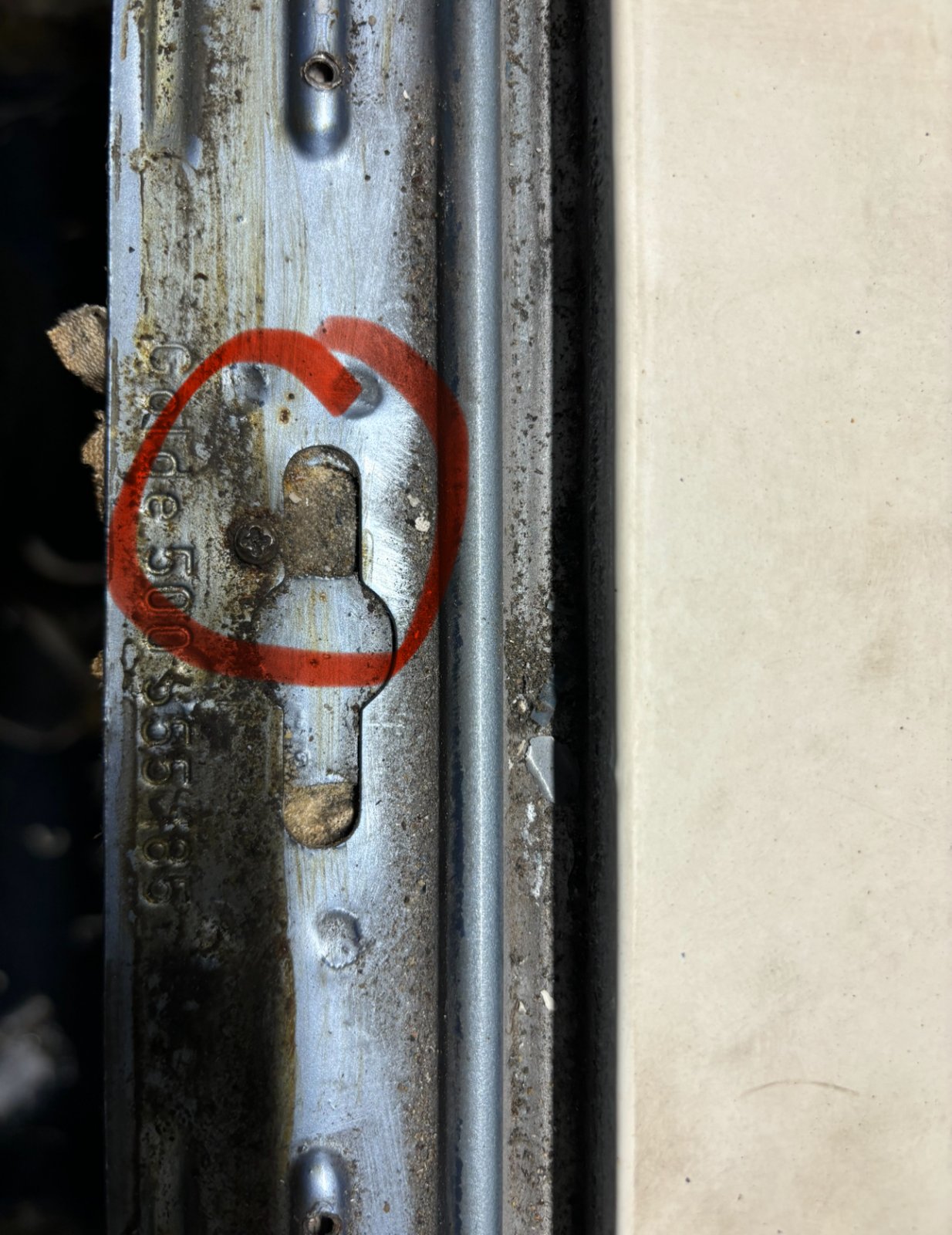

Thanks @eriknetherlands i managed to work it out in the end, three descreet screws holding the centre section of the front headliner in place, one through the top of the sunroof and two up through the sunvisor clips
