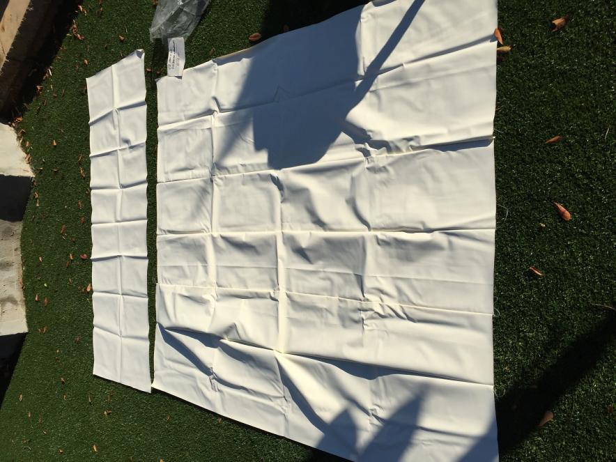

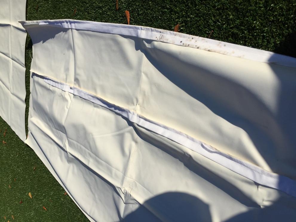

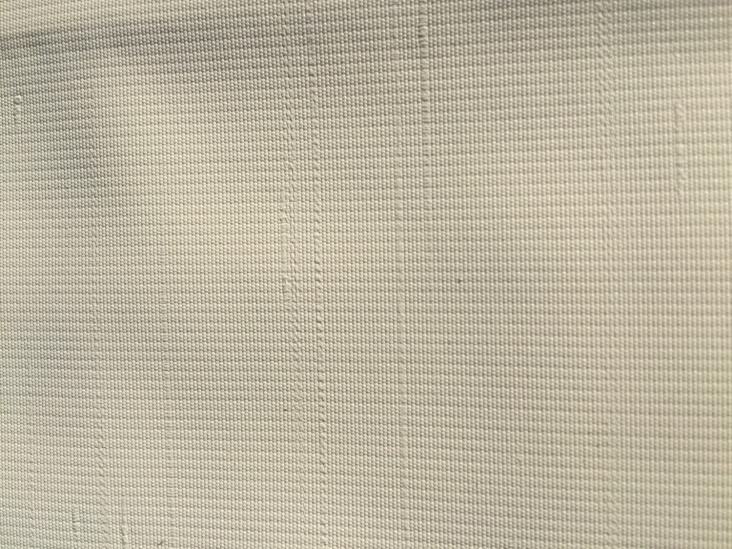

Here are a few pictures of the headliner I bought from Murray. It is two pieces, presumable one for the front portion where the windshield goes. It has the slots where the bows slide in for hanging.
From what I can tell there is no "diamond" hole pattern. It's a fairly uniform, almost linen like texture to it. Unfortunately by the time I got around to installing it, Murray was too sick to be bothered and I took the advice of my trim guy and bought material from La Jolla. I suppose I've hung on to it mainly as a souvenir of Murray and am happy to continue to do that if we can't determine whether it's like original or not.

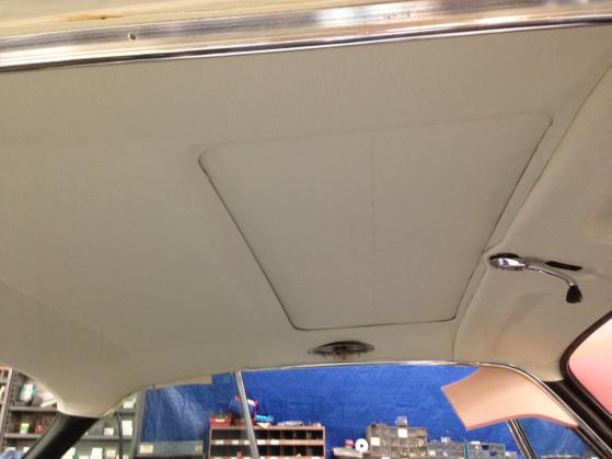

I did find a picture I took of my headliner installed. It's also attached.
