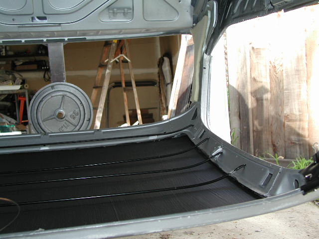

These pictures aren't the greatest, but you can see that the end of each wire curves sharply in the direction opposite that of the main bow:
This allows the wire to enter the openings in the roof frame perpendicular to the sheet metal (shown below). You can also get an idea of the relative sizes of the wires.

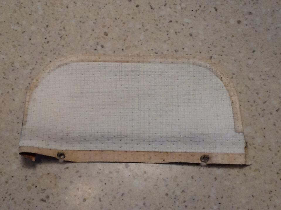

IIRC, the front wires were nearly identical. The 3rd & 4th wires were unique. What is not shown in these pictures are the plastic grommet pieces that fit into the sheet metal holes and receive the ends of the wires. Without the grommets the wires are a very sloppy fit.

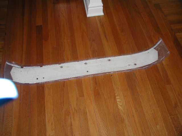

The curved piece is plywood, shown below being relaminated in a vacuum bag.

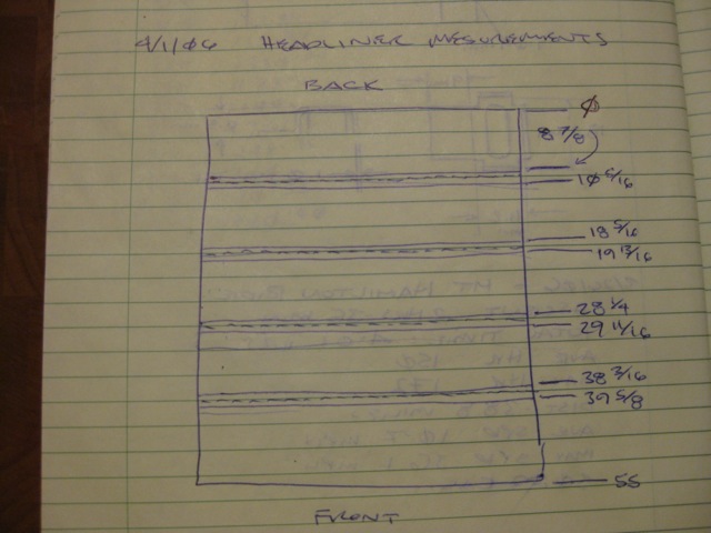

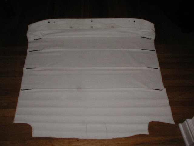

I'm making a template of the headliner and wondered if you remember if the four pleats for the roof bows are all parallel? The first three (from the front ) definitely are but the fourth appears to have a bend of 1/4 - 1/2" at each end towards the front on the donor headliner I'm tracing from. I doubt this is critical as the bows put the cloth under tension to suit the material and form.
All of the seams are straight. The wires take care of the rest. Decoupe is correct, no wires on the sunroof versions. As of about 5 years ago, I'd sewn 5 non-sunroof headliners & 1 sun roof headliner subcontracting for Fechner Restorations. Since the material has become available again everything has gone quiet. Below is the template that I always used. You need to cut away the loops at the ends. You can see most of the from your old headliner, or from my headliner page.
