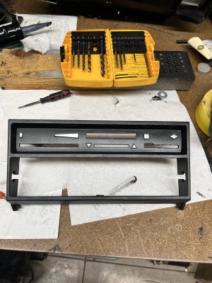

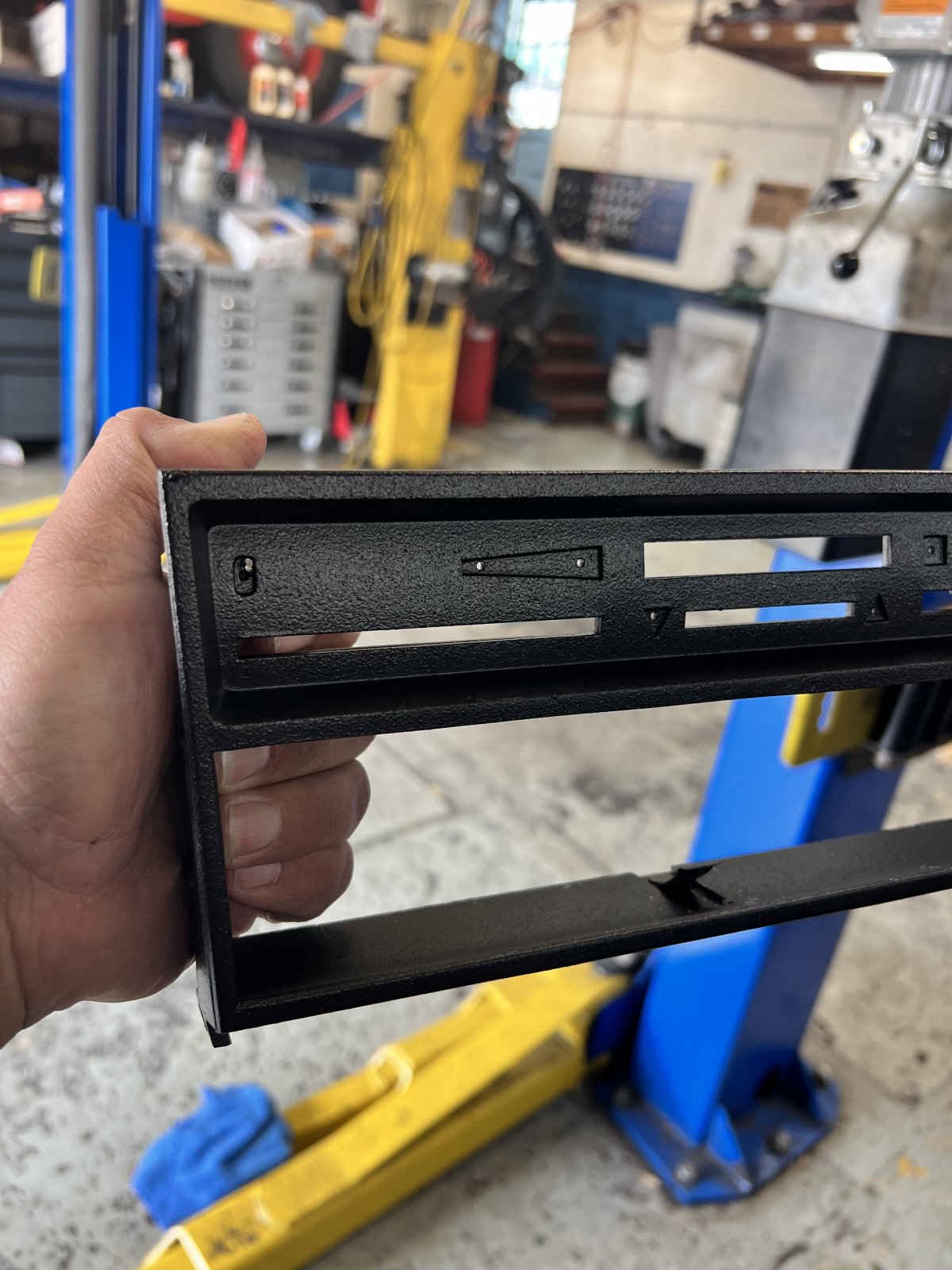

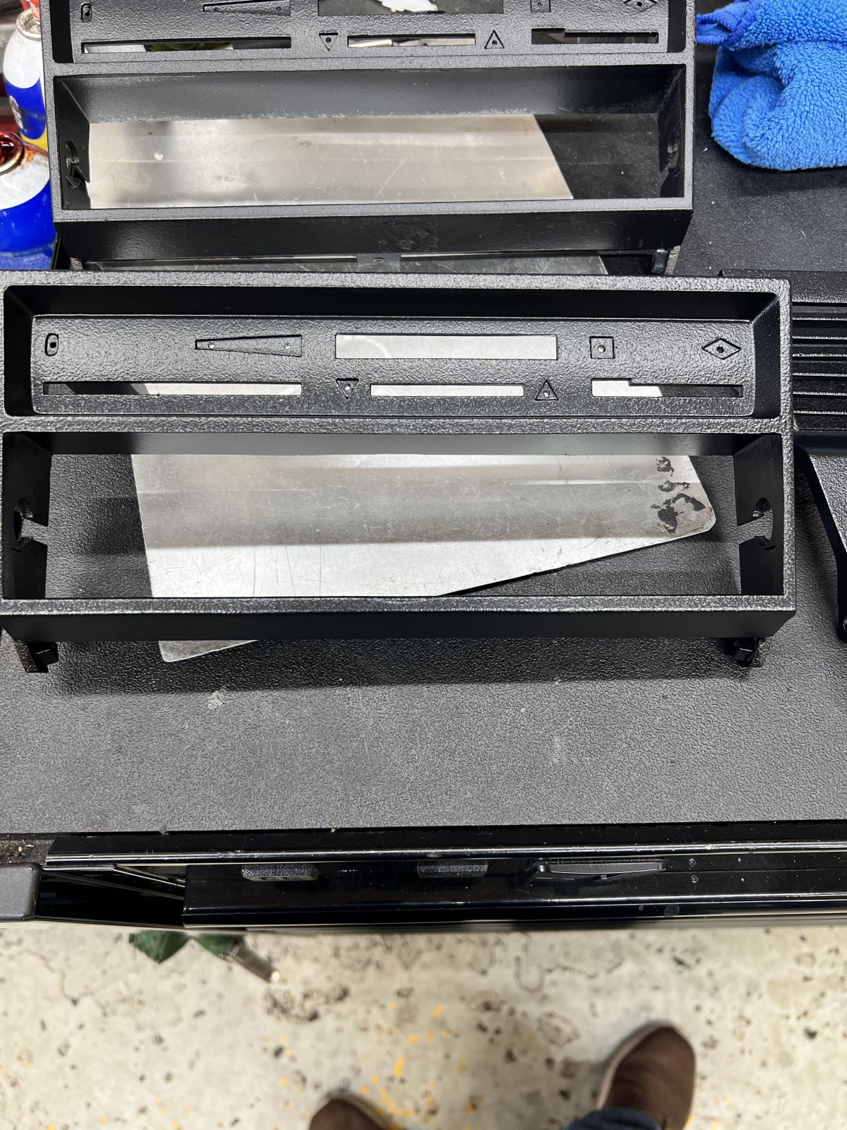

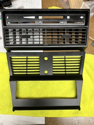

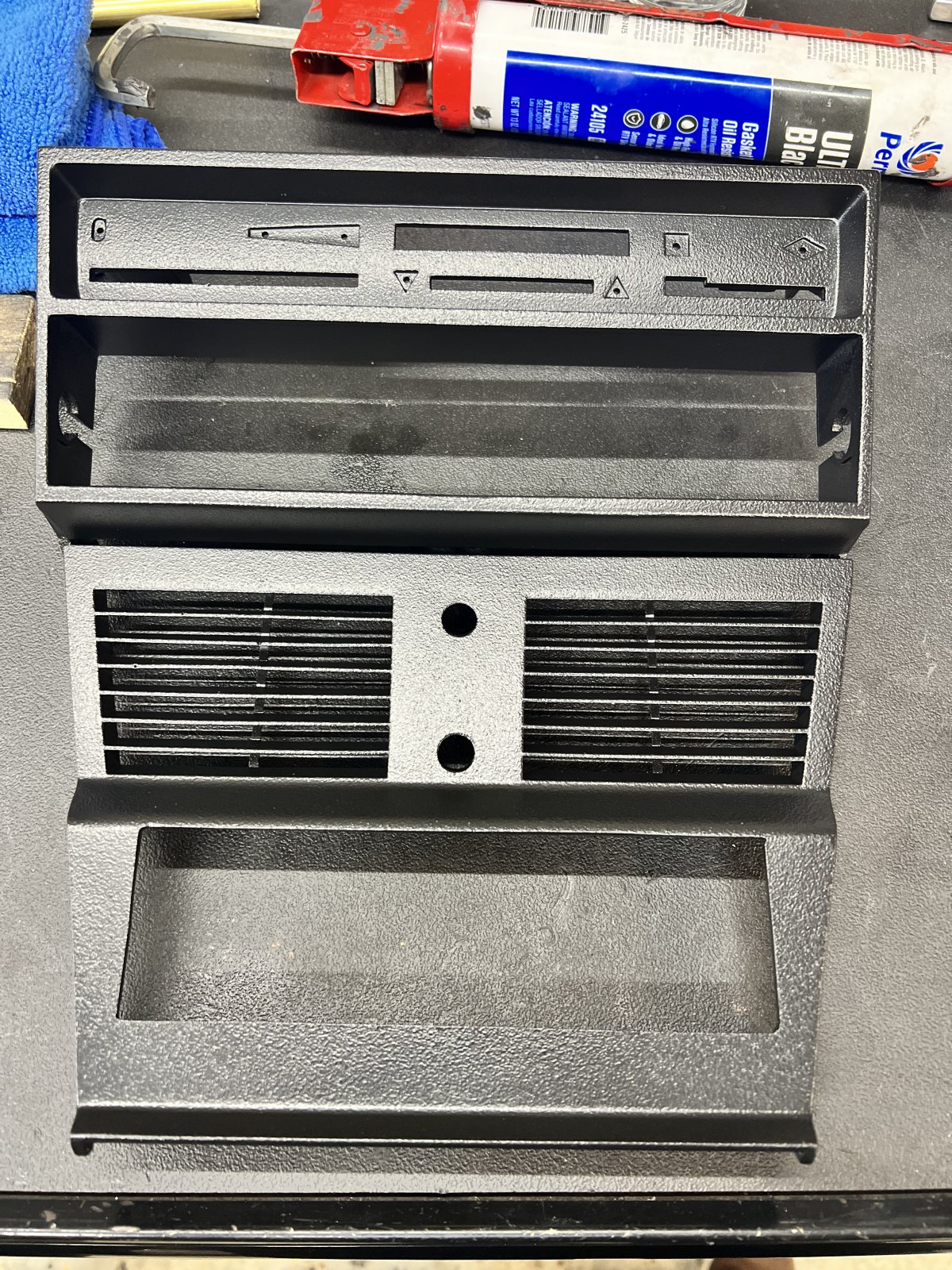

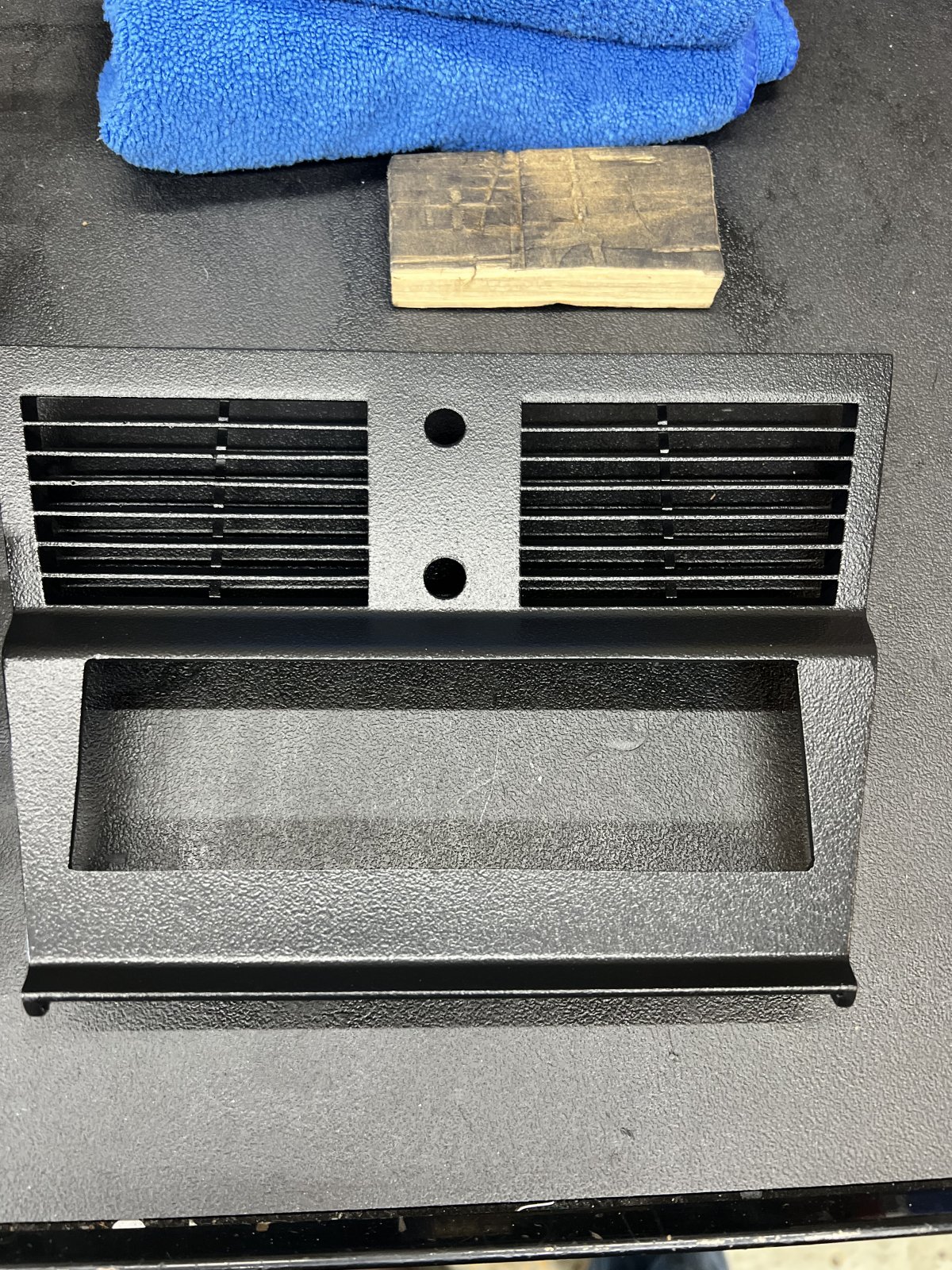

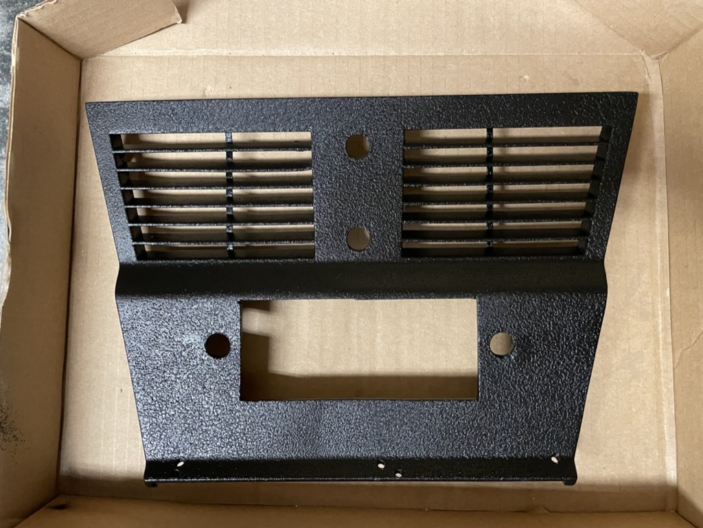

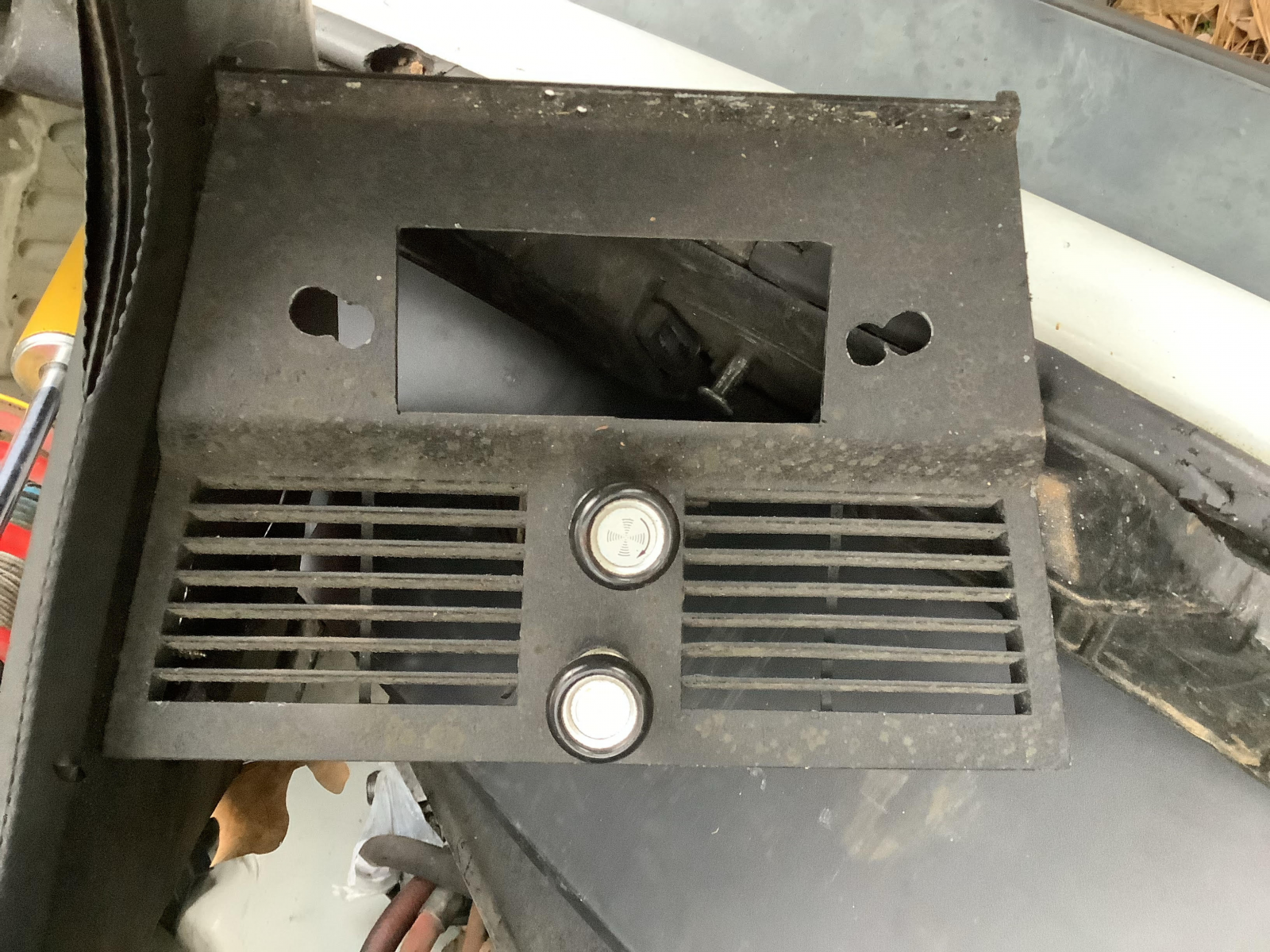

So I decided to experiment with texture coatings to see if I could get close to the original texture of the heater and a/c panels. From what I’ve seen, texture varies a bit between cars, so this may not match what you have; but I feel that it looks pretty good and is a good solution for beautifying the chipped panels.

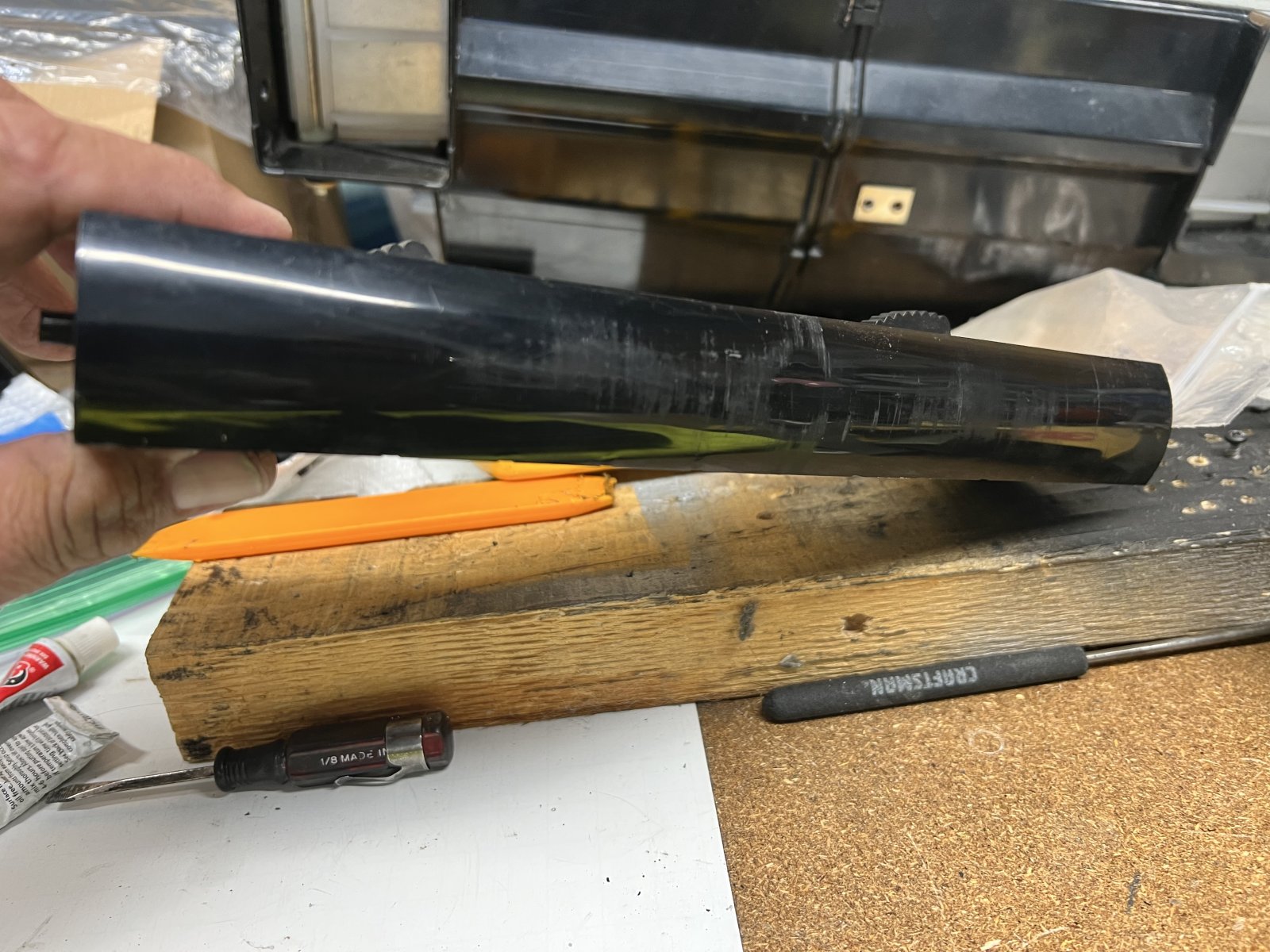

I media blasted the panels and made sure they were nice and clean using brake cleaner. It’s still a bit cold here so I used a heat gun to warm up the cans of texture coating, paint and also the panels. Most paint products recommend applying in a 70 or so degree environment with project and paint also around the same temperature.

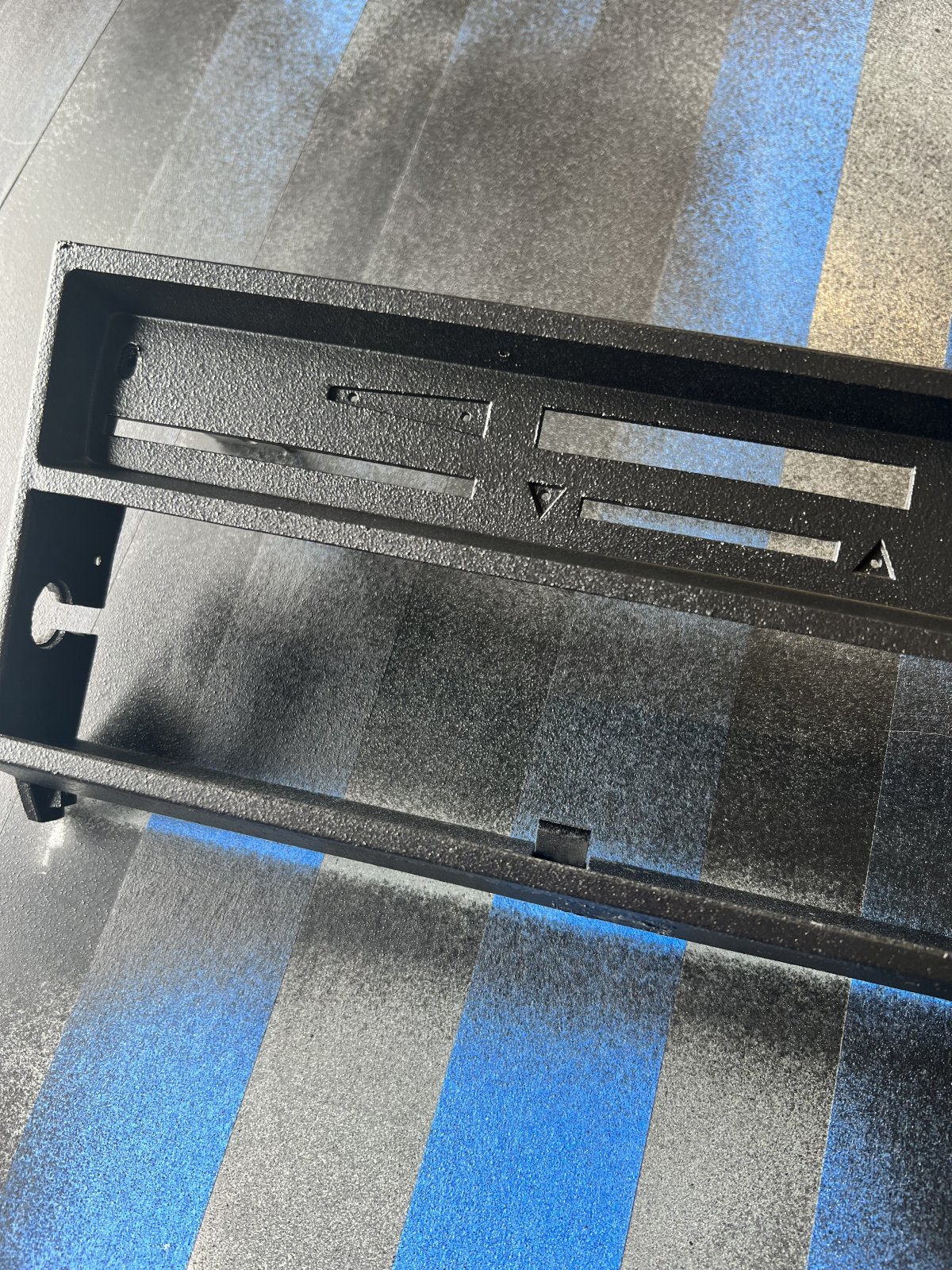

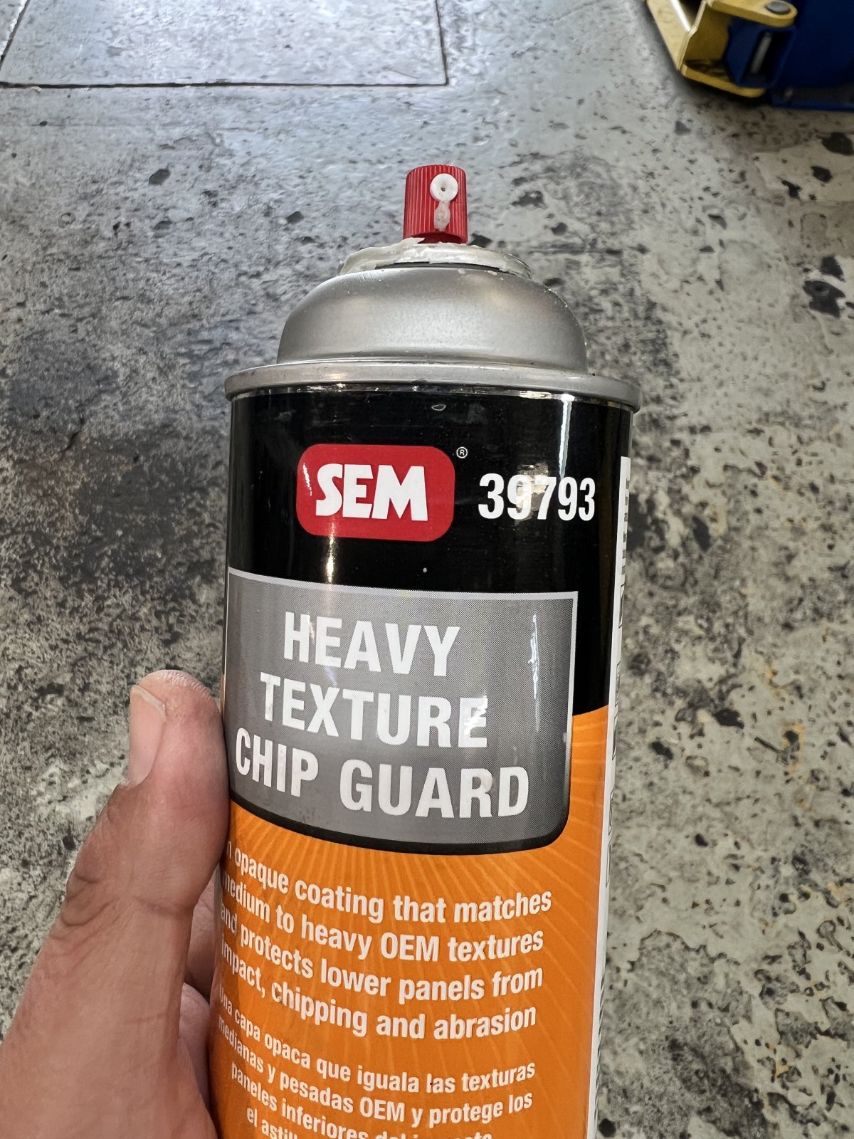

It is important to do some test runs to establish a technique. I tried 7 different products using different methods to see which one yielded the best results. This was done on a big drip pan from Napa auto. I taped several sections so that it would be easy to identify the results.

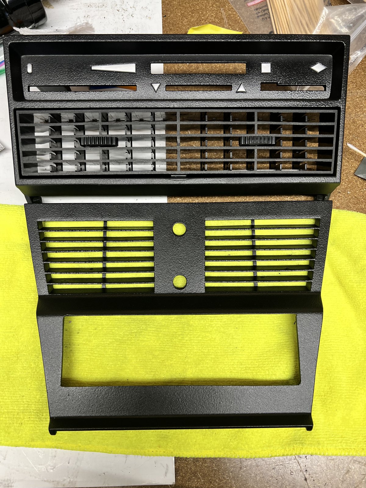

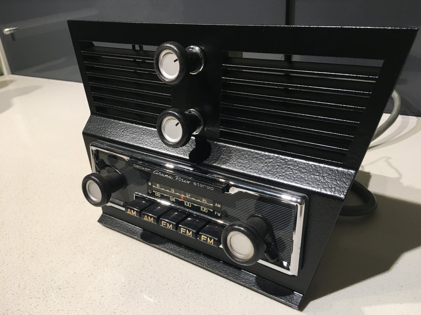

I ended up using SEM Heavy Texture Chip Guard and SEM Trim Black paint.
Here are the results. I’m quite happy with the end result.

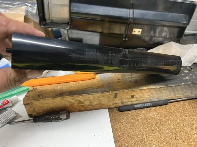

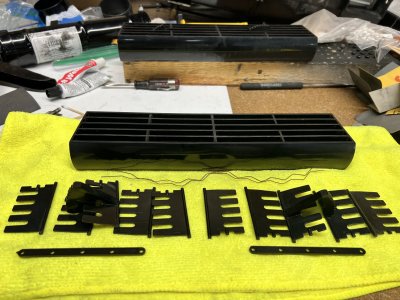

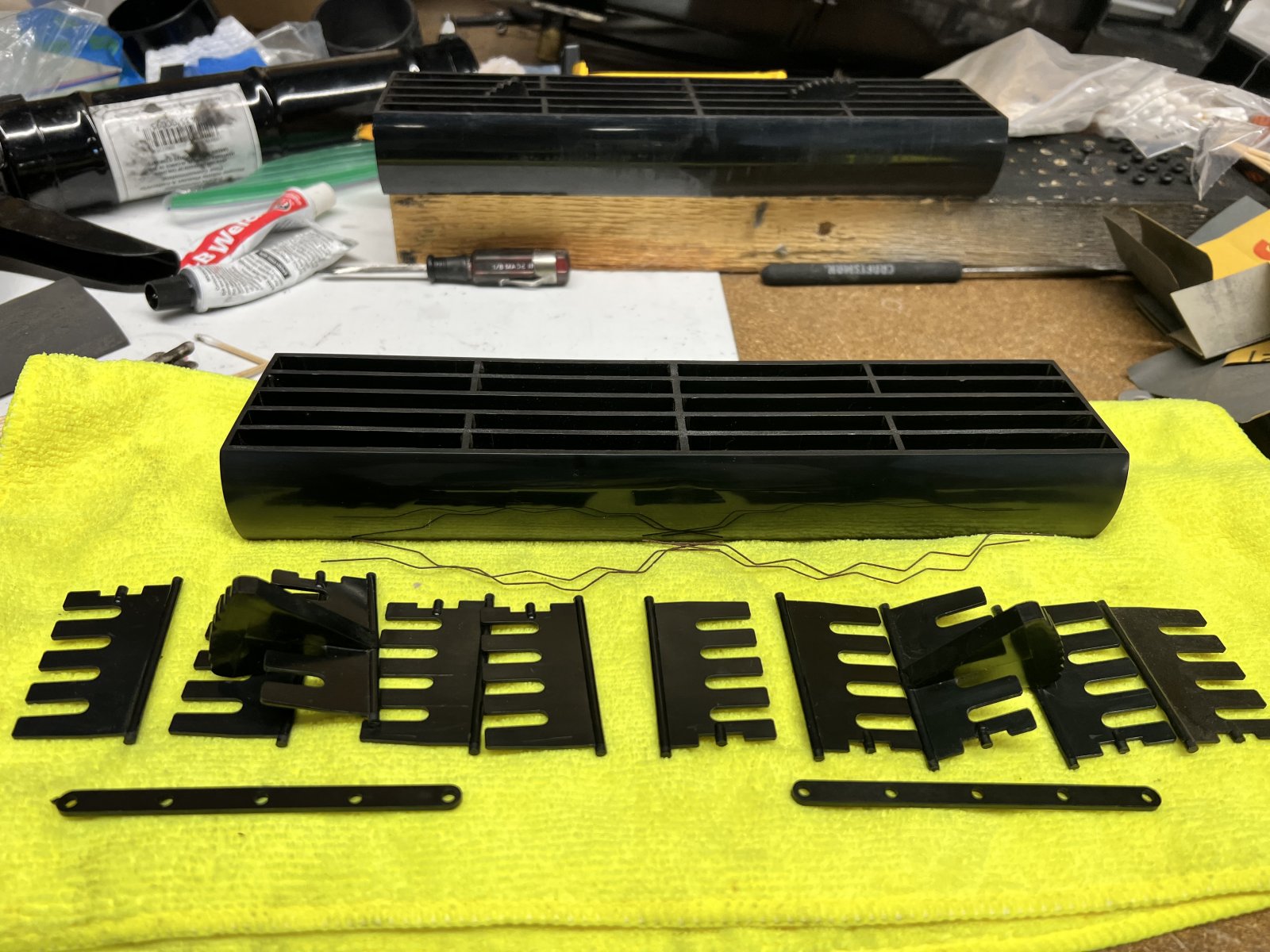

Icons and vent installed. Vent was disassembled, cleaned and the scratches sanded off.

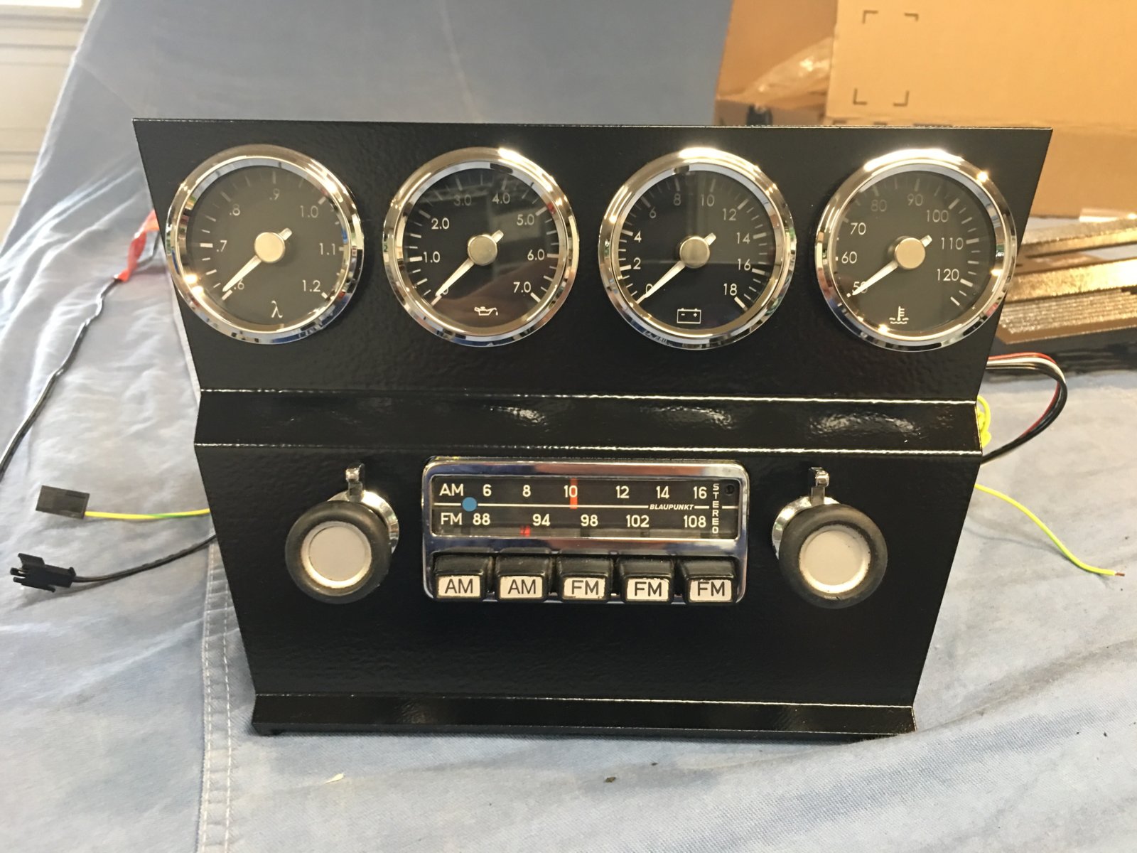

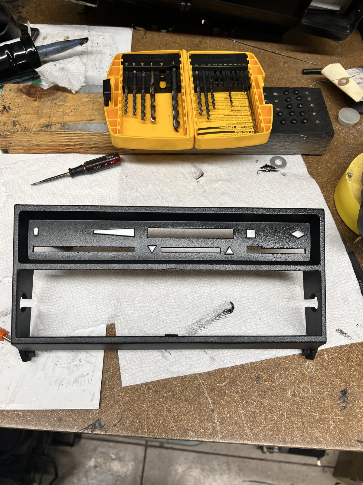

A number of factory face plates have smooth texture and flat paint. It differs from the e3 to the e9 also. After experimenting I ultimately landed on a base of Rustoleum hammered with a top coat of satin black.
Depending on lighting and in this case reflection, satin can look a little too glossy. This is my gaudy gage panel.
The heater controls, and especially the steering column have far more texture. I’ll probably go with @OCCoupe ’s approach for the heater and something more textured (more like a splatter) on the column.
