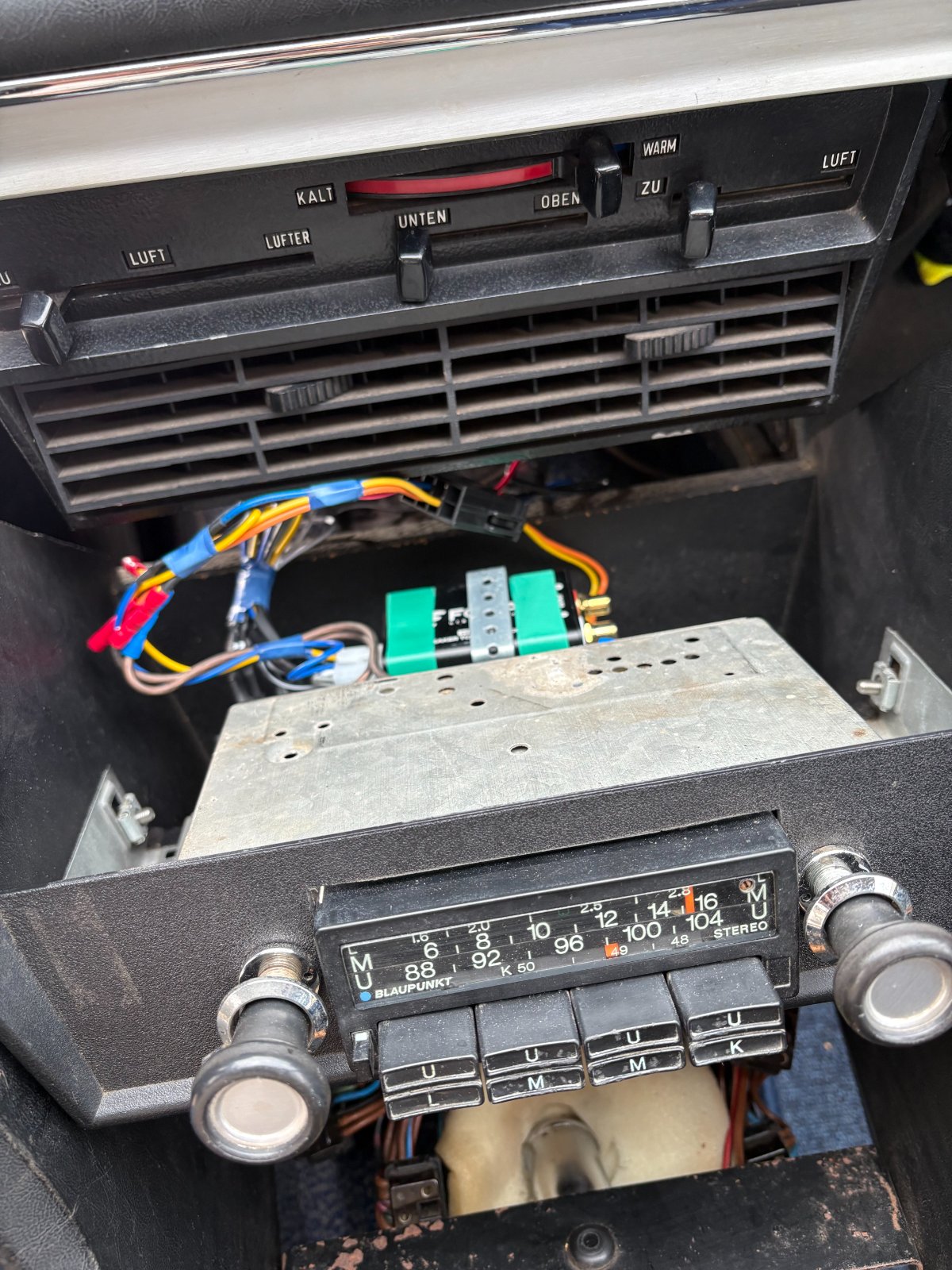

need HElp , im getting no power to the ac heater blower ive traced it to the wires coming into the heater control panel , the heater control panel switches were cleaned and they arent getting any power , these wires go under the dash pretty deep and im having trouble finding where they go in order to further test, this is for the heater blower not the ac , fuse is good and have the correct fuse , blower motor is brand new bench tested , its just not getting voltage, any help is apreciated!!

hey so its 1979 bmw 528 i and i just tested with power at the fuse everything works great including the fan speed switch i just cleaned, so now the question is why no power at the fuse , thanks for the help by the way

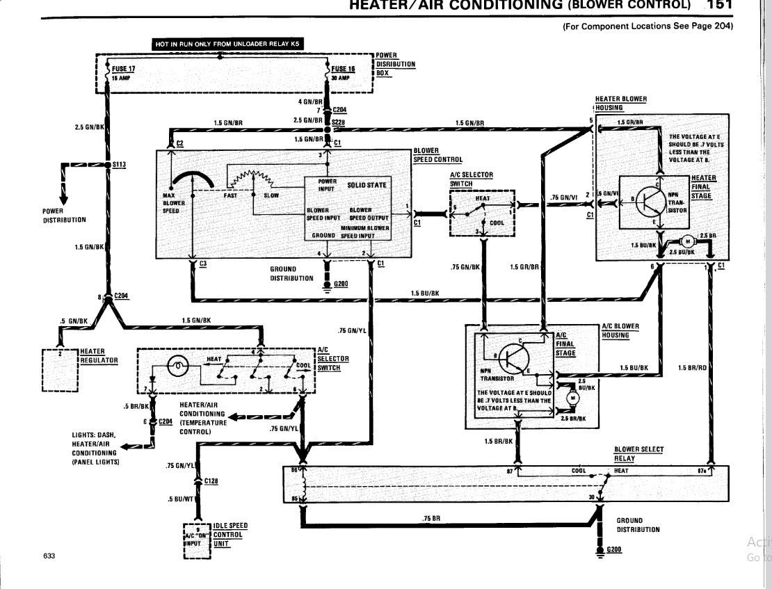

I will be watching this thread as my e24 has no power to the blower fan for heat and staring the the electrical diagram has not helped. The E24 has relays, not sure about the E12. This is from an 84 633, not e12-based but perhaps helpful.
Hey so what I did was I checked power at the fuse and I had no power there so I opened up the fuse box and there wasn’t even a power feed ? But some people say that this relay has melted fuse boxes, at least in e12s it has, I’ve seen people fix the wire at the glove box and be ok, I’d also check and maybe clean your fan speed switch it’s a bit of a job but mine was super gunky

If I am following this thread correctly, you don't have power at the fuse to the heater blower motor. Upstream from there would be the unloader relay. The unloader relay shuts down heater (and a/c) fan when you go to start the car. It is located under the dash on the inside of the left front fender.
