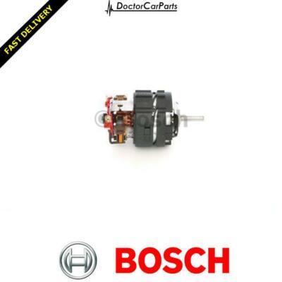

The motors are available off the net – and are an easy replacement- but the cap that the old one has is not on the new one I got.
And from mem – the plastic out cover is removed before fitting.
Find many great new & used options and get the best deals for Heater Blower Motor FOR BMW E9 71->76 3.0 M30B30 Petrol Coupe Bosch at the best online prices at eBay! Free delivery for many products.
It's a Bosch part that was available as a replacement part for about 46 euro's up to -at least 2 years ago-
the part number is here on teh ofrum somewhere. lookup the part number and then do a search - you'll find it.
