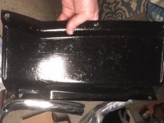

What was the original color of this and of the articulating arm set up for the wipers? Was it gloss or other. I am redoing mine so want to restore it to OEM.

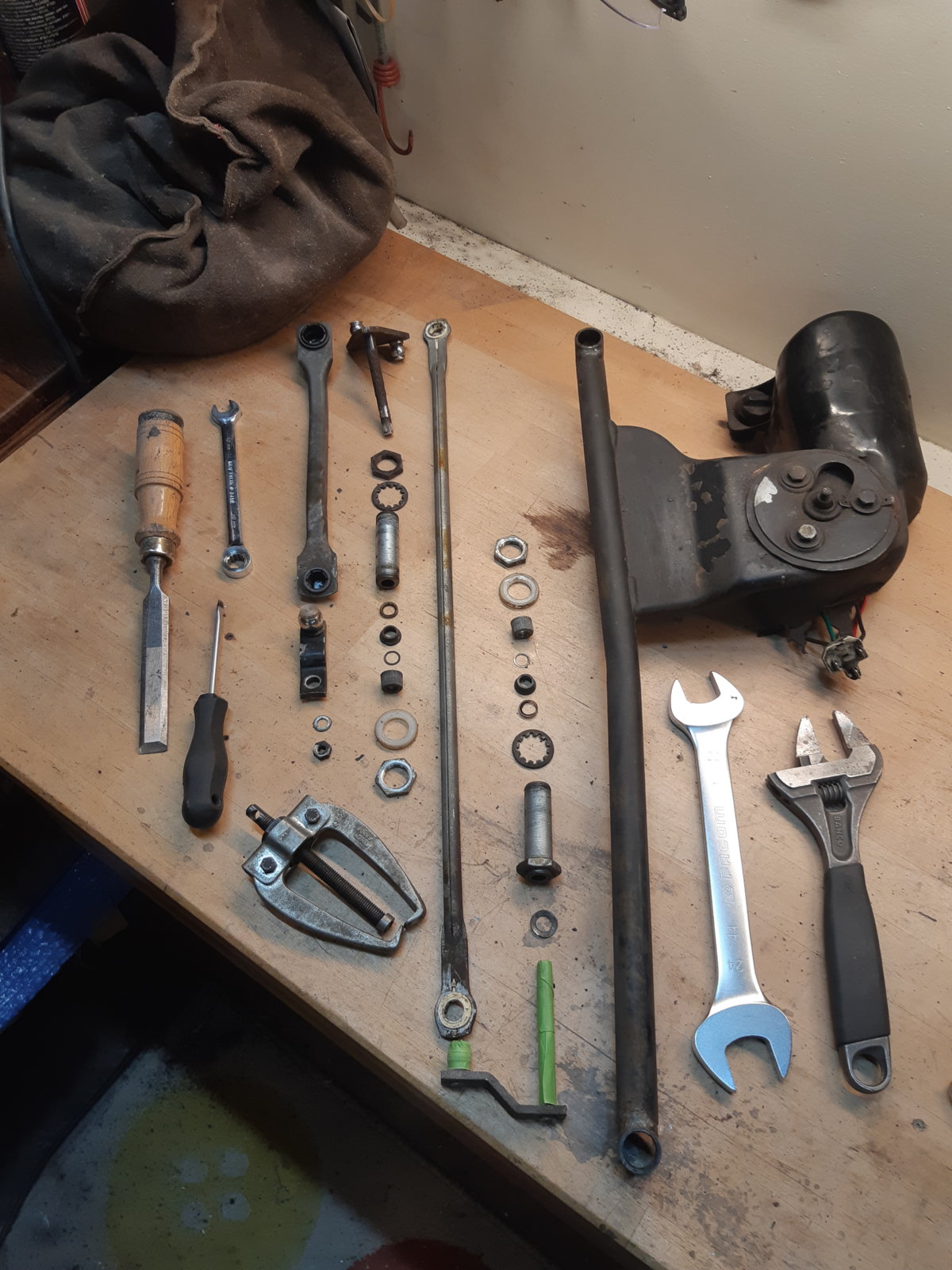

here's a pic of how the wiper mechanism came out of my car. Two of the parts on my car were actually matt black over clear zinc, so that would be different to what HB Chris describes. My car has been restored partly before, so it could be a PO's rattle can action.
- large frame black,
- long 50 cm (1,5 foot) round rod clear zinc.
- short u profiled rod ( 15 cm 1/2 foot) matt black paint over clear zinc,
- plates with pivoting pins clear zinc.
- short (5 cm 2 inch) bend steel plate, with 1 ball & other side mounting to motor: matt black paint over clear zinc.

edit: repair manual shows indeed bright zinc parts for the ones that are covered in black paint in my car: HB Chris was right, as always.
And no wiper motor cover by the way, I thought that was e9 std part as well. ...

Cover was done and installed and then John comes along and says "that thing is pitted, why don't you use primer-filler on it". So I have and must say, the stuff works well. Ready to repaint so wanted to get it right since it was gloss. John is keeping me honest on this restoration.
