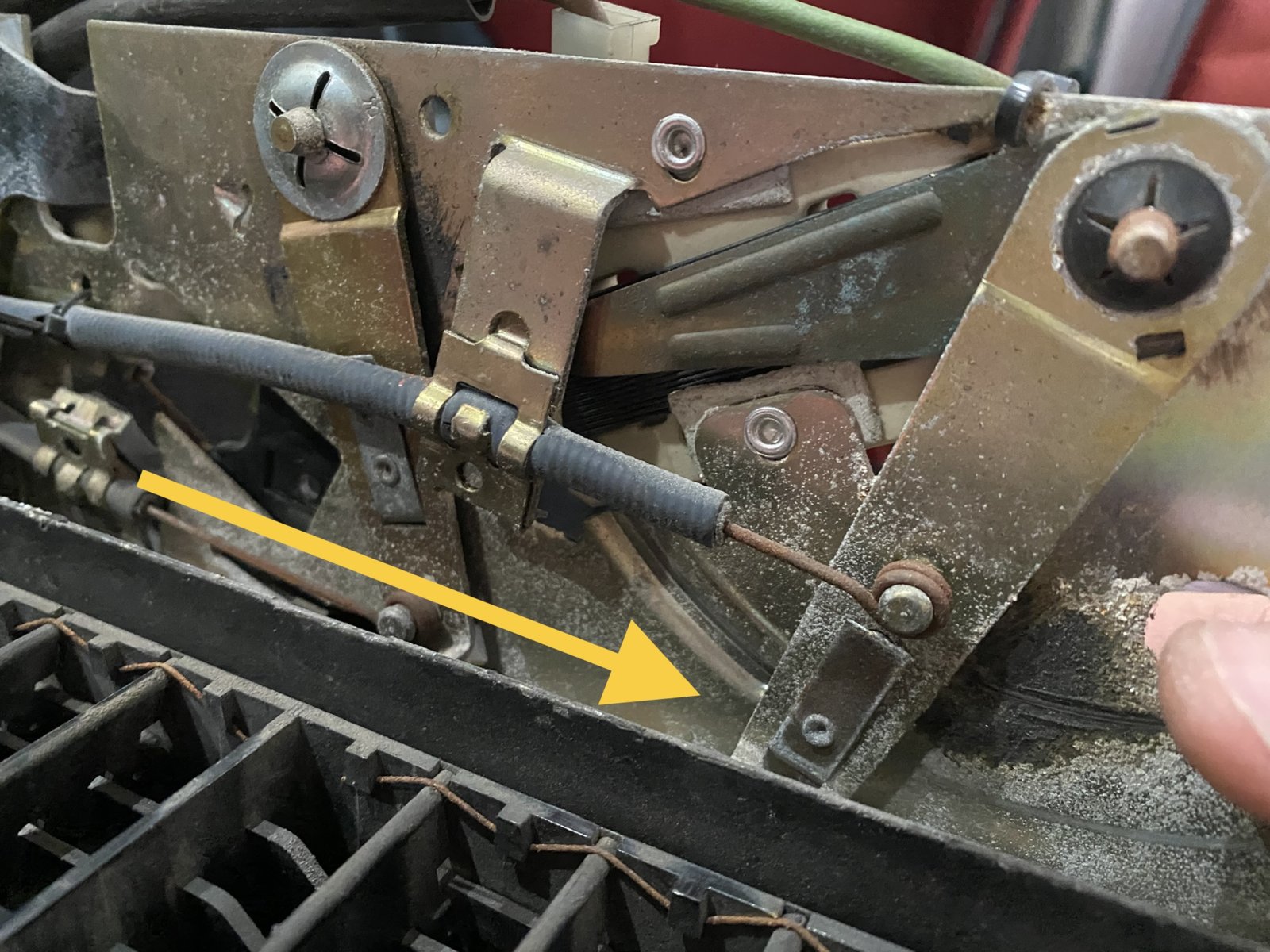

the points mounted at the end of the wiper wasn’t flat on the sliding surface and specially across the coiled wires, the pivot point for the wiper is also showing corrosion built up which is not helping with a good ground And adding to the problem of grounding.

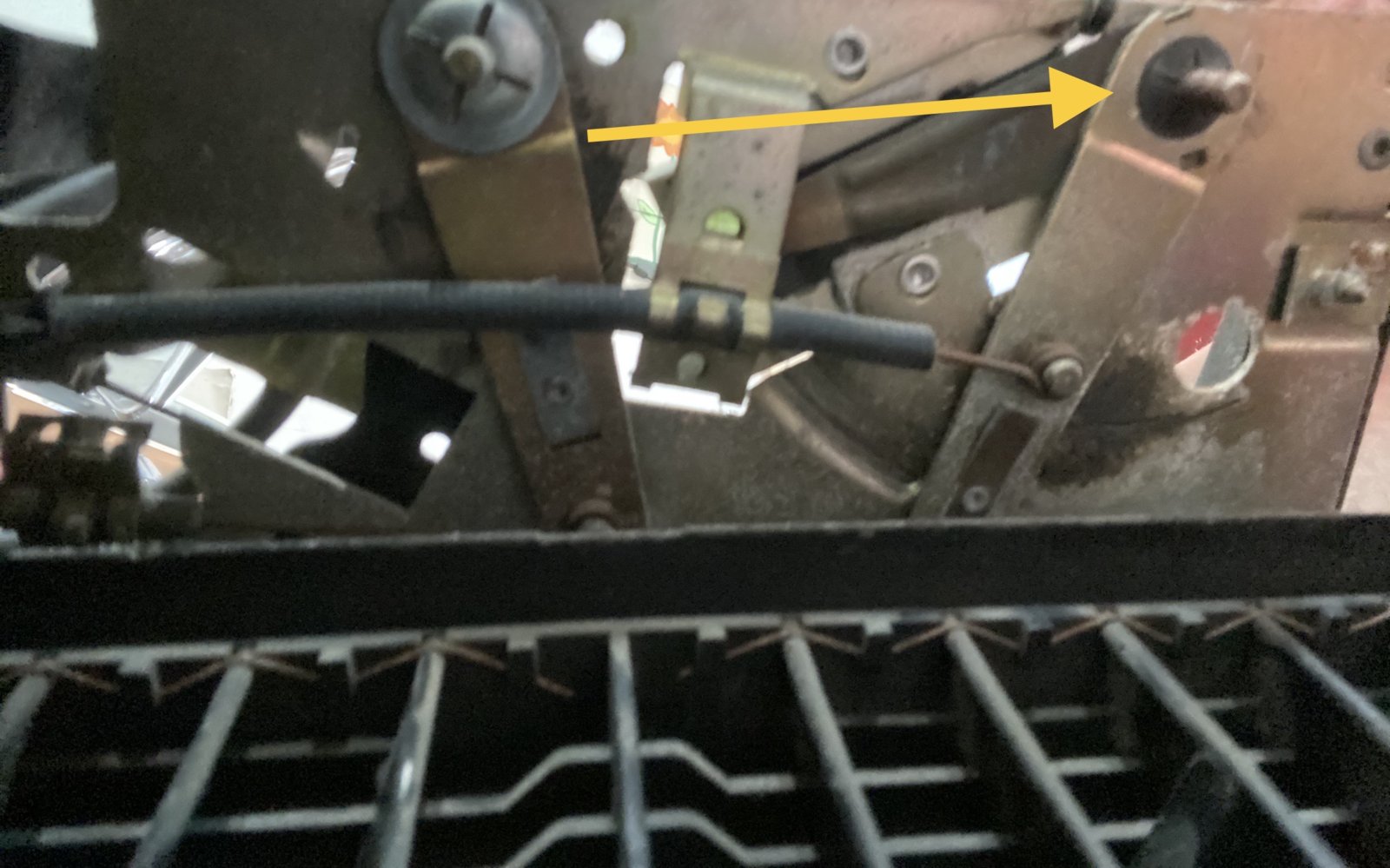

This is the retaining clip that I’m after, I am afraid of mcgivering it, and then it would loose the tension. I’m sure someone here knows exactly where to pick one up :). Just never purchased one.
also, that’s one of the point where corrosion/rust has built up from the current and rubbing of the metal.
I need to remove it and clean up the base and wiper.

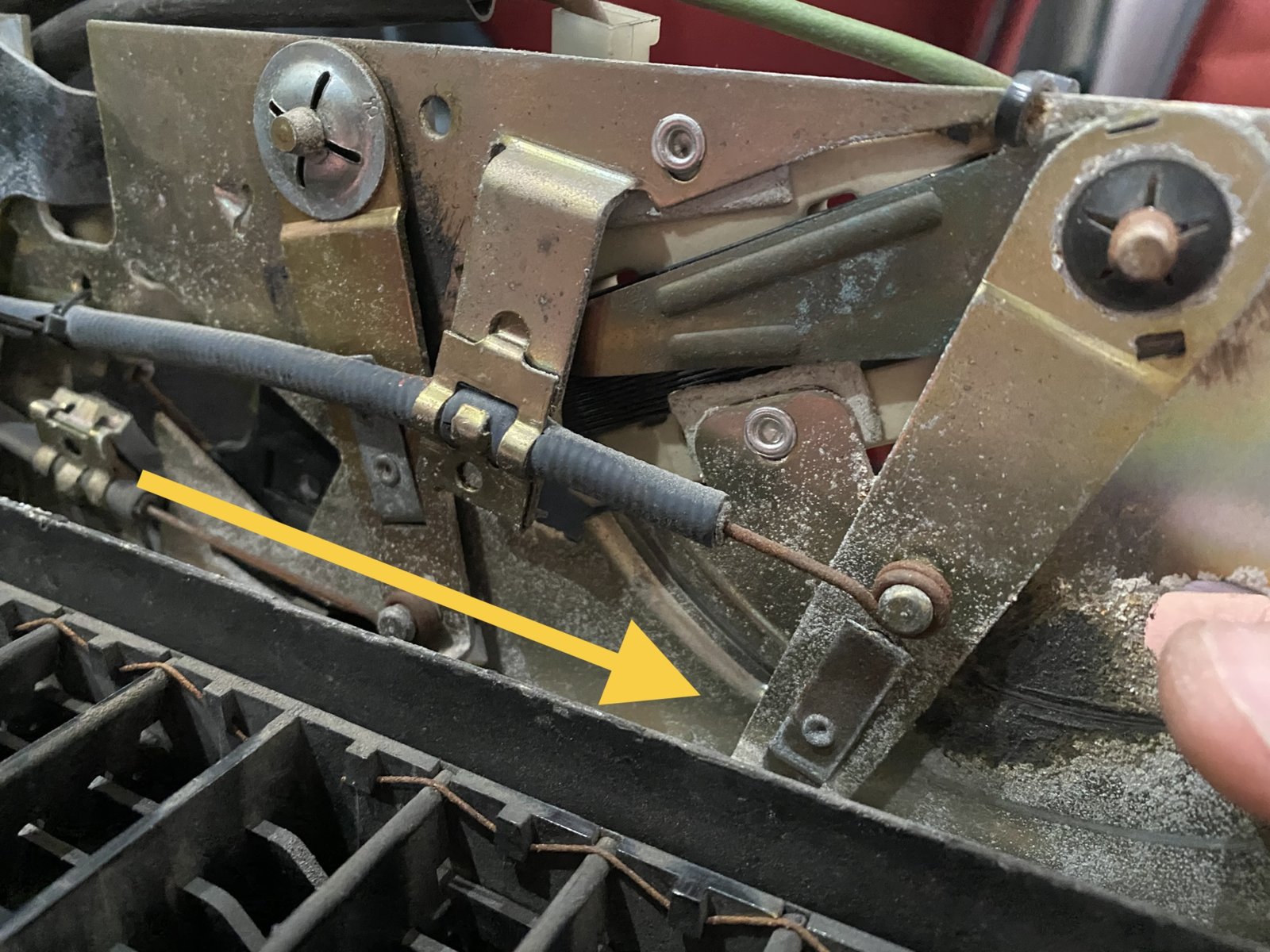

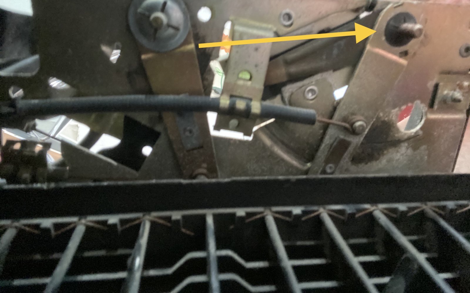

Here’s the retaining clip
Wiper/slide points, first part of the action is mechanical to move the butterfly valve, 2nd part rides over the resistor, and at the end of the throw, has full contact with the ground post and full fan speed.

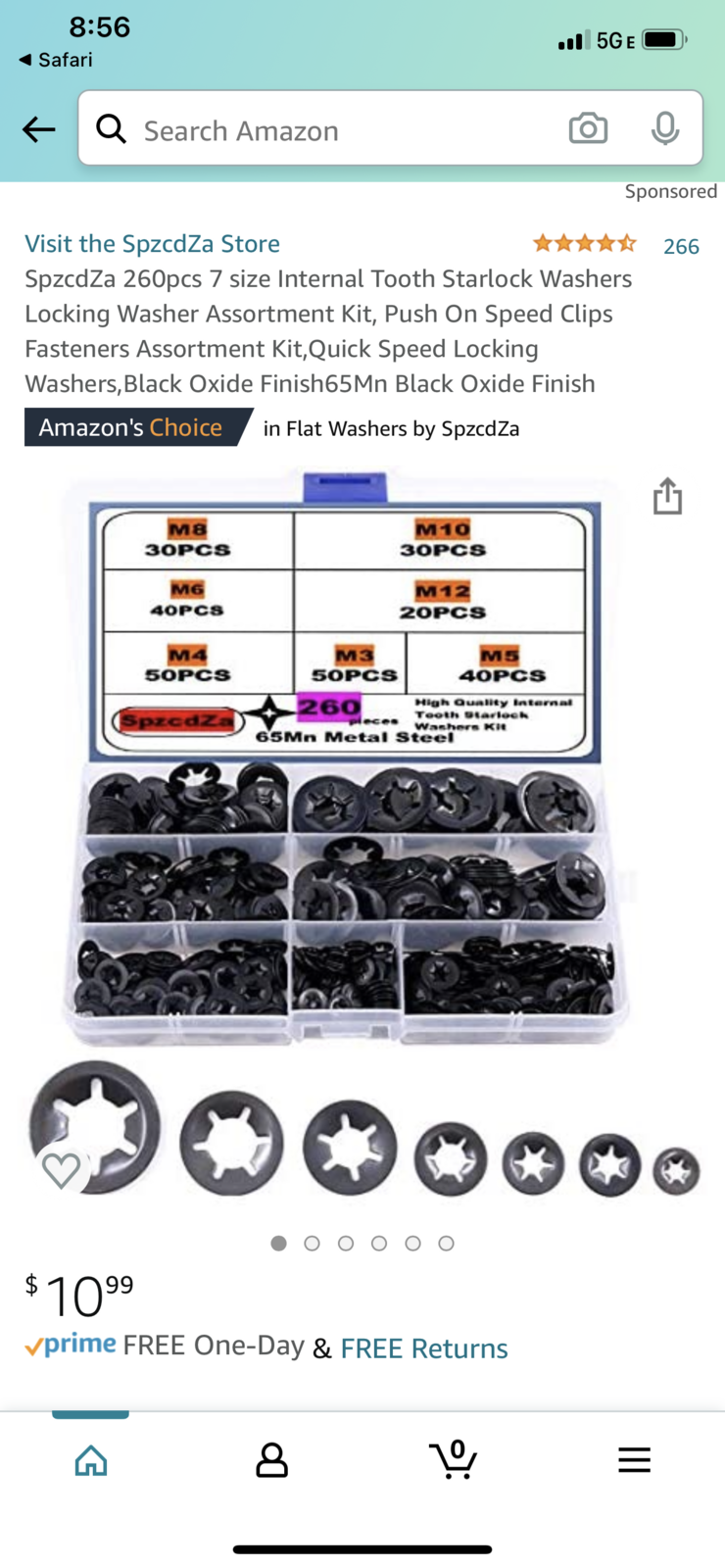

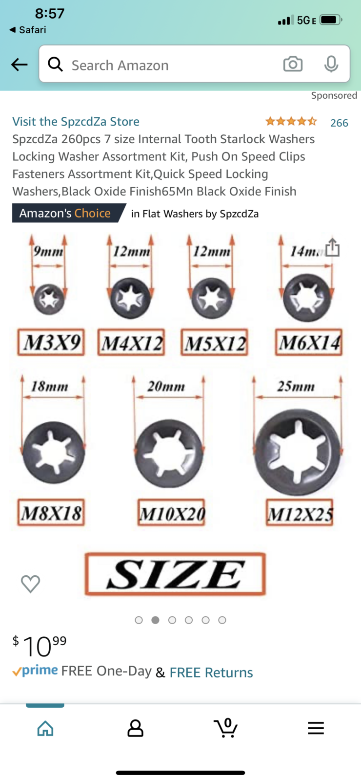

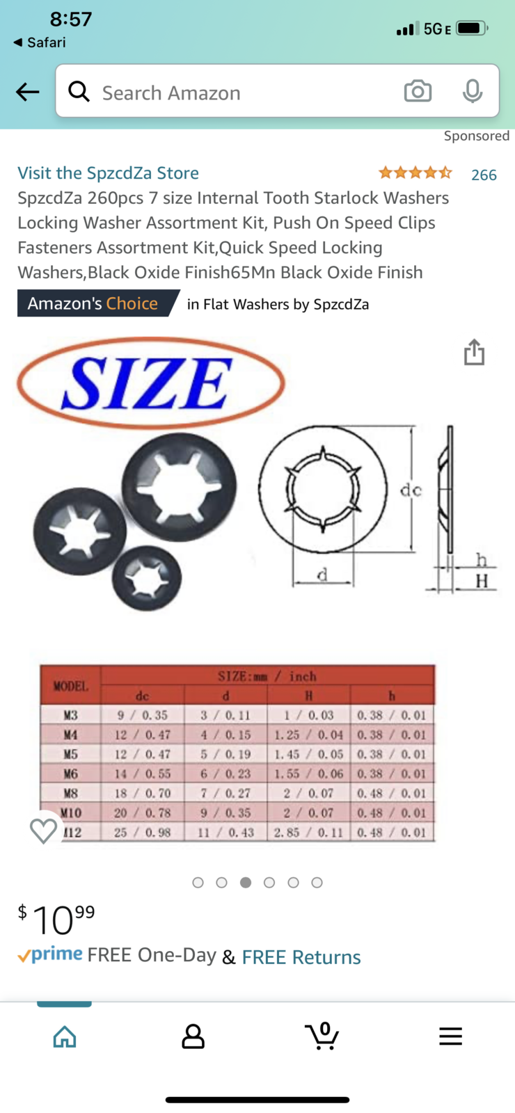

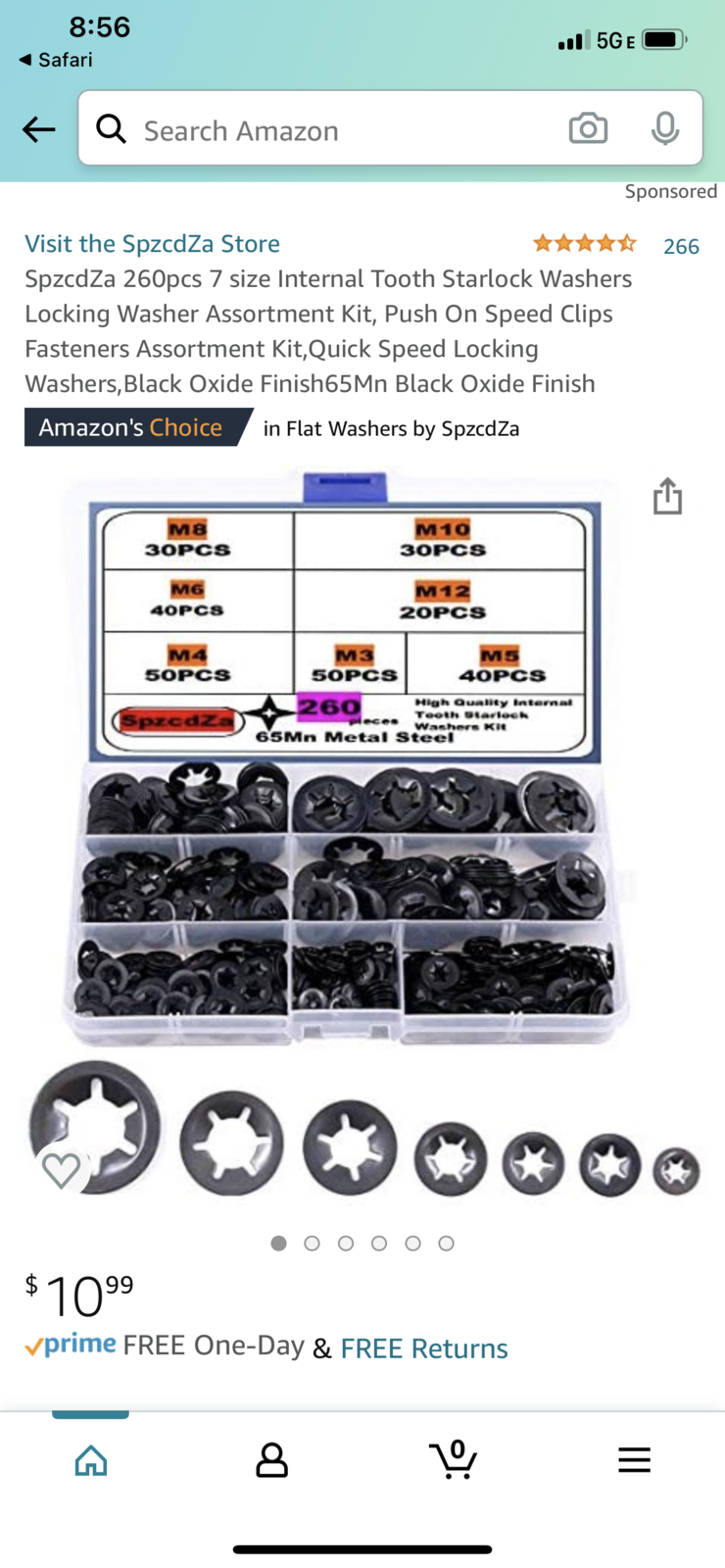

Here’s a set in Amazon
