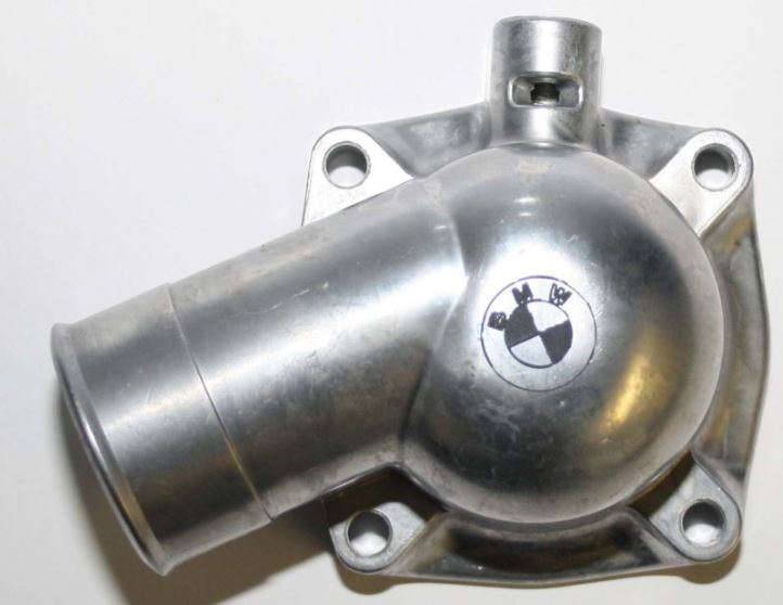

Maybe there is air inside the cooling/heating system and it needs bleeding? The air bleed you will find at the thermostat.
But note: you should lift the front of the car in order to bleed all remaining air from the heating system.

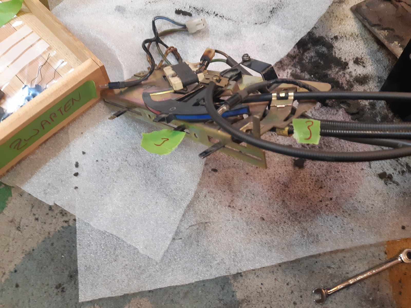

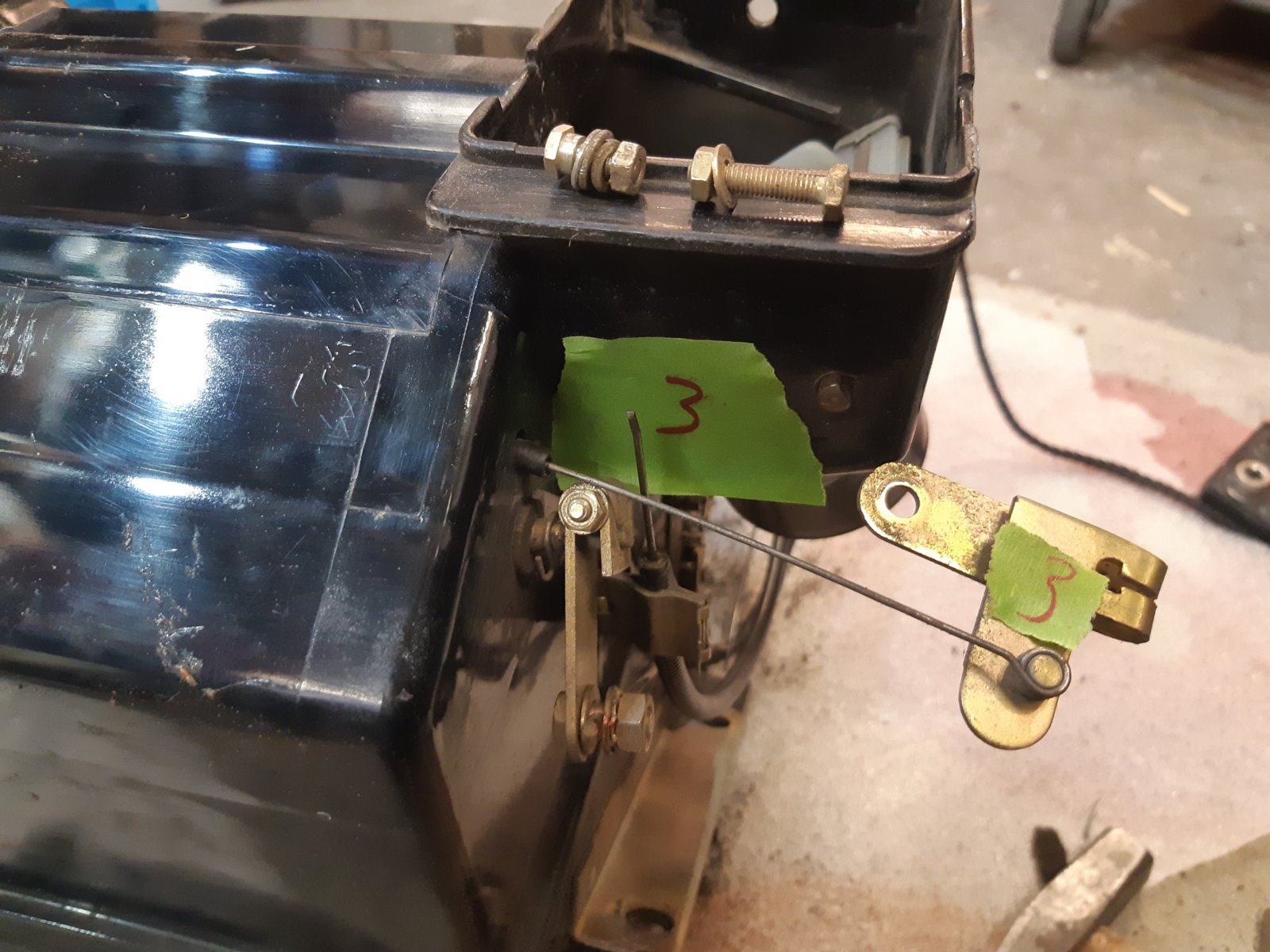

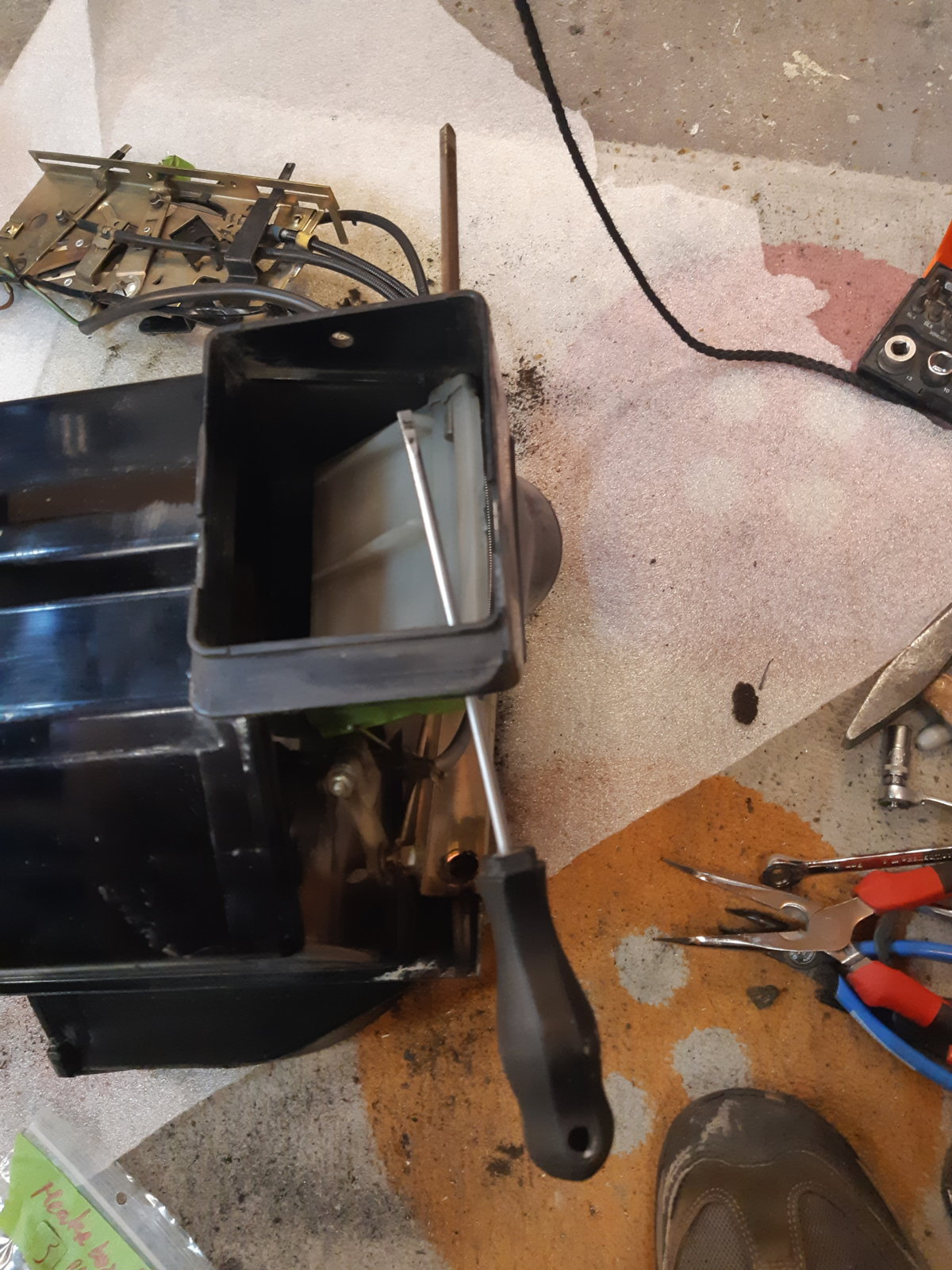

1b. Perhaps the attachments of the cables have loosened? check: Could it be that when you move the selector lever, the feet flap(s) aren't changing position and simply remain closed? You can stick your finger in the outlets from below, and feel if the flaps move when you operate the selector lever. The feet vents are each closed with a plastic flap, operated by the rigid bowden cables. Pls refer to the DIY on the heater box (https://e9coupe.com/forum/threads/diy-heater-unit-rebuild.38896/post-333882) with images and explanations of the system to identify the lever that you can check: Lever #3 is connected to wire #3, which in turn is connected to a wire passing from right to left through the bottom of the box.

some images of the routing of the bowden cables:
