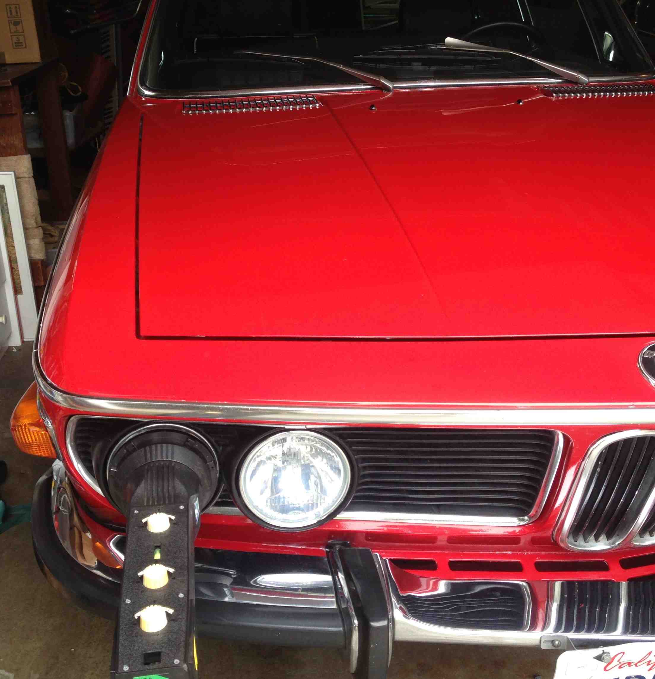

Just solved an annoying headlight mismatch problem, my headlight illumination was dominated by the driver side headlight.
Once I thought it was alignment of height and lateral pattern of the headlights, so Terri stoped by a while ago and used his magic gadget to geometrically align all four headlights. See picture.
