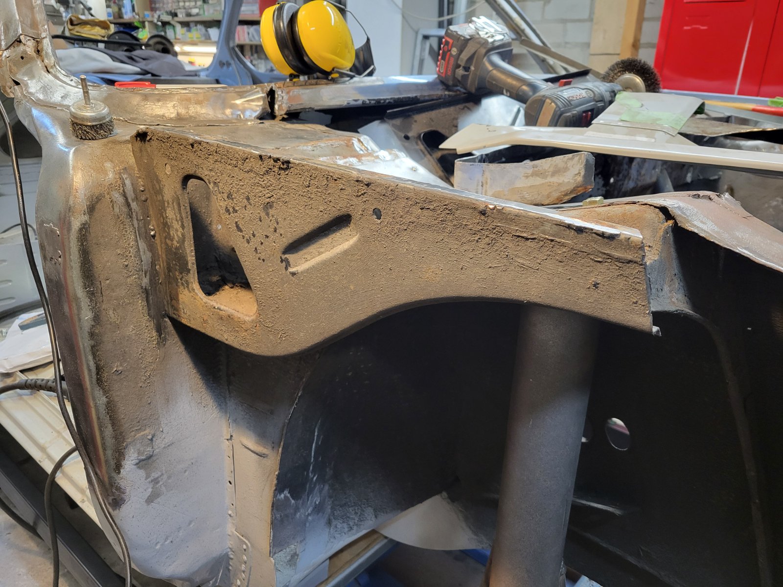

@eriknetherlands is doing extensive work on his car and one of the pictures in his string "fixing that little rust spot"is shown below. With the fender off you can see where dirt can accumulate and then hold moisture to accelerate the corrosion.

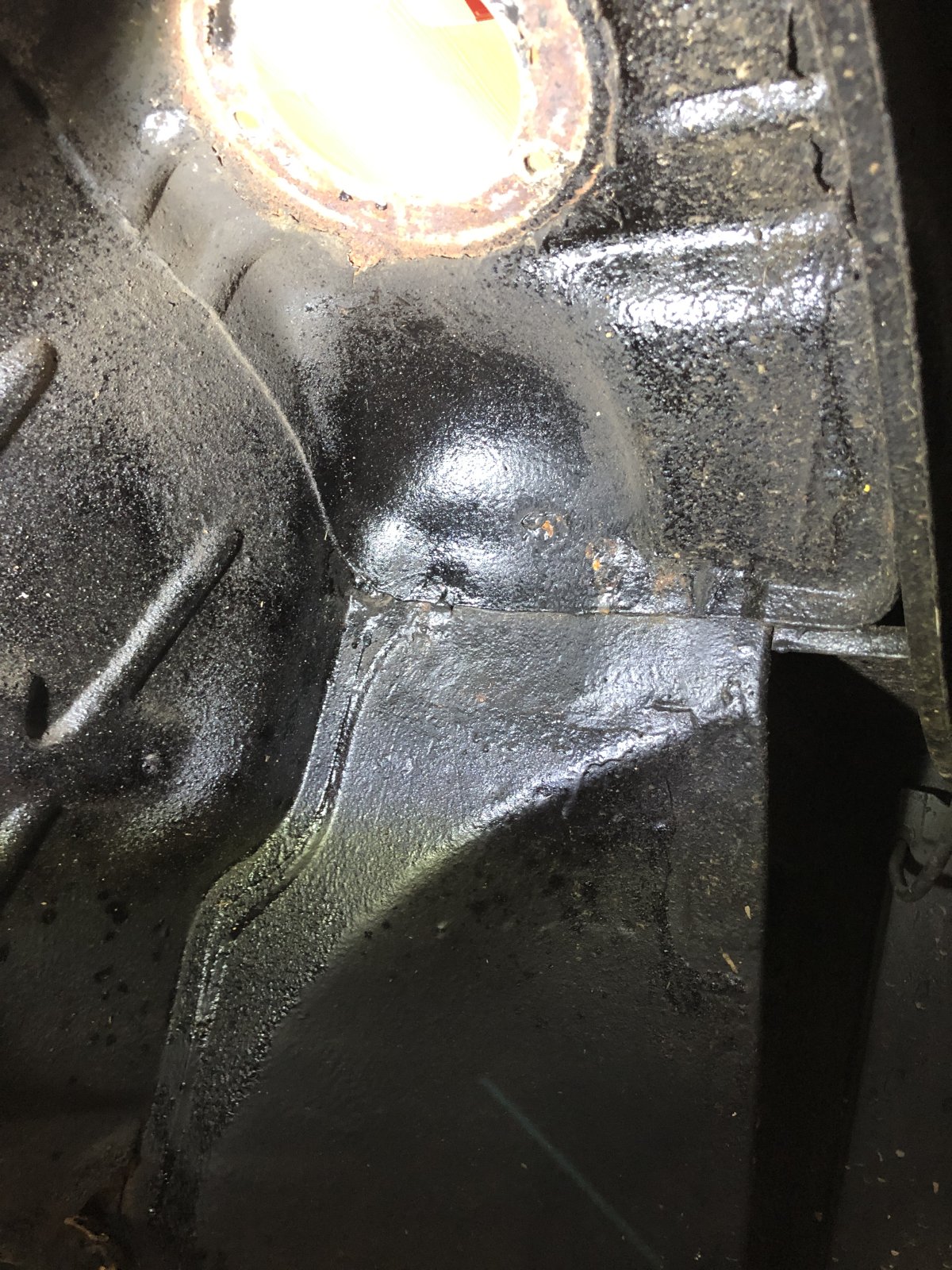

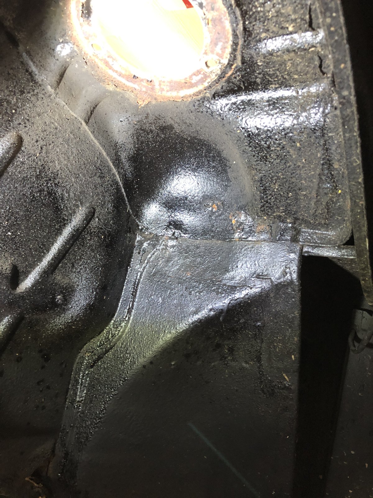

I found one of my pictures of the fender-well area taken during the dis-assembly stage for my recent engine compartment refresh. You can see the surface rust around the strut opening. That is the only area that you will not be able to gain access to without removing the strut. You can poke around the steel to the outside of these openings and see if you have any issues in the area under the sound deadening above.

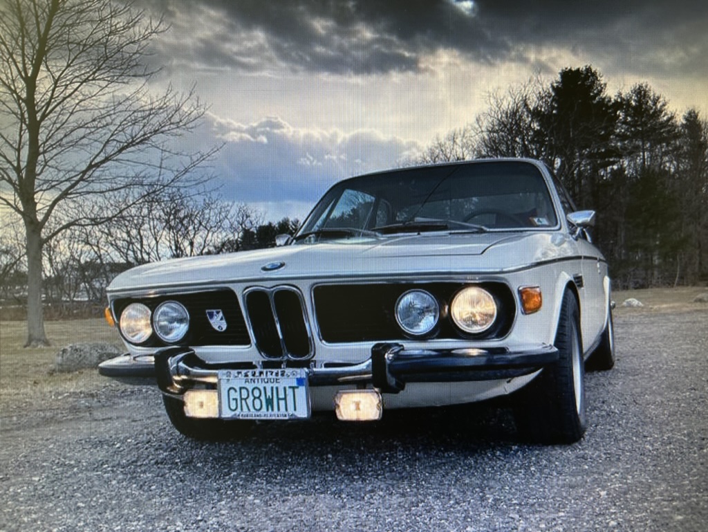

The Chamonix is a wonderful looking color especially under a cloudy sky!
Love the license plate! And yes I’ve noticed that it photographs best against a dark background. This is a shot of my (soon to be delivered) coupe from BAT taken two owners ago, and even though it’s old (the extra front marker lights are now removed) I think it’s my favorite in terms of showing off the lines and stance:
And @boonies thank you so much for finding all those pictures and the good advice. I’m feeling like if there are issues there I want to find and address them now rather than later. But alternatively I don’t want to destroy the car by looking too hard. I’ll take your advice with some probing around the strut attachments from above and below, and good to know that the panel is easy to unbolt and clean out!

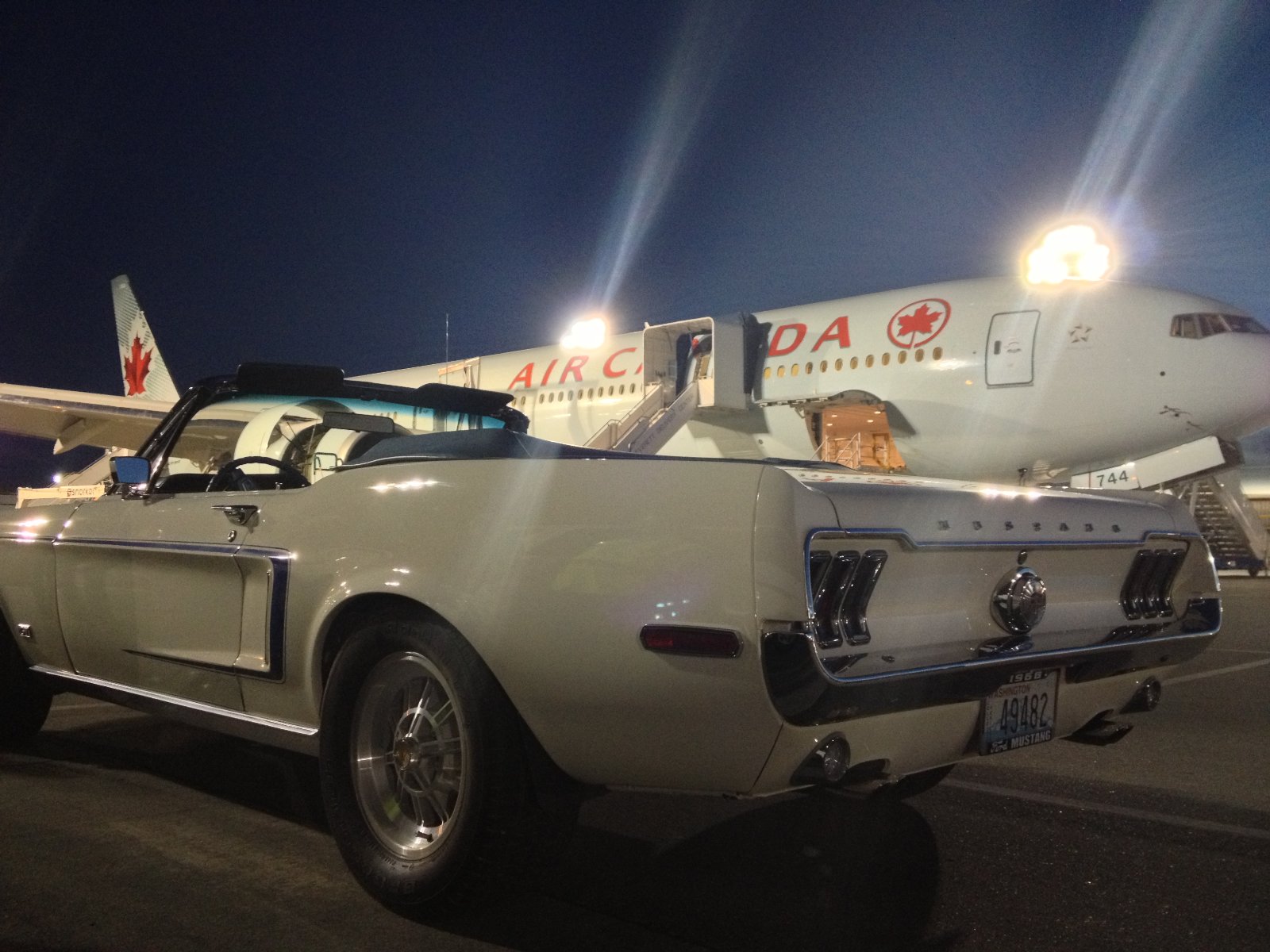

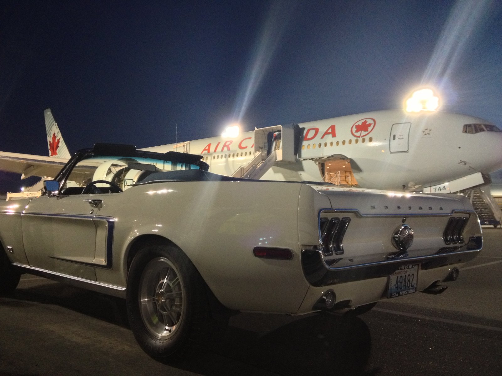

This is similar to what Wimbledon white is that Ford had in the 1960's... and the color my Mustang is.
It appears 'white' when you see it on its own. But when you have the car next to something white white - it really looks different.

Regarding rust, I haven't jacked it up and removed the wheels yet but I did poke around the strut mounts. There are a couple places where the sound deadening in the engine bay is cracked and coming off. Two of these had some small rust flakes coming from underneath, and I probed quite hard to see how deep the rust is. Forget the "screwdriver test", I used a needle-like pick and it is all solid metal underneath. So that is a relief.
I do wonder - has anybody found a way to seal this area without removing the sound deadening around the shock towers in the engine bay? I will obviously not let water seep into those cracks, but there is still some moisture in the air. I'm wondering if there is an oil product I can seep into those cracks periodically without hurting the appearance?
