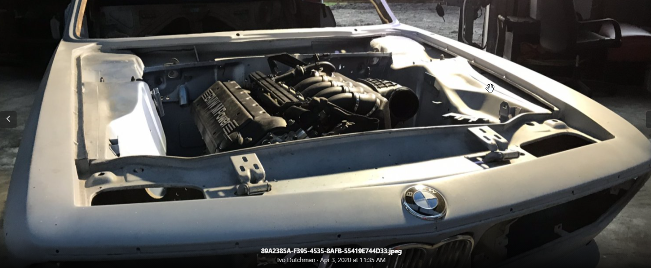

Thanks! some pictures while fitting the s50 engine :)

You’ll be the “flying” dutchman with that motor! (sorry, couldn’t resist)
Steve, you never can. Ivo, may I be bold enough to ask, will you paint your coupe Polaris silver to match your silver mane? Mine does at 78 years and counting. Steve
