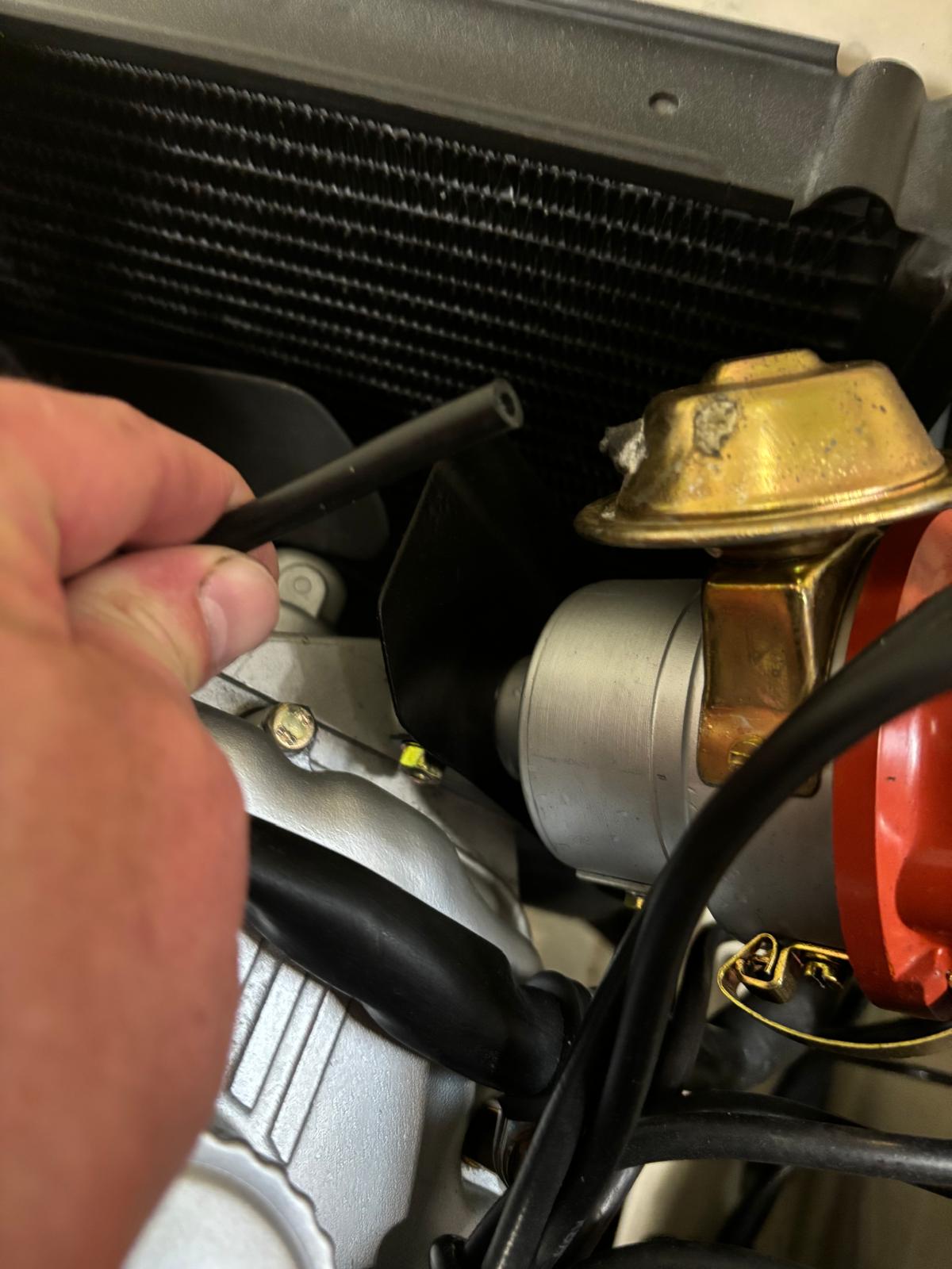

Hello all, new to group and just become the proud owner of a 72 CSL. Only had it a couple of weeks and it’s been running increasingly rough at low rpm since I got it. Just found the vacuum fitting pretty much corroded off which I think is quite probably the issue. Still finding my feet with suppliers etc. can anyone advise where to get a new unit please. Many thanks. Chris.

Rough at low rpm is not likely to be the vacuum lung
the part looks pretty bichromed and awfully welded
but I think is notthe issue here
that is advance I think not retard
yes simple effect
the distrib looks odd to me
is that a carb or injected engine ?
Start off by plugging off the vac line and see what happens. The vacuum pot on the distributor won't know the difference, but your engine will appreciate not sucking in air where it doesn't expect any.
From there - The story on distributors on these cars is a long tale. Hard to know if it is the original one or changed out later in life. There should be Bosch numbers stamped on the side of it .... that would help to know what it is and what parts (if any) are still available.

If you need a vacuum can it can only come from a Djet distributor.
The ridge on the distributor body doesn't ring any bells, but clockwise distributor and clockwise pull from the pod would mean vacuum retard.

The hose fitting had corroded off due to the bad plating, I think plating acid was left inside the unit. It’s pretty awful and needs replacing but I’ve managed to effect a temporary repair so it all works. Still runs crap though.

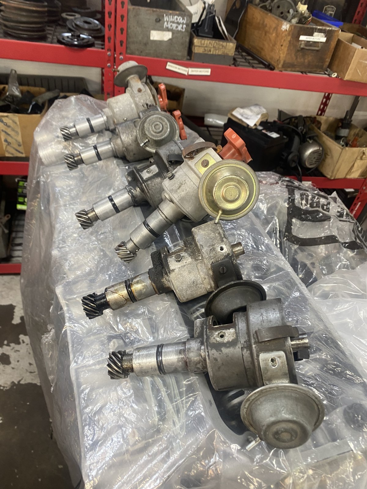

My shop does have an e9 forum lending library - borrower pays postage.
