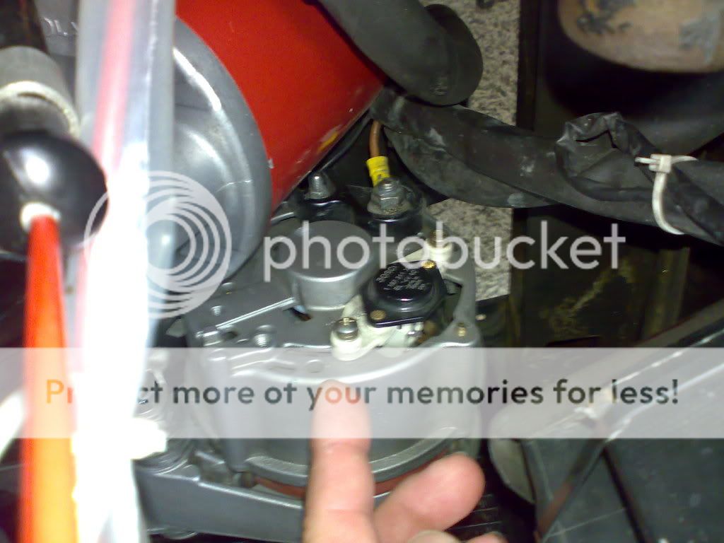

hi, my car came with a damaged alternator, so the original one was changed by the exact reference from bmw
but that new alternator came with a regulator incorporated, see this pic:
Esta imagen ha sido redimensionada. Haz click aquí para ver la imagen completa. El tamaño original es 1024x768 tamaño 140KB.

There´s no way you can run two regulators. You can leave the old one in for optical reasons, but it has to be disconnected.

Are you sure the original regulator - the one next to the battery - is really still connected? Who installed the new, internally-regulated alternator? Ask the installer how they wired things. We can't tell you how to change the wiring on your car, since some modifications have apparently been done, and we don't know what they are.
Is the charging system working? If so, then whoever installed the internally-regulated alternator must have made some wiring changes - as others have written, the system would be unlikely to function if both regulators were somehow competing with each-other.
There is no place to attach the two remaining wires from the old regulator to the new alternator, there were three originally held by a plastic plug on each end. There is only the blue idiot light wire from the old regulator and the larger red wire from the battery to the new alternator.

if you take a look to the pic i posted : you can see two cables, a brown one and a black one (probably not original, so the colours mean nothing)
and in this other pic of the alternator, you can see the third cable (that tiny black cable), that goes from the alternator to the engine (i suppose that is ground (-))
so i have three cables from-to the alternator
but i know only the ending point of one of them, the one that goes to the nut attached to the engine body, the other two (first pic) are heading the battery area, but i can not tell where precisely, i will check tomorrow
any ideas ?
Ignore ground wire for a moment (black but should be brown). You only have two wires so you are not using the original regulator. The cable to battery should be red but your appears to be brown, it is the thickest wire, 12 gauge at least. A smaller 16 gauge (marked D+) wire goes to your charging light in the dash, it might still run through old regulator but it will be blue as it heads towards dash.

I can´t really help you with the connections, especially since you´re wiring seems to be anything but stock by now, but running two regulators is a bad idea for "logical" reasons. They would both be trying to do the same thing: regulate the output of the alternator by regulating the ingoing feed. So their actions would overlap or even sometimes cancel each other and give you quite a complex oscillating circuit. No good could come of that. At the very best, if one had a stable lower threshold than the other, one of them would not do anything at all. But that´s not guaranteed. Especially as the one in the alternator is a new, electronic, transistor regulator and the external one is an older, probably non-transistor type.
But, I´m guessing: the external one is probably disconneted by now anyway. When you put in the new alternator, it simply didn´t have the connections for the old regulator, so the new alternator is probably only connected to the feed wire (runs through the idiot light (that´s acutally not only the idiot light, but also an important resistor in the feed)). See if can can find / read with a multimeter which of the three wires into the old regulator is still connected to anything.
If in doubt, just pull the plug from the old regulator and if the car still charges, just leave it off (or clean out the internals of the old regulator and plug the plug back in if you care for the optics)
