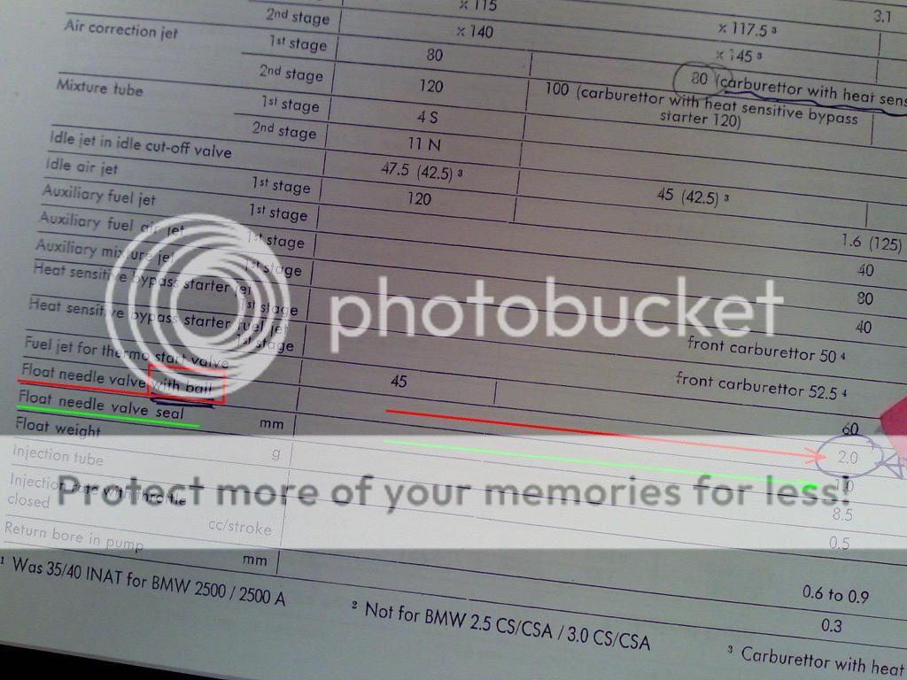

so i began questioning myself about this, and then i found this sentence in the blue manuals, chapter 13:
what do you understand here ?
float needle valve with ball--------2.0 ?? and no units, so what does this mean ? 2 valves ? one in each carb ? does this make sense ?
the next line says:
float needle valve seal mm ------ 1.0
any opinions ?
my question is that provided there are valves with or without ball, could it be possible that if the valve is without ball then you must install a 1mm seal, and if the valve has ball you should install a 2mm seal ?

The float valves
or inlet valves are of different lengths. Each type requires a corresponding gasket of differing thickness.

The seal
refers to a type of inlet valve not seen much anymore- viton. A black hard rubber substance. What is more prevelant now is the ball type and the solid pin. Preferably use the ball type as it seems to seal better.
The seal type was a bit longer and required the thinner gasket.
