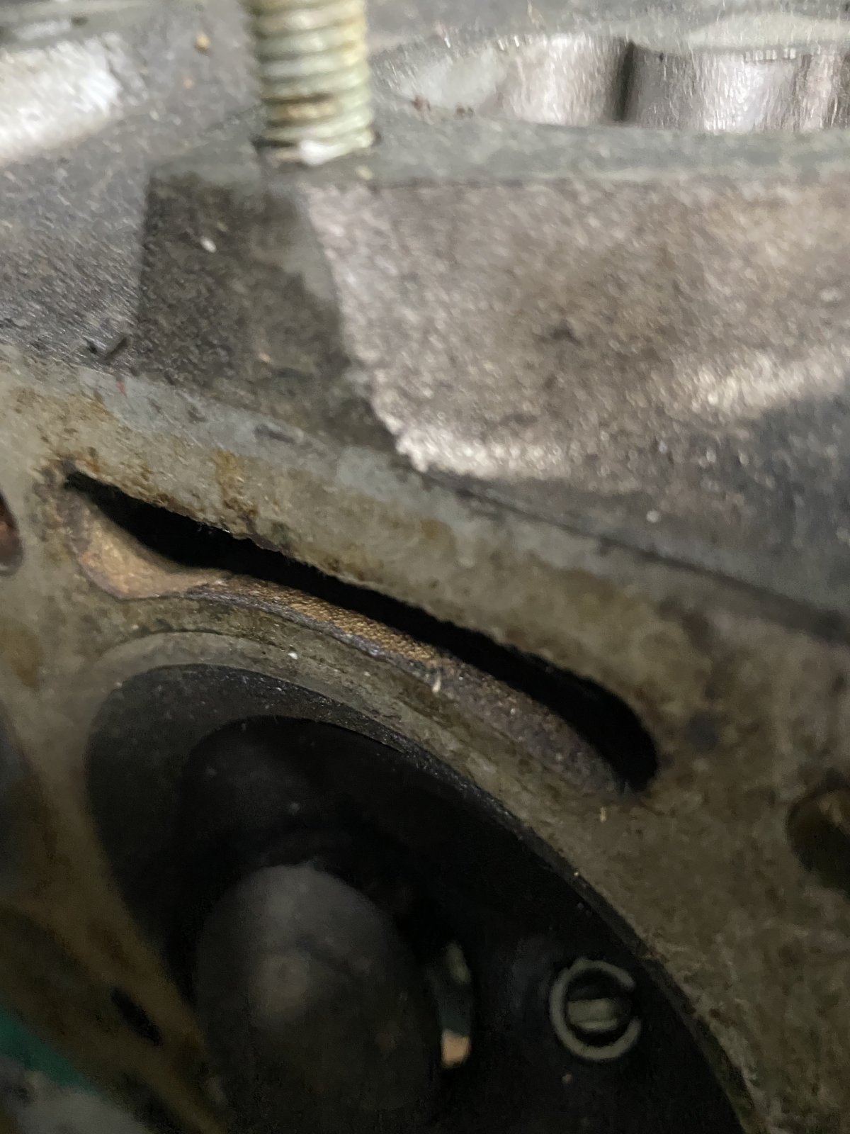

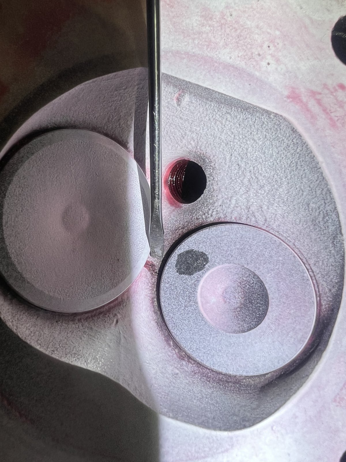

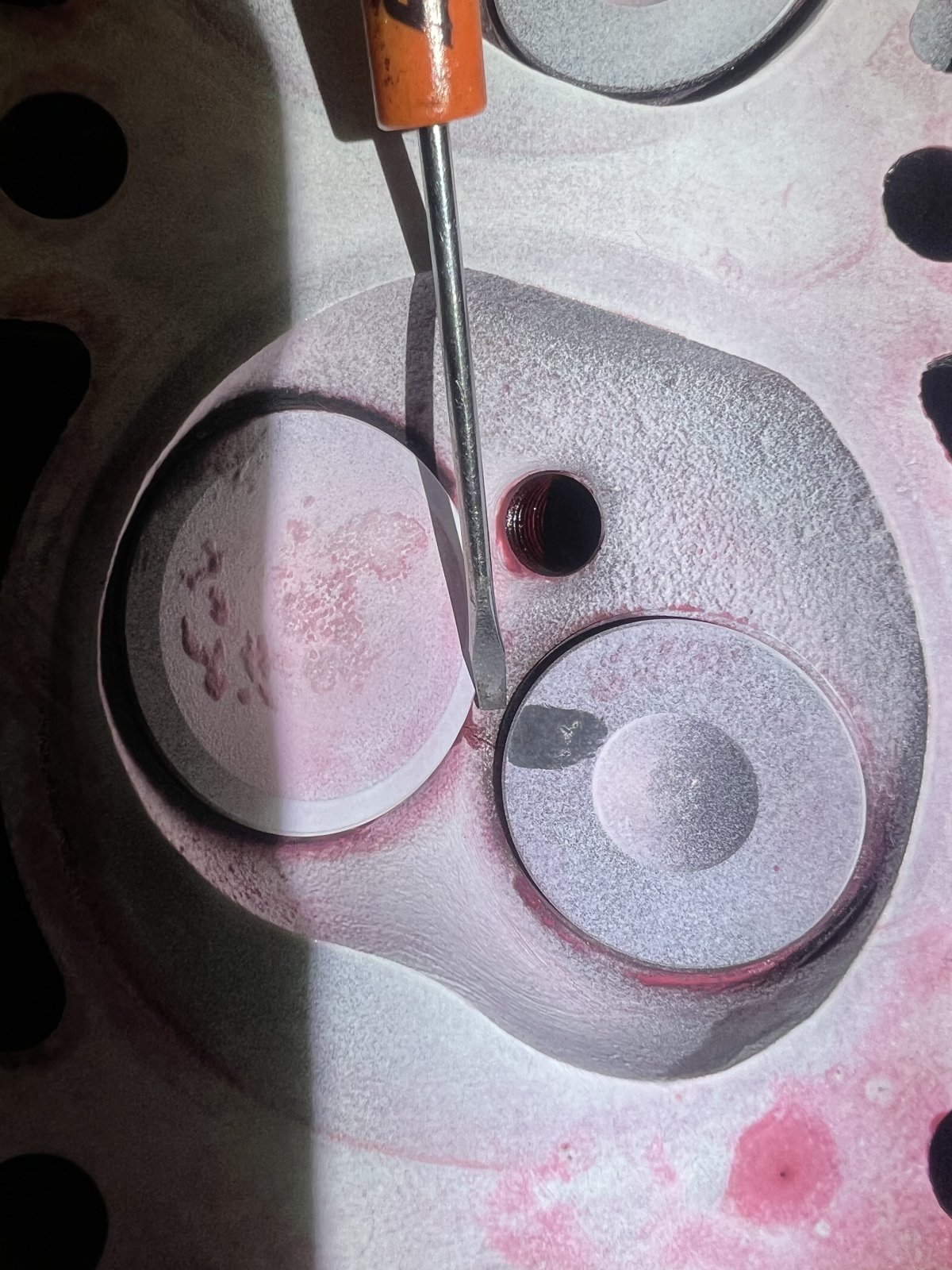

Fellow e9ers. I have an issue that requires forum expertise. I had my csi engine fully rebuilt in February of 22 and all systems fully gone through, the car was running very strong for a stock 4 speed with Stahl headers and a mild Schrick 282 cam. This particular problem began a few weeks ago after an enthusiastic 4 hour drive from Miami to Orlando. A few days later I developed a hard start condition with misfire that would disappear after about a minute then a week later noticed I was rapidly loosing coolant until smelling exhaust fumes in expansion tank. Didn’t take long to figure out I had a headache Tylenol doesn’t fix… I just pulled my head off and dye tested it to find these two cracks between my seats. Please see photos. I like that I have a numbers matching CSi but can this area be well repaired or am I better off getting another head and if so, which? I would think it’s been decked at least twice. Repair or replace…tough one, I love that it’s a very original matching numbers car. Help gratefully appreciated @deQuincey @sfdon. I’ll get one today if I have to, I can just as easily be reached on my mobile @ 305-495-1942. Cheers, Dan

Certain of the heads used on our cars were known to have this problem. The head on my car was replaced sometime prior to my ownership, and I presume this issue caused that replacement.
Fortunately, the heads are not numbers matched to the engine and/or to the car. And better yet, the later heads have better coolant passageways and are a known and preferred upgrade to the earlier heads. Do not repair your head. Seek out a head with a 1981 or later casting date on it and replace your head.

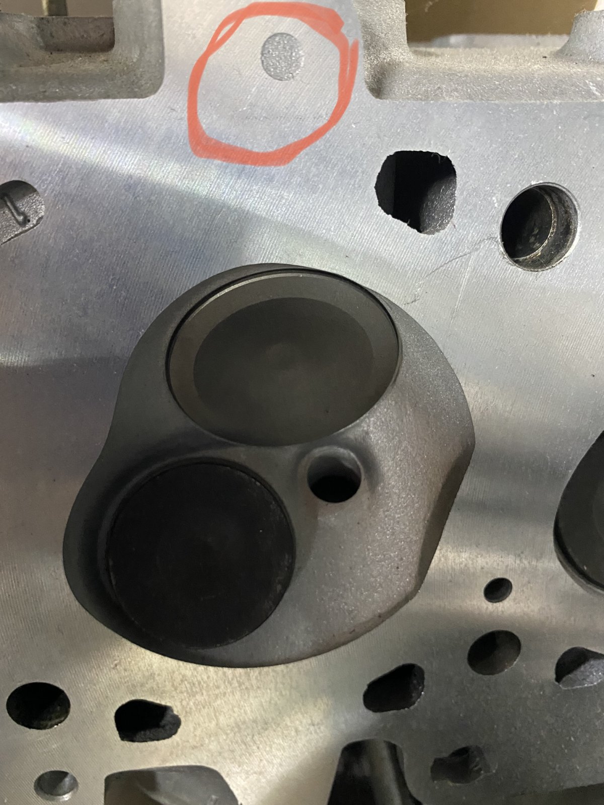

You want a fuel injected head with later coolant passages and NOT one that has already been machined past the recommended head height. You will determine the head height by seeing the dimples cast into the head.
