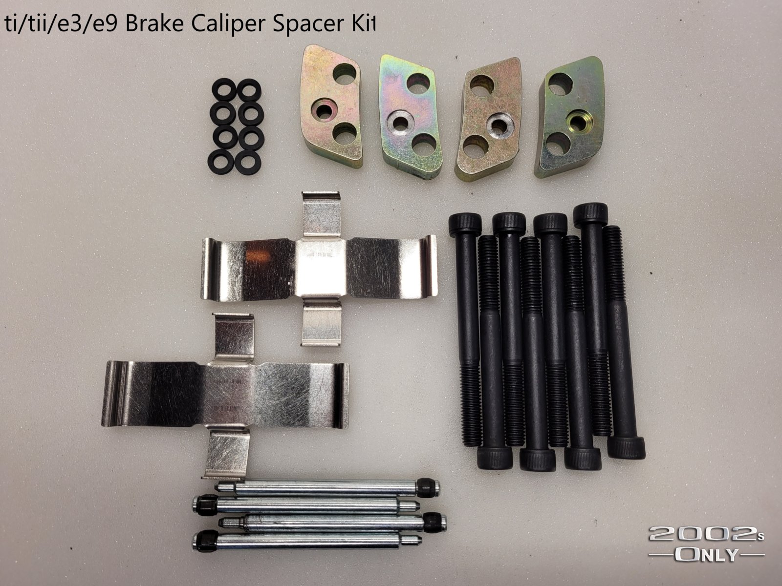

Thanks @teahead for the mention and sorry about that missing link however we haven't launched our online store yet but hope to do so before The Vintage. In the meantime, please contact me at [email protected]. The caliper spacer kits are $145 shipped in CONUS. Here is a pic of the kit. This kit works for either the early or late 6-cylinder calipers, those held together with bolts and nuts (early) and those held together with just bolts into threaded holes (late)

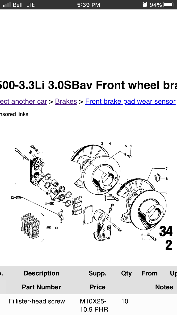

I’m a little confused. Would this work for the Bavaria? The front calipers are 4 cylinder type. And if so the kit would then accommodate a 3.0CS front vented rotor?
It seems I have caused some confusion with the "6 cylinder" reference. Should have said Big Six calipers perhaps. All of these calipers are the four-piston variety. (Never heard of the bores being called cylinders though.) The same calipers that were used on the early sixes (cylinders, that is) were also used on the 2002ti/tii/Turbo. The only difference in application was that some calipers were vented, i.e., used spacers, and some were not. So, yes, any early Big Six caliper can be turned into a vented caliper using these spacer kits. The same can be done with the calipers on the later six-cylinder BMWs though they used wider pads and were a heavier caliper.

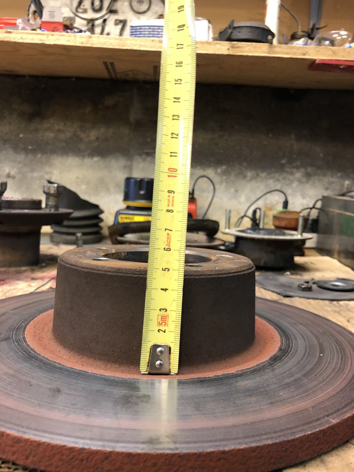

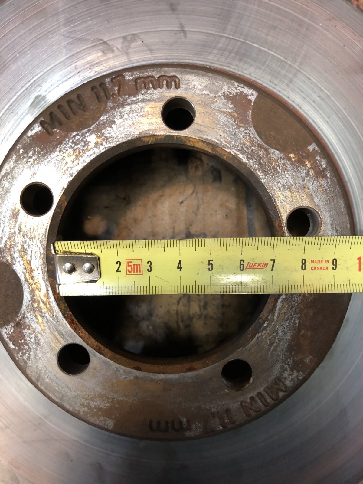

What rotor (year/model or PN) do you specify that works with your kit?
Good question. If I'm not mistaken, any vented rotor that was made for an early six should work with the spacer kit because they all used the same caliper with either vented or non-vented rotors. Basically, the spacers provide an added 10mm of width to the calipers to accomodate the vented rotors.
Any problems- let me know.
