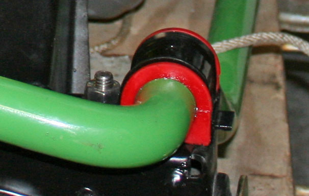

Front side
deQ - Mine came cut along the front side (at the 3 pm position in the photo). You can just make out a joint there - where the grease was squeezed out).
I also found that I had to loosen the 4 bolts (~10 to 15 mm) holding the engine carrier to the body rails to make the installation easier. The space there is a bit tight.

I misread your post and obviously thought you were referring to the front sway bar instead of the rear.
I haven't looked at the bushings on my cars recently, but I seem to recall an E3 that had "D" shaped bushings cut at the 3:00 O'clock position. http://forums.bimmerforums.com/forum/showthread.php?t=668706
Notice, however, some bushings for other makes and models are split elsewhere. I would agree that the cut portion should be located at an area that sees the least compression or contortion. Since the bracket and the subframe encircle the entire bushing, except for a corner, it is probably not critical where the cut is located. Once a bushing becomes sloppy and loses its shape, then the cut area might become an issue, but they generally have a long trouble-free life span.

hi, thank you both
so yes i will make a longitudinal cut to introduce them !
first explanation, i was talking about the rear stabilizer, and probably that was a little confusing
but the situation is exactly the same, it is impossible to introduce the rubber silentblock from the bar end, i greased it and even warmed it up with an air gun, no way !
i was thinking about making the long cut but i was afraid of destroying the effect, now i know it is the only solution
thanks for positioning the cut at 3o'clock, that is important too !
regards
deQ - I found my old sway bar hanging on the garage wall. The bushing is cut on the opposite side. So.... I am not so sure which side the cut should go on. Perhaps it makes no difference, or you can reverse it and try both ways. Good luck.
i found a manual that, for the front bar says,: the slotted end of the rubber mount faces REAR !, but this depends on the position of the bar, in the mentioned case the pic showed that the bar also faces rear
my opinion is that when the bar works there is also a horizontal force in the support that we should avoid impacting on the slotted side of the rubber bushing, so in my opinion the slotted side must always face the bar ends
(by the way, that is exactly the case presented in your old bar)
