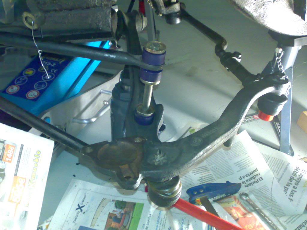

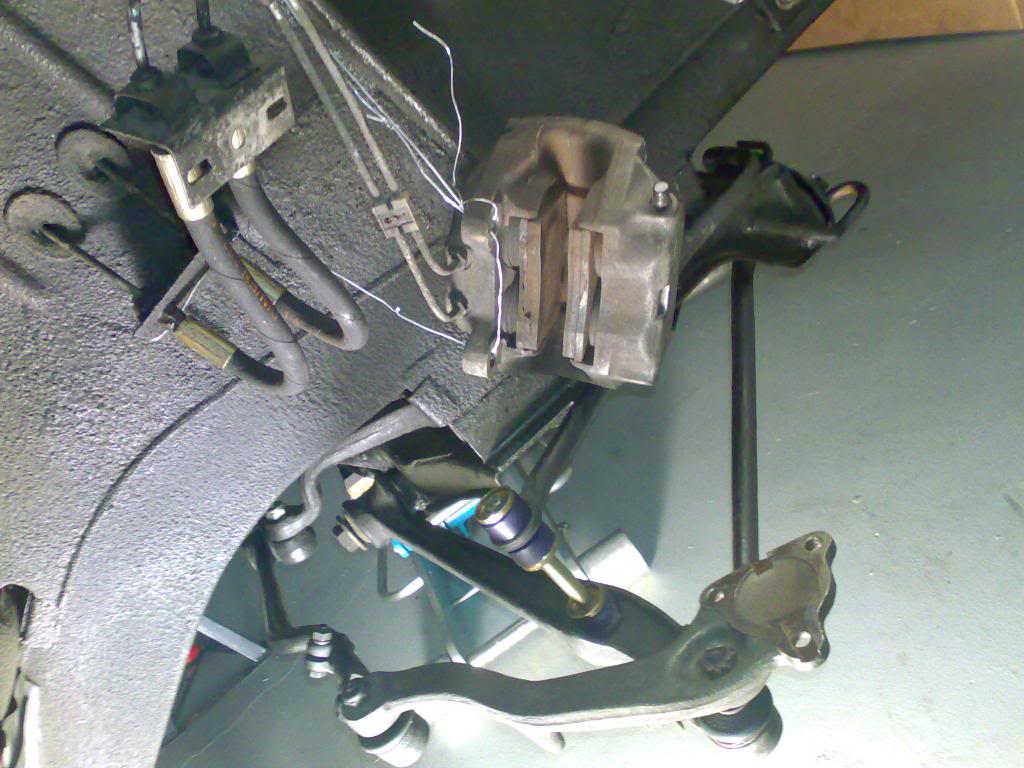

this is the area
the wishbone is the piece that holds the antisway bar in its middle
this pictures are from the time i change the shocks, but i do not intend to go so far this time to change the wishbones if it is not absolutely necessary

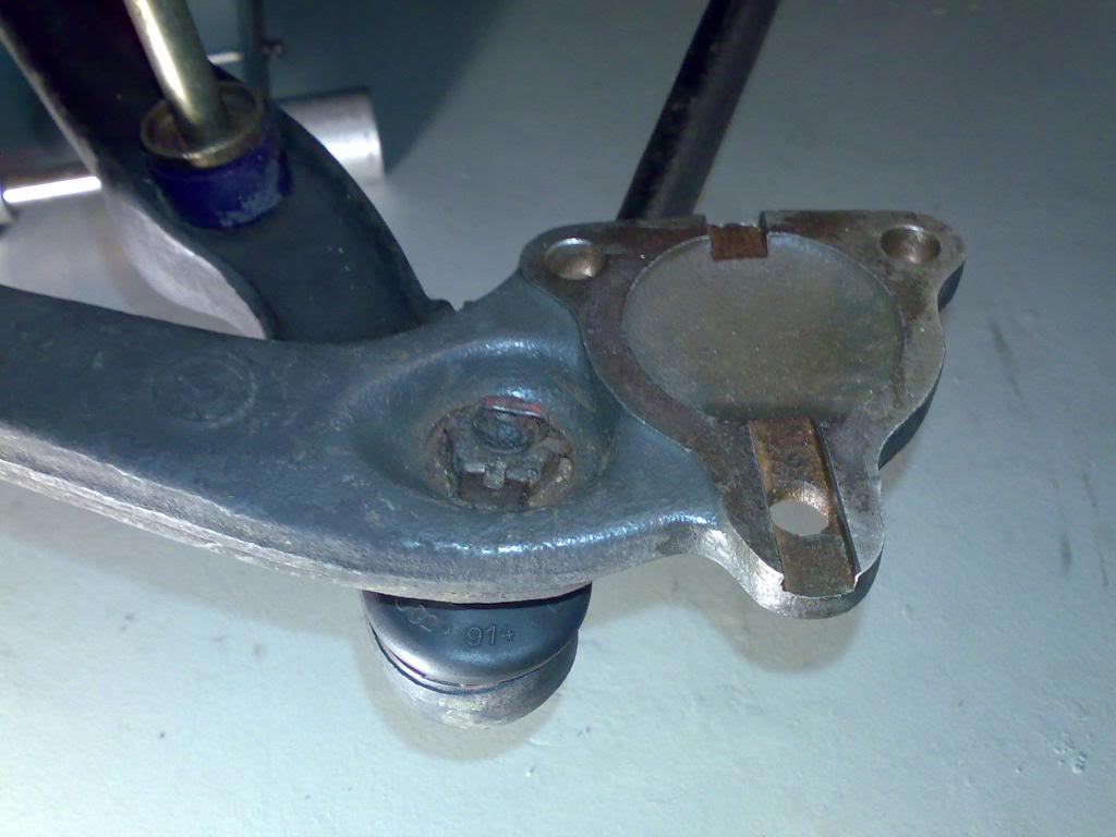

this castle nut is not exactly clean, we will see,...
this is a wishbone
i recently did it on the blue coupe both sides .... no need to demount the strut/spring . The castle nut can be reached with a 19 mm angled wrench , not a socket. Just a bit difficult. Getting it loose is ofcourse the main task.... The new one goes alot better :)
The big bolts chassis and tie rod are no problem, just have a big wrench ! my impact wrench was also to weak...
i removed the ball joints with a V shaped rod and big hammer.... you may damage them , they are for the trash bin....

i plan to leave some spray oil on the nut taking advantage of the cup-shape of the adjacent element, good to know i do not have to dismount the strut, i hope the copper grease that i left over them when i did the springs/and so on would have been a positive influence
big wrench or a large bar maybe, or maybe both, yes
worried about the removal of the ball joints, yes, not a fan of using big hammers, i think i will try to apply some heat on that ball joint too :-)
