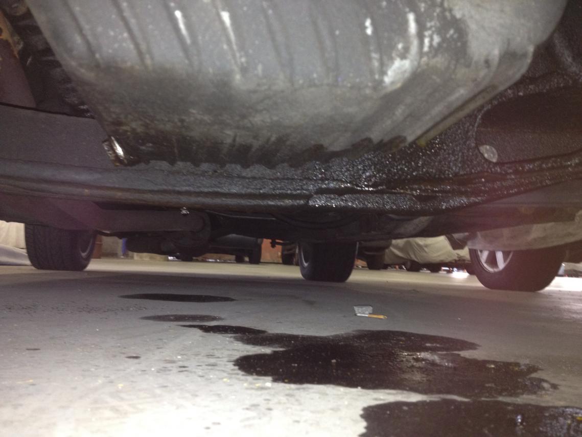

I need someone to take a look at what might be a gas leak or what I fear may be a cracked head. Simply put - I don't really know. I had the car serviced (all fluids changed, etc.) and a new thermostat installed. According to the garage they thought the existing thermostat was bunk even though it had been replaced just over a year ago with perfection (hole drilled - right temperature). They installed a warm weather product. The care ran well for the first drive (about two hours). The second time I drove it (I always warm it correctly) the "incident" occured.
After shutting it off for a few minutes and then starting it up I drove off a bit sooner than I would have normally (even though the engine was warmed up correctly) and it began to sputter, idle dropped pretty significantly and I drove it right back to the garage. Smoke was coming out of the back but since I'm color blind I can't really tell if it's blue or white or grey.
A small puddle exists beneath the engine and from what I can gather it's gas. I've gotten that far. I attempted to start it and try running it again (not driving) and thought it was better to NOT attempt that again versus have someone take a look. Attached is the best photo I could take of under the car.

Color blind ok but if your nose works, the fluid is either gas or it is not.
Running the fuel line is simple on these cars. From the tank a short cloth line in the trunk then steel. The line should run left across the rear drivetrain and then behind the rocker panel lip on the driver's side and to the drivers wheel well. It dives up as a cloth/rubber line, across the firewall and then to the filter etc.
Check the course and see if it's wet. You may have to crank the engine a bit to get the gas going. Most probable is one of the cloth/rubber lines and the abrupt weather change.
When you saw the smoke, was it coming out the tail pipe or did you see it in the rear view mirror as you were driving back to the garage? If the latter, then that could be some fluid (coolant turning to steam) in the engine bay wafting back under the car and visible behind you.
Does the leak under the car smell strongly of gas? If not, then it probably is something else. It almost sounds like you could have two things going on. Gas leak and coolant leak. If a gas leak were to cause smoke then there would be fire.
I would play if safe and replace the fuel hoses and clamps first. With the engine cold check everywhere for leaks. Coolant ones are usually easier to find because of the green droplets). Since your engine was not fully warmed up when you experienced the problems check around the exhaust manifolds first - they get hot fast and will smoke if oil of coolant drip on them. If you cannot find anything obvious then clean old drippings and crud off as best you can with papertowels. Put a sheet of cardboard under the engine bay. Try starting up the car again with the hood open (and fire extinguisher handy) and watch for leaks, smells, and smoke/steam.

Bottom line is you have an early head with a bad valve/cam and 10 rotten pieces of fuel line.
You need to remove your fuel rail and replace all the hoses to the injectors and fuel rail.
