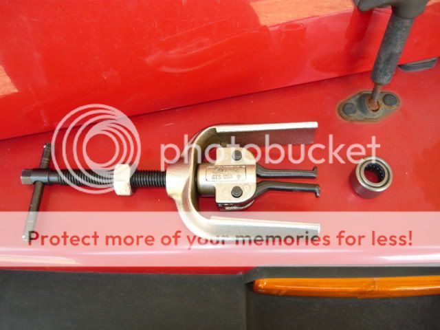

I used this, truly a piece of junk, I am not sure the 3 arm puller fits inside the bearing, I was on my last hook piece before it finally popped out:

Several tools exist for the specific purpose of extracting pilot bearings. Nothing against using the grease method - except a misplaced mallet blow. Same with slide hammer, except for situations involving restricted access. Mentioned in earlier post was the HF tool, of which I have only seen the picture and can't attest to its strength or size. When I could locate it, I have used a similar two jaw forged design.
http://www.harborfreight.com/3-jaw-pilot-bearing-puller-4876.html
223932118p
