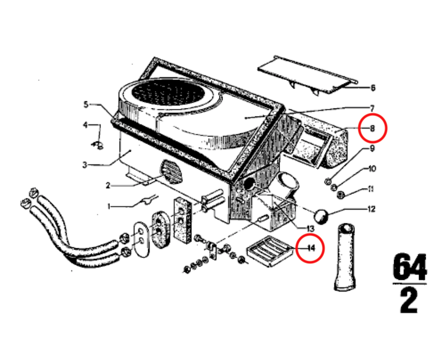

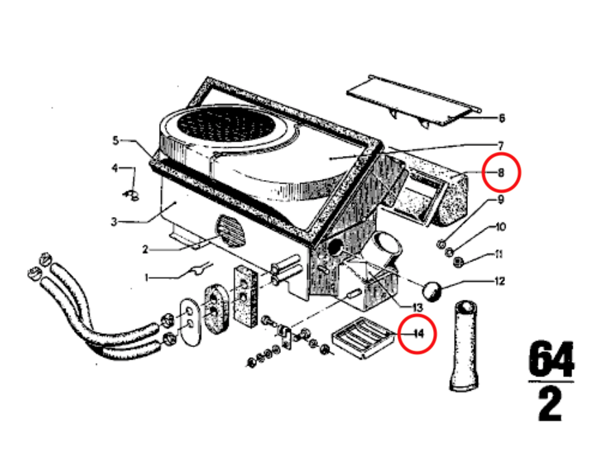

Hi guy. Im look the following parts to complete the heater box restoration.
Thanks in advance.
Alvaro
Pda. I use some photos of the DIY - Heater Unit rebuild.

Wrt to number 14, the metal grille; I think our cars had only one installed on the passenger side. This is confirmed by the parts books, as they give "1" as the corresponding usage.
When I disassembled mine, I noticed that the drivers side foot opening also has provisions to accept one, so I (incorrectly) assumed it needed one.
Just one is needed to be correct
A second one would on the drivers side would perhaps help to spread the hot air a bit, as during a long winter drive I sometimes felt like I was roasting my leg as the flow of air is quite concentrated.

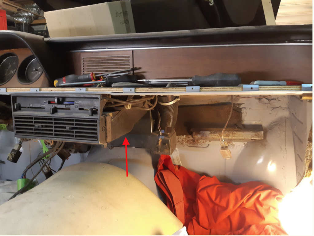

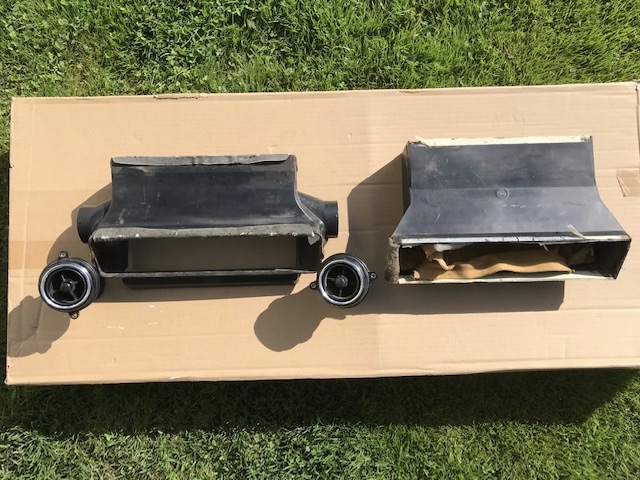

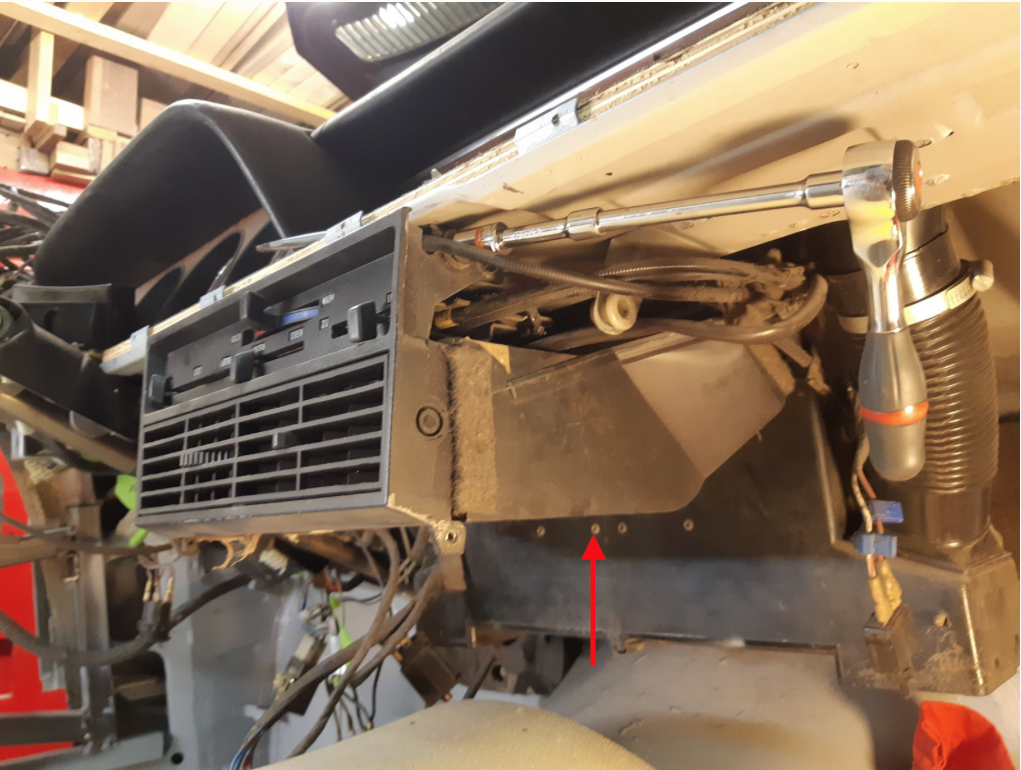

So, I located the vent that I believe you are looking for Alvaro. (on the right in the photo). I also found an E3 one, that sits upon the a/c evaporator, and has the outlet for sending cooled air out to small round vents at the end of the dashboard. See photo. I have thought about integrating this style of "intermediate piece" in my E9 to share cooled air somewhere else under the dash.
